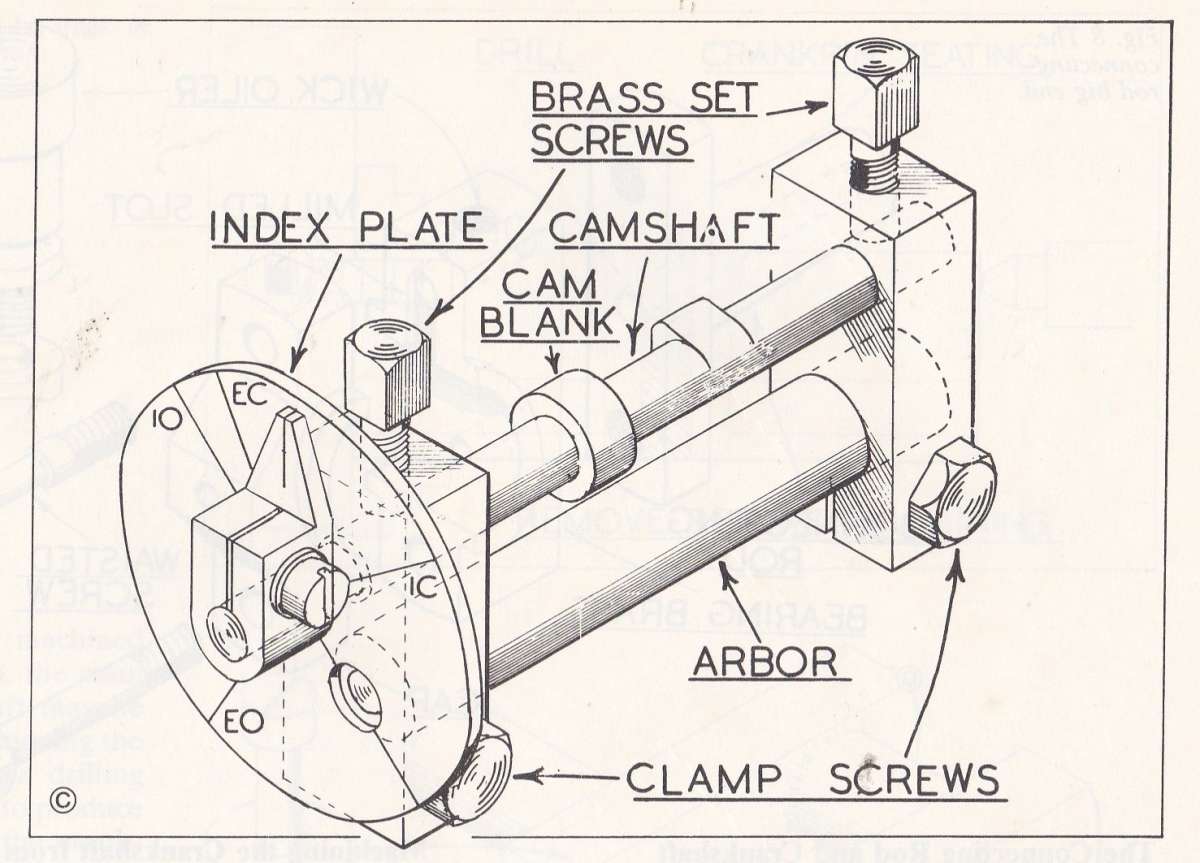

          Look up Westbury cam turning jigs or any westbury ic books usually have pics of them

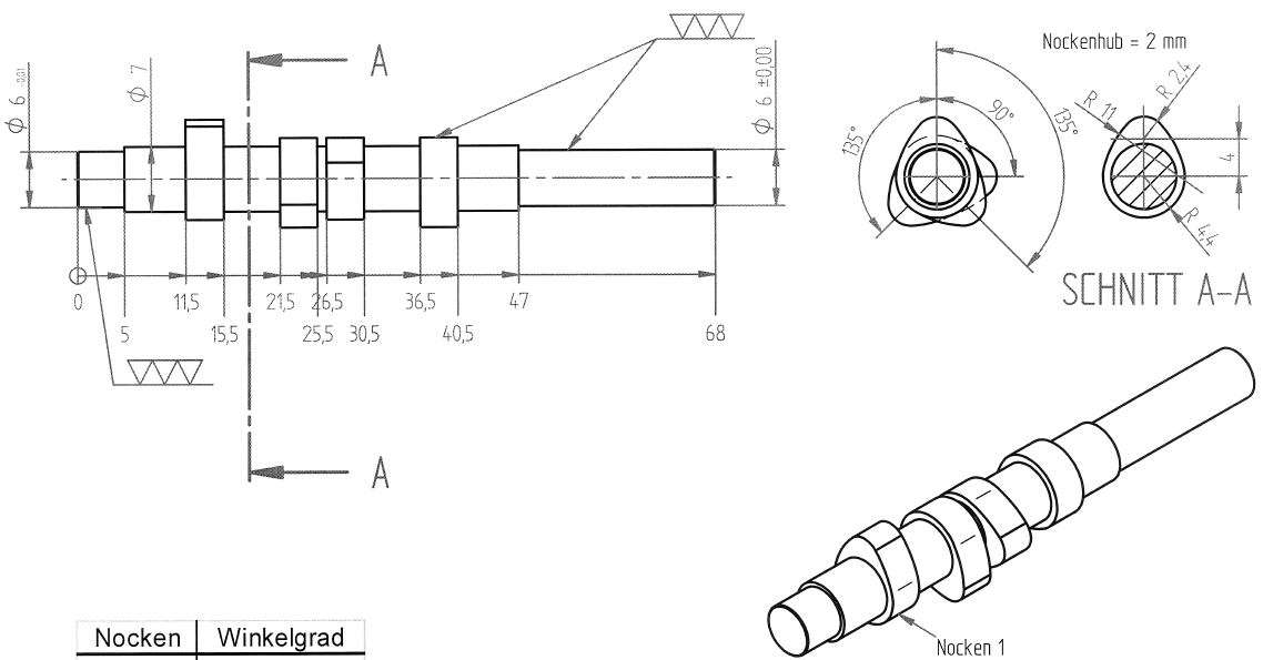

            I understand from Cedric is it one of the Jung 2-cyl engine which have radius flanked cams. Similar to this but larger with a 30mm radius to the flank

            So one option would be the Westbury jig that allows the embryo camshaft to be swung at that radius in the lathe.
            However if you are like me and don’t make a lot of tooling there are a couple of other options particularly as it is a relatively short distance between the cams. Westbury wa swriting at a time when few hobby users had a mill so aimed his writing at those using lathes but we have moved on since then

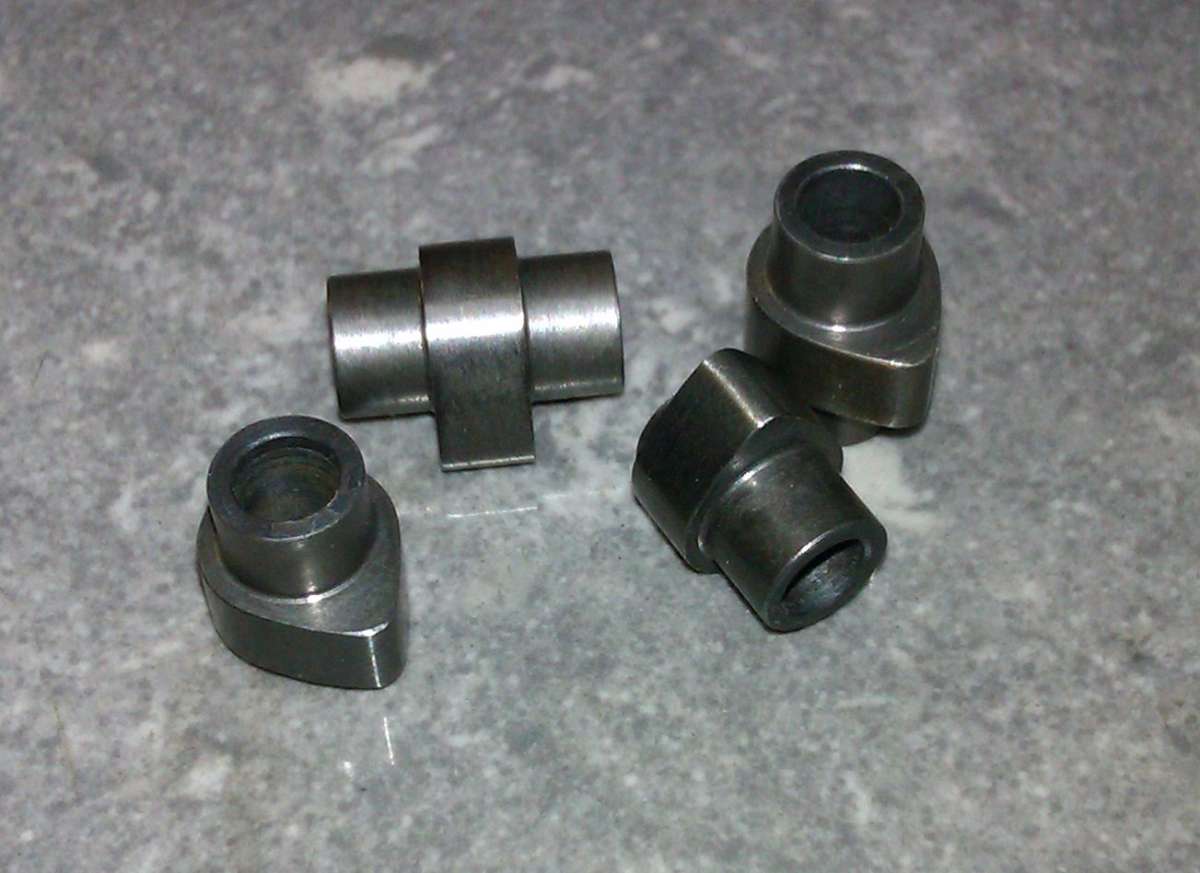

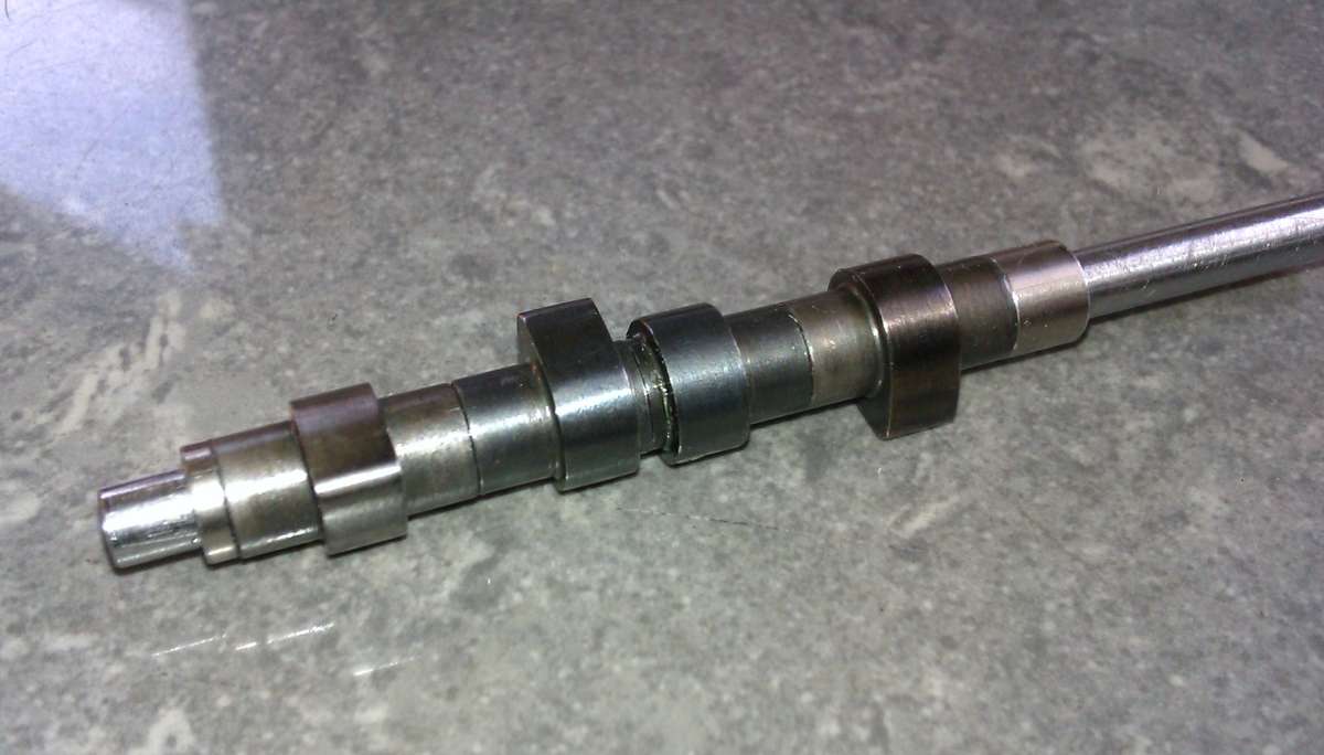

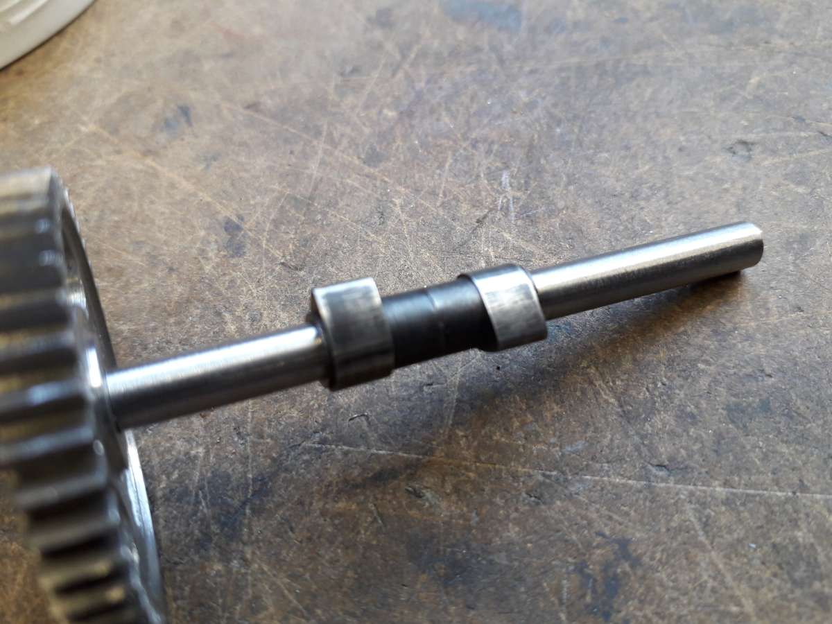

            You could also consider a built up camshaft with separat ecams bonded to a 6mm silver steel shaft which eliminates any risk of teh shaft distorting when you harden it. Plenty of Bobcats, Jaguars, Pumas and Oscellot engines base don teh Malcom Stride design running with this built up method
            IMAG3019
            IMAG3022
            20190921_153935
            Thes edays I just whack them out on the CNC but the two method sI have shown work well and don’t need much that a reasonably well equiped workshop will have.

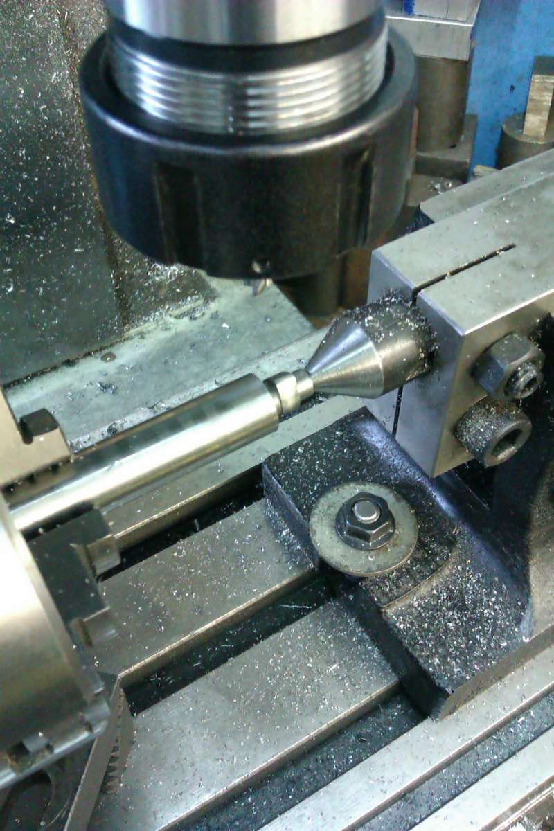

                            Thank you for all the help. this was a trial run using ally.
                            Trial Cam
