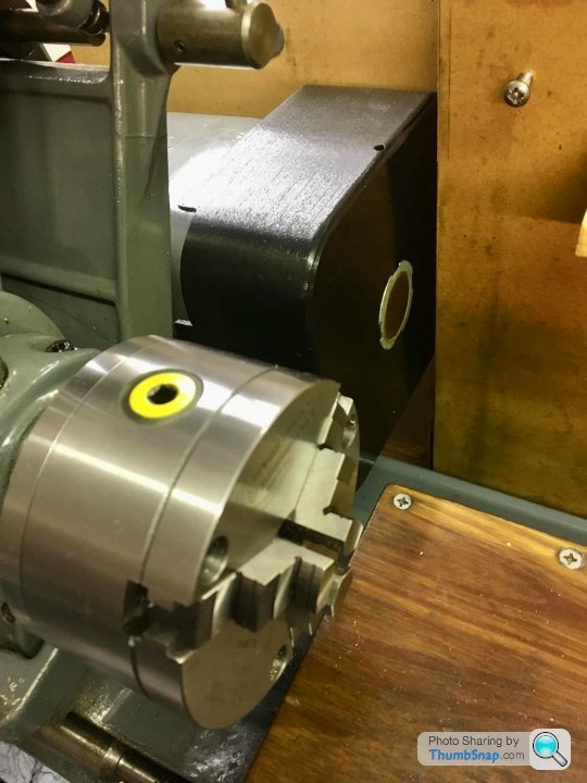

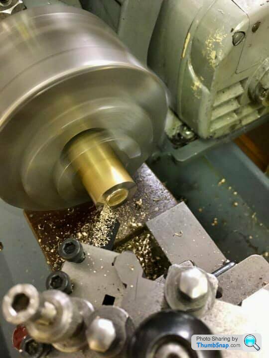

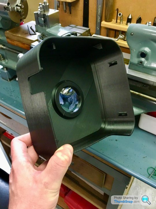

      Got fed up of cleaning the back of the motor of iron and brass dust, and oil from the bearing. So I made an easy to clean 3D printed cover that presses on to the bearing housing. It’s got a small clamp screw for good measure. Plenty of room around the sides for cooling air too. Sprayed with Black Smoothrite to protect the plastic. Result. Could really do with a new motor I guess.

            Thanks Howard – yes, I kept getting the acrid "electrical" smells, and last year the centrifugal switch wouldn't switch off – it was coated in machining crud. Worked fine once stripped and cleaned. I got the idea from Sparrey's "A man and his lathe" book, which has all sorts of ML7 modifications listed. One is a tin motor cover, which he made for the reasons listed above. I just updated it a bit. There is plenty of room all around, as well as some stand-offs to make sure the sides can't get squashed in:
