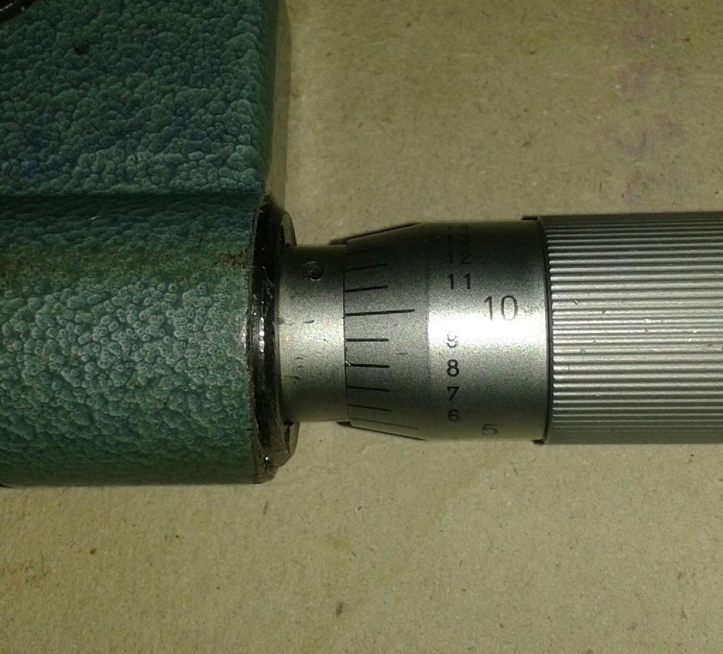

      I have a mitutoyo 293-766-10 micrometer it came with the Myford S7 I purchased some months back, it got a slight problem when closing the mic with the ratchet it stops just short of zero 0.0050 it can be zeroed if you grip the barrel and apply a little pressure ! Is it possible to overcome this problem in anyway ? would appreciate help/advice please.

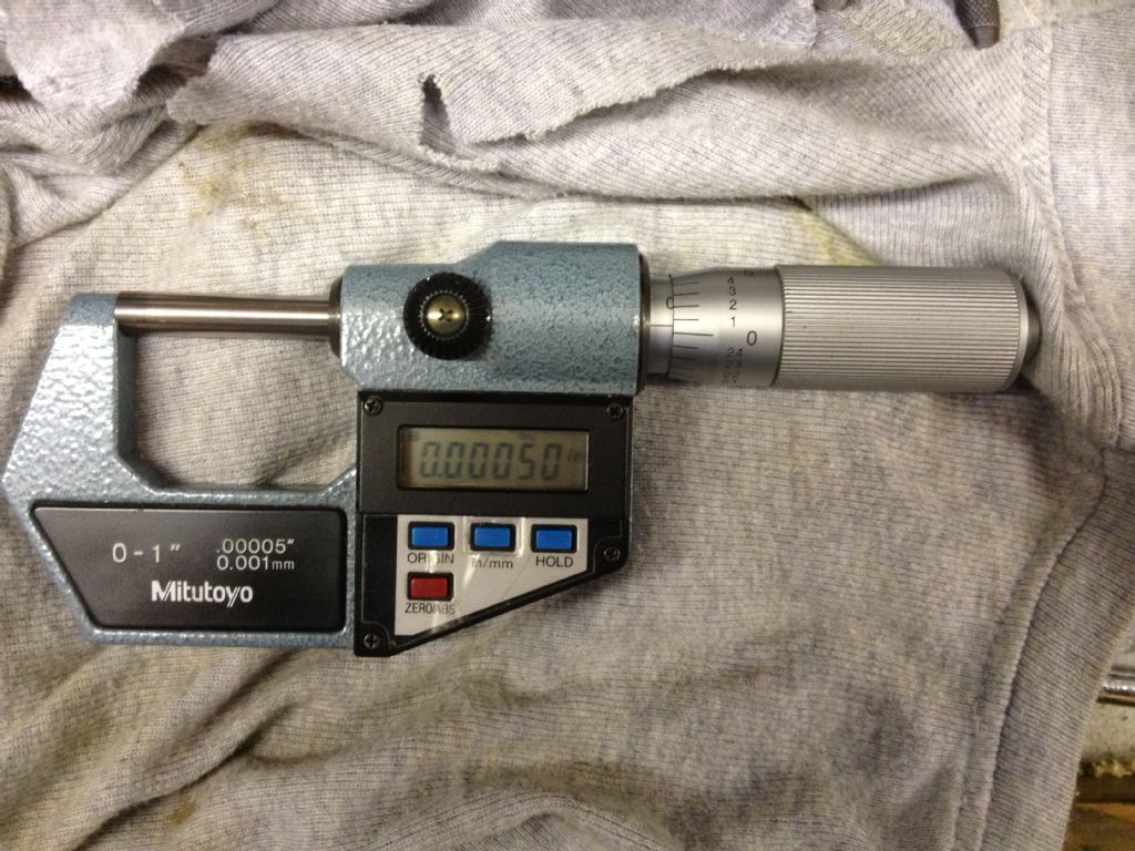

                Here is a photo of the problem

                  Is there not a small hole in the inner cylinder (The part with the horizontal line that you read off the numbers on the thimble against.) close to the body of the micrometer to engage with a "C" spanner which would allow you to rotate this cylinder by the half thou the reading is out on the analogue part of the display. The digital reading can be set to zero with the zero button. All the micrometers I have seen have this adjustment.
                  Les.
                  #159551
                  jason udall
                    @jasonudall57142
                    As said..zero the digital display with the zero button
                    Rotate the sleave with little c wrench ( hopefully with the mic’s case) to line up the zero line and tick with the zero on the thimble ( rotating bit)…
                    Can be a bit fiddly but there you go..The hardest part would be wriggling the sleave to show the zero tick mark..currently from photo.. under thimble again use c wrench supplied…
                    One thought..” analogue” and digital display currently read the same…is there some thing ( burr?) That is say 0.0005 “..on the jaws?

                        I don't have a 'C' spanner and there doesn't seem anywhere to use one ! if you look where the barrel goers into the body you can just about see three very small Phillips screws what they do at this point I do not know, have checked the end of the jaws and they are fine no light can be seen between them., also as I said earlier if I grip the thimble and apply a little force I can zero the mic but when using the ratchet it stops as shown.

                            I have the same micrometer as my master & have just been & checked mine… it read 0.00001" out of the box, &, as I normally do when I'm done with it, clean anvils with a wipe then I place a piece of clean A4 writing paper between the anvils closed them together until the ratchet clicks then gently pull the paper with a swivelling motion back out of the jaws & checked the readings again .. 0.00000".
                            Mine has the 'C' spanner & you adjust the thimble by the small hole in the barrel at the back, don't touch the 3 small screws otherwise you may well alter the electronics inside! At the end of the day does 1/2 thou' really matter for what you/we need? just zero your mic when you start measuring, also don't forget that readings will alter as the temperature in your workspace alters so keep your mic in a constant temp' either in the box at room temp, or if you sometimes, like me, keep it in your workshop top coat pocket (?) & let it acclimatise to your body temp.
                            These type of instruments (top quality ones) are calibrated in a constant of approx' 20*C at the manufacturers, digital & analogue types, just remember to zero it on your final measurement, 1/2 a thou' doesn't worry me in the scheme of things when you consider all the anomalies that occur when making a models, just enjoy.

                              Ok.
                              I use that model for around ten years 8-10 hrs a day 5 or so dimensions a part 20 parts an hour ( samples)
                              At the start of a shift you check zero and a nominial diameter…gauge bar…
                              If zero ( analogue scale ) ok then the notional 10.000 mm check bar. ( we used round “plug” gauges….this latter to confirm accuracy at the size being measured not just at zero..
                              We check the analogue reading as a test /confidence in the health of the instument…
                              Ok that said more recent models don’t have the analogue scale at all.
                              As to the black ring with three screws…has no impact on adjusting the sleave..it holds the plug in behind which lives the encoder ..and you don’t need to mess with that until you want to make scrap of the instrument
                              With out the wrench …Well you just need to get one.. but the hole in the sleave is 180 degrees from the scale..but near zero so maybe thimble is screwed too far forward .try settings the micr at say 5 -10 mm..then look again.

                                        Well, it does say on the mike – 0.0005" so I guess that means to the nearest 0.0005". So, when it reads 0.0005 it IS zero ?? – Just being pendantic – sorry.
