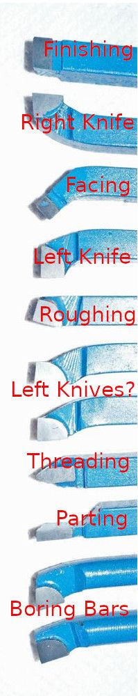

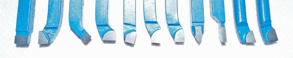

        Good Morning
        My minilathe came with a tool set, I suspect not the best quality but anyway I would appreciate help in identifying each tool and its application.
        I,m new to this but I can recognise some of them but not all..?
        Many thanks
        Ron

          I hate to pour cold water on your morning but I'd put them in a drawer and forget about them for while unless you have a grinder with a green or diamond wheel capable of touching up the edges of the tools and get them sharp enough to cut – and to restore the edges when they chip. The set you have will cut initially but could also be a recipe for frustration in the short term without means to redress them. I bought a set like yours when I started and it was a waste of money for me – although now I have a diamond wheel I use the left and right knife tools occasionally for cutting through rusty and mucky stuff and the scale on cast iron.
          If you have a conventional grinder with a grey or white wheel then I'd buy a HSS right hand knife tool, a boring tool and a parting tool of this pattern in the right size…
          …that should get you turning with something you can sharpen and do most of the things you'll want from an initial set of tools until you get threading, at which point you can buy the internal and external threading tools. Chronos sell individual tools and ArcEuro sell sets.
          The alternative is to buy some HSS blanks and grind your own tool forms but these tools are a quick and cost effective way to get turning quickly and easily FME. I still use my tools of this form as a complement to hand ground and insert tipped tooling. Many people sware by the tangential tool holders but they are expensive unless you can make your own and they are just right-hand or left hand tools really.

                      Here's my attempt at identification:
                      I'm not quite so dismissive of the set as my learned colleagues, though I agree they're a booby trap for beginners. The set I bought was sharp on delivery, others report them arriving blunt. Thereafter, I feel they combine the disadvantages of HSS with the disadvantages of Carbide! They must be useful for something, but I don't know what it is.
                      HSS has to be kept in shape. Jon's picture shows a preformed set that's fairly easy to keep sharp. Vic identifies the Eccentric tool holder which is even easier to maintain. These are good choices for the beginner. Experienced operators can shape an HSS blank to any shape they want but it's a skill that not everyone is good at.
                      Carbide inserts are low maintenance, They're a particularly good alternative to HSS on Far Eastern lathes because they spin faster than most classic machines. True a mini-lathe motor isn't powerful enough to get the best out of carbide, but I've had good results from one with inserts on all metals, particularly with the sharp inserts intended for Aluminium applied to steel. Unlike HSS, there's little need to cool and lubricate during cutting, and you don't have to sharpen anything. On the other hand, it's easier to get a good finish with HSS, and HSS can be specially shaped and sharpened to do very fine work.
                      Which is best depends on what you do with the lathe. One of the joys of owning a new mini-lathe is learning what works and what doesn't. I'd experiment with your dodgy tools. Just don't blame yourself, or the lathe, if they disappoint.

                                          A significant proportion of cheap brazed tooling isn't finish ground.
                                          Sometimes they even have paint below the cutting edge, or you can see the cutting edges of the insert are at 90 degrees, which with an angles insert means they will rub.
                                          This tool IS flat underneath, just it has been slightly rounded underneath at the front. You can see the cutting edge needs relieving.
                                          Usually all that needs to be done is to grind some front relief, but for a beginner grinding carbide to a good finish can be a challenge.
                                          Some of the cheaper sets are crudely forged and when the nominally correct size is used the cutting edge can end up way above or below centre height. My first set of these, each one required either a shim, or a mm or so milling off the bottom of the shank.
                                          A better set I have has accurate cutting edge heights, but they still need a touch up on the cutting edges.
                                          I'm perfectly aware you can buy precision finished brazed carbide tooling (its essential for big modern lathes) but they typically cost as much or more for one tool as for one of the budget sets.
                                          My advice to all beginners is get a set of preground HSS tools to suit your lathe. At the most they may need a small shim to bring them to centre height (use strips of drink can).
                                          These HSS tools are usually designed to be resharpened by grinding on one face only, which makes life easier for a beginner too.
                                          When they come to grinding their own tools the pre-ground tools can be a guide to shapes and angles, although I would recommend using the 'knife tool' design for most general work as it is vastly easier to grind than the 'groove behind cutting edge' type included in the sets.
