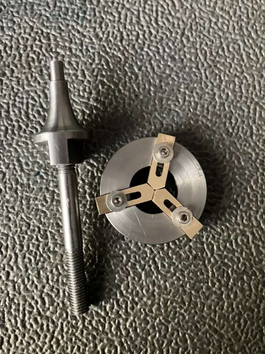

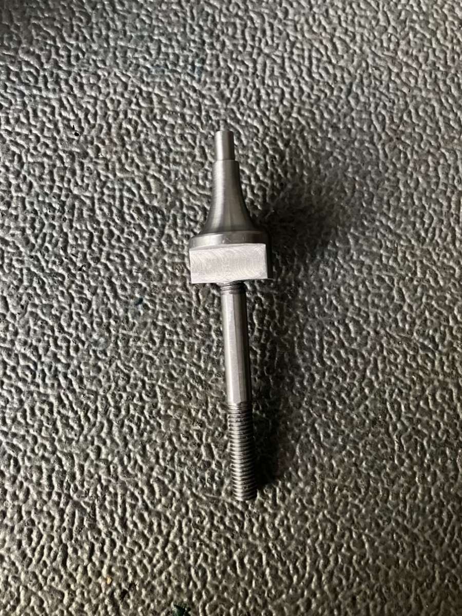

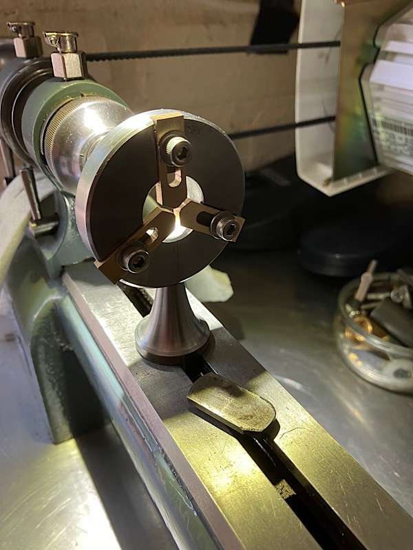

        I made one for my Pultra P type & now making one for a friend, not as sophisticated as above but does the job.IMG_2698IMG_0357-compressedIMG_0356-compressed

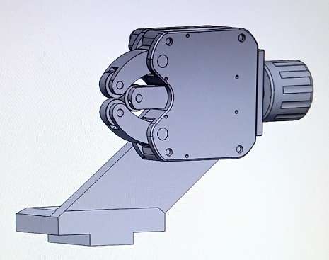

                #816868
                dk0
                  @dk0
                  This is the medium model of the mini self-centering stady rest series.
                  The automatic centering capacity is from 3 to 32 mm in diameter, it can be operated by a small pneumatic cylinder or manually by a radial cam lever.
                  This stady rest is suitable for lathes with center heights from 100 to 150 mm (4″ to 6″).                  Body dimensions: 80 x 82 x 25 mm.

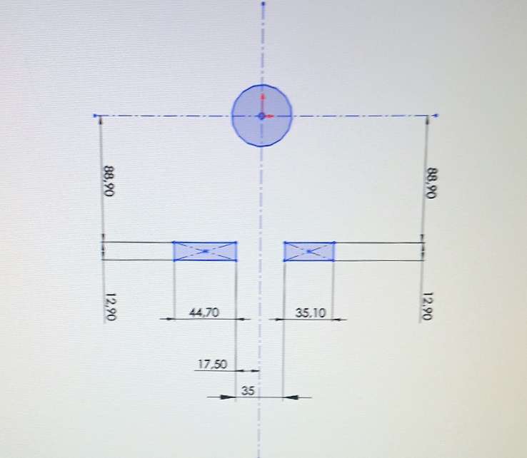

                      #817405
                      dk0
                        @dk0
                        Since I’m designing the steady rest mounting bracket on the Myford ML7 lathe,
                        could someone please confirm the guide lathe measurements of the enclosed sketch?
                        Thank you, Stefano.
                        P.S. In particular, the exact measurement of 35mm guide distance, because it will
                        center the stady rest bracket.
                        20250913_192304 (1)
                        #818020
                        dk0
                          @dk0
                          I’m requesting confirmation that the width of the Myfor ML7 lathe guides is 35mm.
                          Since the measurement is in inches, it can’t be 35, but will have decimal fractions.
                          Thanks to anyone who can help!
