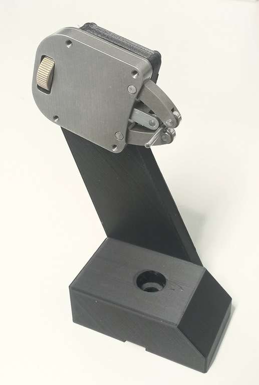

      For turning small diameters on small lathes, I designed a mini self-centering steady rest.
      The clamping capacity ranges from 1 to 12.7 mm in diameter with a centering accuracy of 0.02 mm.
      The external dimensions are 44 x 56 x 10 mm thick.
      This device can be mounted on lathes such as: Schaublin 70/102, Myford, Boley, Emco, etc.
      What are your thoughts on its use? Thank you.

          This is the prototype of mini selfcentering stady rest with the demo/adapter bracket
          for the lathe Schaublin 102 !20250206_145242 (1)

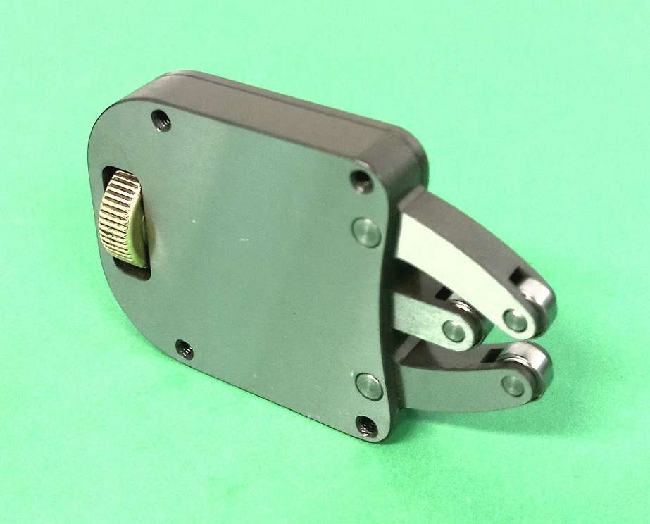

                Now I’ll try sending another20250315_16063 Min image.

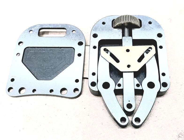

                            Looks great. Agree would like to see construction details. I’m guessing a cone on a thread advances towards the lathe axis and acts on the pair of outer rollers whilst the same thread advances the central roller. Very neat idea.

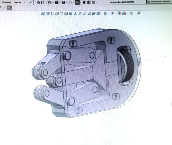

                                Exactly, you understood how it works !20241014_225022
                                #811845
                                  Good illustration, thank you

                                        The great advantage of this self-centering steady rest is that the positioning and centering operation is performed only the first time that the device is installed on the lathe. Afterwards, it can be disassembled and reassembled without having to search for the center every time as with traditional system.  The same steady rest can be mounted as “follow function” on the longitudinal carriage of the lathe, and with each diameter reduction, the 3 rollers automatically center and support the new dimension.

                                            Am I correct in thinking that theoretically to maintain accurate concentricity the two angled ‘wedges’ should not have a flat slope?
                                            #811904
                                            dk0
                                              @dk0
                                              You’re right, it is not a flat slope but a profile based on the rational mechanics calculations.

                                                The triangular brass plate has the function of opening the arms and 20250315_145918 Balso has slots with a special profile.
