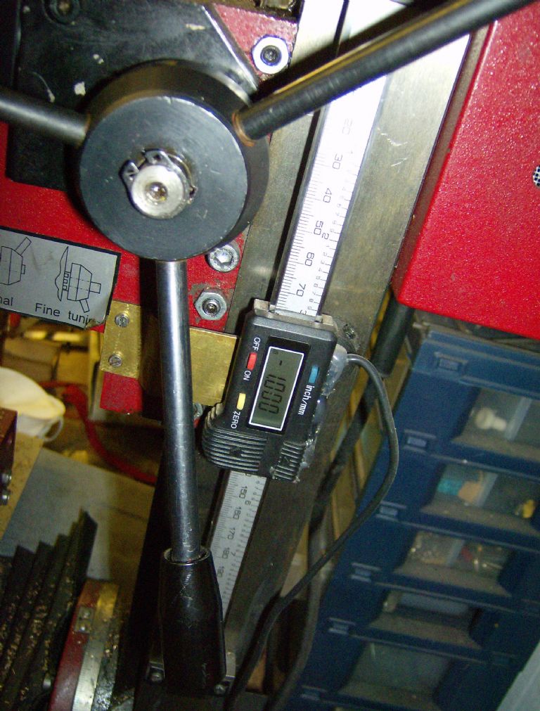

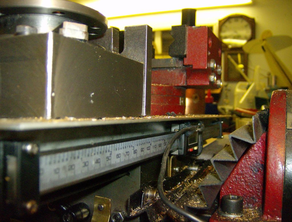

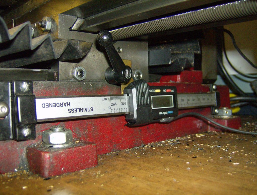

                Pics of the cheap Chinese scales I fitted to my X2 mill. I say cheap, but it didn't feel very cheap when I bought them!
                Note the use of relatively flexible brass brackets rather than supplied steel brackets to move teh heads.
                Z-axis

                Y Axis
                X Axis

                  Very interesting post, thanks for sharing. The leads I take it go to a read out mounted else where, do they also feed the readers their power from this as well? I would bet if they relied on the button batteries mine would run out just when I needed them!

                    Hi Martin,
