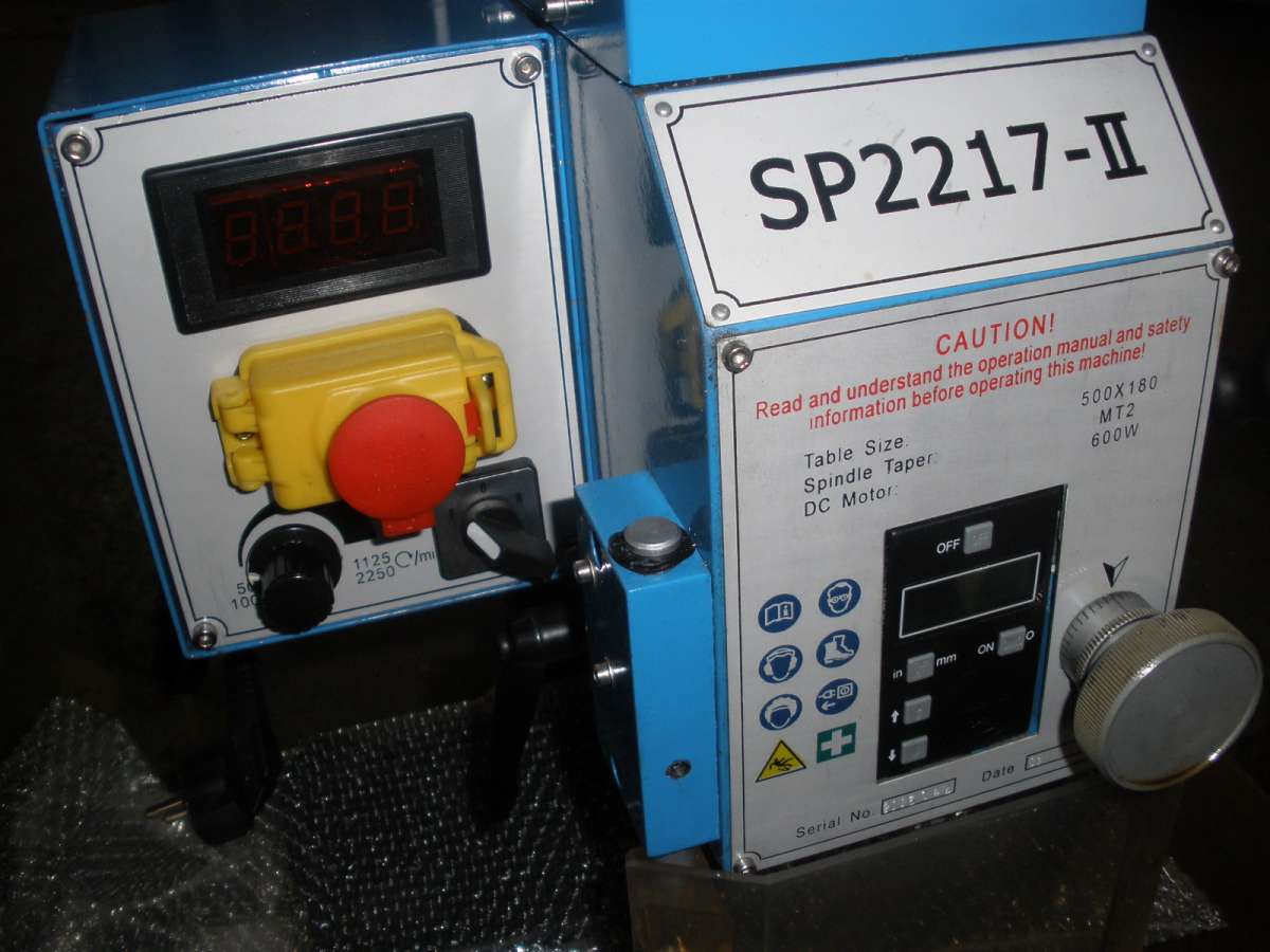

      I have a benchtop Chinese mill which I have owned for about 8 years.
      Same model as this –
      SP2217-II-2
      It`s 240V with variable speed. Over the last couple of years, it’s been tripping the RCBO in the consumer unit in the house. It started off being every now and but gradually became more frequent over time. Now as soon as I press the power button it immediately trips the electric.
      I have checked all the cables and sockets on the ring which it is plugged into (I even replaced the RCBO on the chance it might be faulty) and can’t see any problems. I even tried running it from the upstairs sockets ring and the same problem occurred.
      At the end of last year (when the problem was still intermittent) I replaced the motor thinking it might be the culprit. Obviously, that hasn’t helped.
      Today I took out the circuit boards and checked all the connections for damage or burning and couldn’t see anything obvious. I have ordered a new power switch in the hope something inside there is causing the problem.
      The questions I have are –
      Has anyone had any similar type of problems which they solved. Any info would give me some avenues to explore.
      Also, I disconnected the motor wiring on one attempt and the electric still tripped. My thought was that if the problem was with the motor, although the motor obviously won’t run the electric would not trip, but it did.
      Am I on the right track with the switch or are there other areas I should be checking. Any thoughts greatly appreciated.
      Ady.

          Just to clarify does it trip when you switch on power at the wall or when you press the start button ? Do you have access to a multimeter or Avo meter ?
          #849017
          Ady Wilson
            @adywilson52106
            The machine is in the garage and I plug it in via an extension from a kitchen outlet when using it. I know this is not ideal but I have had the machine many years and it had performed fine until the last couplke of years when it occasionally tripped the RCBO every now and then. When I am out there I make sure nothing else is running like washing machine etc..
            It doesnt trip when the power is on at the wall, only when I press the switch to start the motor. Previously the motor would run for a minute or some seconds before it cut out. Now it trips on pressing the power. I do have a multimeter but am not sure where and what I should be testing for.

                                    I took the on/off switch off the machine and put a multimeter across the terminals. I only have basic knowledge in this department but can check for voltage and continuity on simple things. I watched a video where a guy was testing an identical switch which helped me greatly. I set my multimeter for 200k ohms. When I press the switch, I get a brief resistance reading and then it drops to zero signaling the circuit is closed. I was wondering how stable the resistance reading should be when the switch is initially pressed. I have the switch in the house with me now and when I operated the switch 10 times in testing, I got the following –
                                    62.0, 11.1, 7.5, 76.6, 27.0, 63.2, 2.8, 23.7, 69.8, 27.9
                                    Those readings were with the meter set at 200k Ohms. Is that kind of difference or fluctuation normal or could it cause an issue?

                                      By on-off do you mean the yellow switch with the emergency stop button on the cover?
                                      I would not expect any resistance reading in the 10’s of kilohms that your readings imply. Can you post a picture showing where you are measuring? Even if the switch contacts are faulty I’d not expect it to trip an RCD.
                                      The important measurement is at the 13A plug. Measure the resistance between  the earth pin and live pin with the machines power switch off and on. Then do the same between the earth and neutral pin. If the on-off switch is the magnetically held type (looks like it is) hold the green button down whaile making the ON measurement.  Use the highest resistance range your meter has.
                                      This will only test for insulation failure not ac leakage through the filter capacitors but at last it will  rule dc leakage at low voltage out.

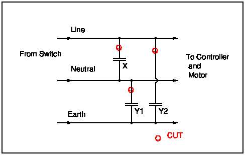

                                        I’m too poorly to explain this sensibly, but could Robert address the possibility that one or more of the suppressor filter capacitors in the lathe is faulty and leaking enough current to earth to trip an RCB? Suppressor capacitors have a hard life because they are connected directly across the mains and sometimes fail by dribbling!   The possibility was mentioned early on by Bill (peak4), and not picked up, even though it’s a likely cause.
                                        Typical circuit:
                                        XCFilter
                                        Suppressor capacitors stop electro-magnetic muck entering and leaving the lathe, and it will run without them.  Therefore faulty capacitors can be detected by disconnecting them, see CUT above.  (I’d start with Y2).  As they’re cheap (RS Components) and easily swapped if a soldering iron is available, I’d replace them as the first move.   If Ady posts a photo of his board, should be possible to identify them.
                                        Unlikely that a faulty switch would trip an RCB – we’re looking for something leaking current to earth.
                                        Another possibility is dirt/swarf bridging tracks on the board – lathes are vulnerable to this! I suggest Ady give the board a good clean with contact cleaner and cotton buds, and look carefully with a magnifying glass for tiny slivers of metal.
                                        As electronics can be difficult to diagnose and fix even if the owner has the necessary test gear, the easy answer is for Ady to replace the whole controller board.  It’s the modern way – I don’t know of any commercial firms doing this type of simple repair. 🙁

                                            Update –
                                            I unplugged everything from the upstairs and downstairs sockets in the house, which as I said earlier are on separate RCBO`s. That meant I could run two extensions, one from the upstairs and one from the downstairs, so when I tripped one, I could plug into the other. Giving me another chance to test before I have to go in house and reset.
                                            Something interesting I discovered. Normally when I start the mill by pressing the power button, the variable speed controller dial is its lowest setting (turned all the way to the left). I tried starting the mill a couple of times and it tripped the power immediately on pressing the button, no time for the motor to even begin to turn just an immediate trip. I must have rotated the speed dial unintentionally and when I reset everything and went back out and tried again the motor fired up and ran. It caught me off guard with it spinning so fast (holding fascia in my hands) so I immediately hit stop on the switch.
                                            When I put the speed dial back to lowest setting the power tripped immediately on next attempt to start. I reset and moved it up to about quarter and tried again. The motor fired up for a couple of seconds then everything tripped again. So, I moved the dial up about halfway and tried once more and the motor spun up and continued running. I let it run for about 10 seconds, switched it off and repeated and it worked fine. I did this another few times and all was good. I then tried moving the speed dial back to its zero position and the power tripped immediately. I repeated all I had done previously, trying different positions on the dial. Any position below halfway either causes an immediate trip or the motor runs a second or two and then a trip. If it is set halfway or above it runs ok.
                                            I am going to have a brew and then repeat what I did and let the motor run longer. If it works consistently I will plug all the appliances back in and try it again and see what happens.

                                              A Y capacitor failure can certainly cause an RCD trip. They do tend to be cascading and catastrophic though. The RIFA brand film types are well known for the very smelly smoke they release on failure. The DC resistance checks will detect most capacitor failures but ideally an insulation tester would be used.
                                              The latest symptoms reported by Ady are interesting. It’s hard to know what is going on without knowing the design of the motor drive. It appears to have a brushless DC motor but that covers a wide range of designs. It might be something like  dynamic brake function.
                                              I await results of the re-test.

                                                Very interesting ! Sounds like cap leakage being masked by the motor when running. For what they cost I would change them for a start. With out test gear it may be hard to solve. Noel.

                                                    I tested the potentiometer with no power and on the machine and it functions from 0 – 4.5 when turning it from min to max. It gave some erratic readings in the lowest postion initially. I took back off and blew it with some air and it seemed to right itself. I then put the multimeter on the outside terminals and got 4.5 which I beleive is right as it matches the maximum from previous test.
                                                    I then put the probes on the outer terminals and plugged the machine in (not running obviously). I got some very erratic readings with the meter set at 200Ac (hope thats what I should have had it set on lol). See video –
                                                    Is that a problem with the potentiometer or the feed to it?
                                                    #849247
                                                    Robert Atkinson 2
                                                      @robertatkinson2
                                                      Only DC on the pot. Typically about 5V.
                                                      Phil’s comment is about the mains voltage. I would not recommend measring mains with that meter. It is not safe. If you must measure mains connect it up with the equipment unplugged and don’t touch the meter or leads while power is on.
