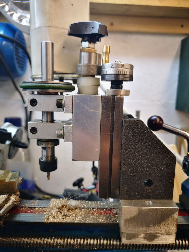

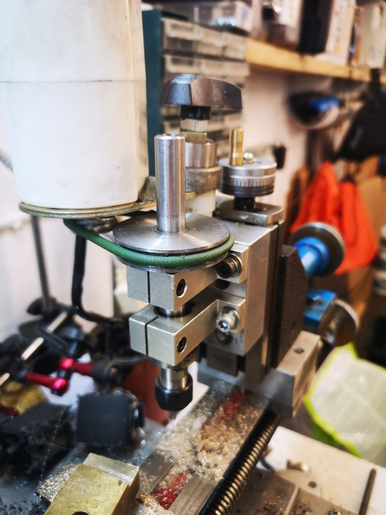

      Quite some time ago, I asked for information about making a milling attachment:: I have finally finished making one now for my Flexispeed. The lash-up with the plastic wing nut and the spacers is temporary until I can buy a suitable 6mm cap screw or bolt of the correct length.
      I was uncertain how rigid it would be or whether the 70 watt sewing machine motor would be suffiiently powerful to be useful. I am pleasantly surprised as the device can take fairly deep cuts, produce a reasonable finish and the motor does not stall. The finish is lot better than I was getting when I used the vertical slide as a conventionaI slide with the cutter on the lathe spindle. I am confident that with patience, I should be able to do small jobs effectively.
      All I need now is a small vice to attach to the cross-side. Does anyone have anything suitable which they would consider selling?

          Splendid job, James yes
          #533908
          noel shelley
            @noelshelley55608
            Very Nice well done ! I'm supprised the 70W motor is enough. Noel.
            #533917
            DiogenesII
              @diogenesii
              Looks like a good idea turned into an effective attachment – nice work. .you could make a drilled & tapped plate to bolt to the top of the slide to clamp work to, if you are stuck for a vise?

                      #533978
                        I’ve just had a thought, James enlightened
                        That long tee-slot on your tiny cross-slide [and/or a tapped auxiliary plate] would be very useful with something like the Mitee-Bite products:
                        I say ‘something like’ because the real ones might be considered ‘reassuringly expensive’
                        … Have a look here, for inspiration : **LINK**
                        https://www.wixroyd.com/en/page/mitee-bite-clamping-products-from-wixroyd
