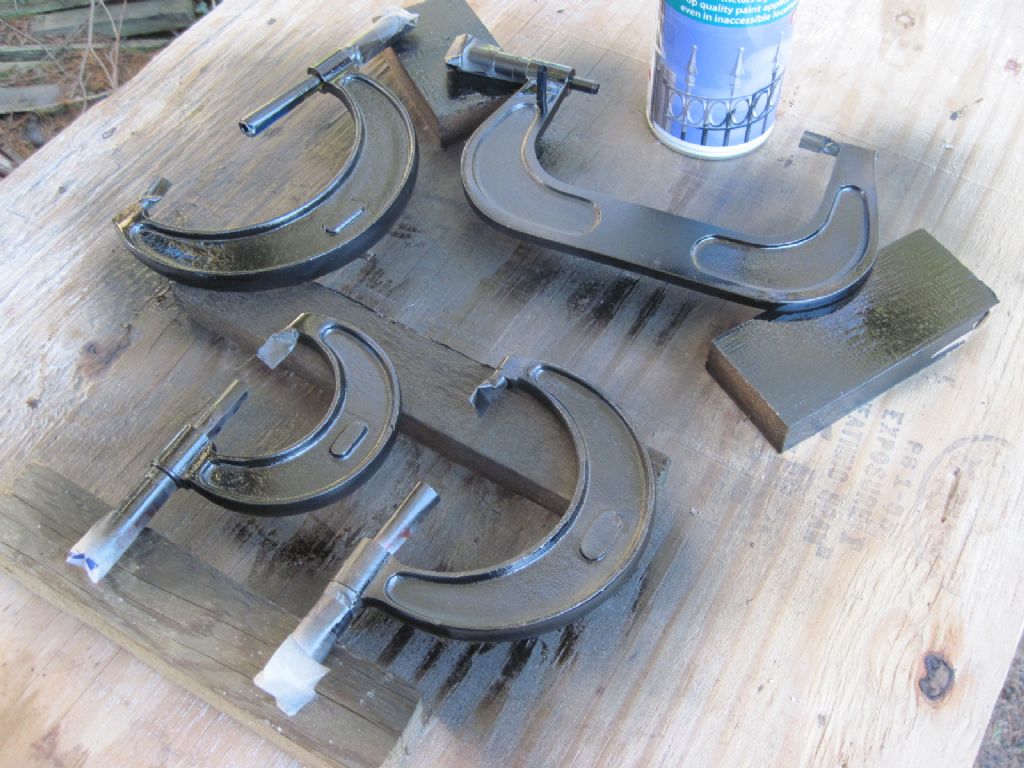

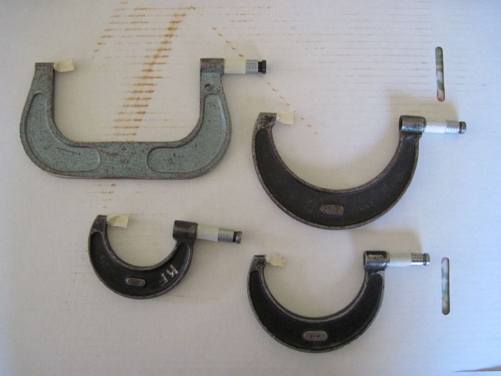

                                Well, always things to learn – as I didn't know that you needed to oil your Micrometers.
                                I have several smaller Mics (0-1" & 0-25mm) but earlier this year I needed to 'compare' something to better accuracy than I could mange with my vernier calipers. So I bid on a large micrometer and (whilst at it) made some silly bids for the ones 'in-between' (M&W). To my surprise, I won them all, possibly because they didn't look too good in the photos supplied and were not in boxes.
                                On receipt i decided to clean them up (this is probably complete heresy to some on here!) and stripped them back to bare metal and re-sprayed them (after careful masking). They look much nicer now – and although I have no idea if they are accurately calibrated (and have no means of doing so) I don't see why they can not be used as 'comparators' (which is what I needed one for).
                                So I just need to make some boxes now – and maybe oil them a little too!
                                Regards, IanT
