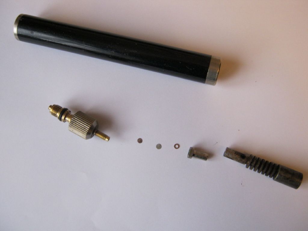

      Once again I find myself in need of the assistance of the members of the forum.
      The photograph shows the constituent parts of a micro burner that I have had for a good few years now, which has always proved to be a sturdy and reliable piece of kit……until recently, when it started spitting and spluttering and sometimes no gas at all.
      I took it apart and cleaned it and now I only get a non-aerated orange flame. I am not sure of the order in which the small washer, microfilter and stainless steel disc came out, but whichever order I put them back in I can't seem to generate the required gas flow to provide aeration to the flame.
      Eyesight not being what it was, could I have lost a part?
      Does anybody recognise the burner as it has no maker's marks and if I can't fix it I wouldn't mind a new one.
      Here goes uploading the photo……it might end up on another post. Well I'm blowed……I managed to do it first time.micro burner

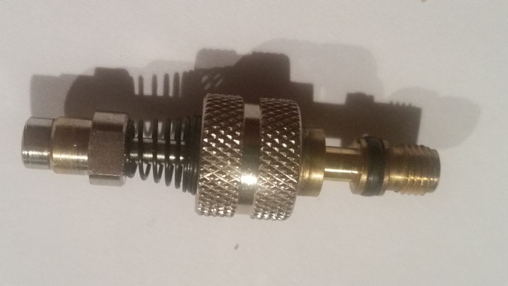

                Here is what I've got. I can't get it further apart so you have to give me instructions what to do next. It is the right side I have to take apart? It should screw loose in a normal direction?
                #336259
                Wout Moerman
                  @woutmoerman25063
                  Hmm. The picture flipped so the right side is now on the left. I mean the nozzle and not the part with the O-ring.

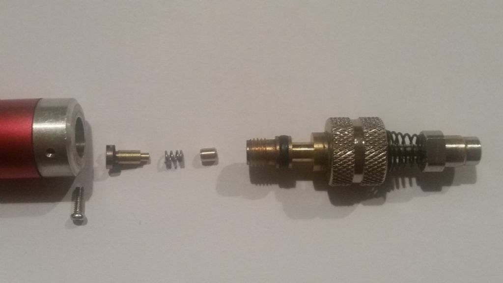

                    This is the gas tank side of mine. I hope this is the right order but these parts dropped out …

                      Thanks for taking the trouble dismantling your burner. Although similar, your one is different to mine. There are no springs on my set-up and it looks to be shorter in length. As for the nozzle, on mine it unscrews conventionally ie right hand thread. Do you have any idea who the maker was? I have got another small burner but in the past this one has been a really good performer.

                        Mine is from ETC but it is over 30 years old. The black conical spring seems to be cosmetic because the parts surrounding it are locked solid.

                          #337505
                          onion
                            @onion
                            Hi Mick,
                            I believe you have all the parts of a micro torch marketed by Draper (and others) circa 1990s
                            I bought my example from B&Q but other stores may still have slow moving stock on their Draper stands.
                            MachineMart offer a suspiciously similar torch as part of a Clarke soldering kit CBT5K for £28+vat
                            FWIW
                            My example failed soon after purchase, self extiguishing/erratic flame problem. A number of dismantle/clean attempts resulted in the restriction disc being lost. Using the twist on/off valve would not produce a bunsen flame just a yellow flame as you decsribe.
                            In my case a replacement disc made from Bacofoil punctured by a sewing needle restored normal operation.
                            I can't remember the disc reassembly order other than the washer was last to prevent the foil replacement disc being torn by torsion on reassembly
                            HTH
