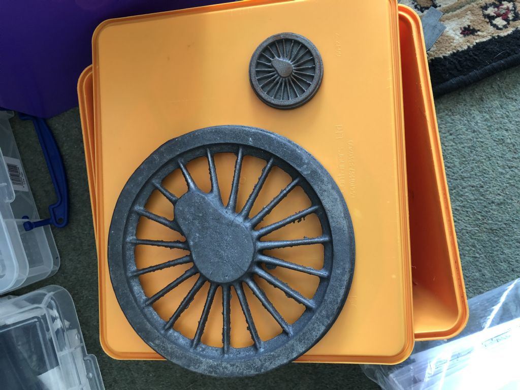

      I am working on an 0 Gauge 4-4-0, for which I have wheel castings, where the spokes aren't truly spokes as they are all joined by a complete cast disk at the back. the photo shows a driving wheel to machine (dwarfed by a 5" black five driving wheel, where the spokes are true spokes, if that makes any sense?)
      I suspect drilling and filing each would send me crazy, but if machining the back solid portion off the centre on the lathe, as I break through the load on the spokes would potentially shatter them?
      Is patient fettling the answer, and I should be thankful it only has 4 driving wheels?

          As far as I'm aware, the intention is that you machine the back away as a last operation – very carefully and gently – to expose the spokes. I imagine they're cast that way because the spokes on the 0G wheel would be so thin that they'd be impossible to cast otherwise – or at the very least they'd be chilled and be very fragile. If it was a split pattern – like the 5"G one – than getting the two halves of the mould to line up within a thou or two would be another problem.
          Just take it steady!

            If you are really concerned about ham-fisted machining shattering the spokes, heat up & flow soft solder into the recesses between the spokes, machine the spokes free and then melt out the soft solder.
            The chances are that if you have a really sharp tool and take tiny cuts, you'll get to the point where you have foil between the spokes and it will deflect out of the way. At that point a penknife blade will act as a deburrer to cut the last bits away.

                  I think Richard (andTracy) has it right RichardN – very sharp tool and light cuts will do it – that's how they are made to be turned.
                  On wheel castings I generally use a tipped tool to take the top surface off and then a HSS tool for a good finish – so don't try the whole work with a HSS tool without giving it a quick 'hone with a stone'. This was required for sand castings but may be less so for lost-wax castings (Mark Woods wheels for instance) which will not have sand embedded in the top surface.

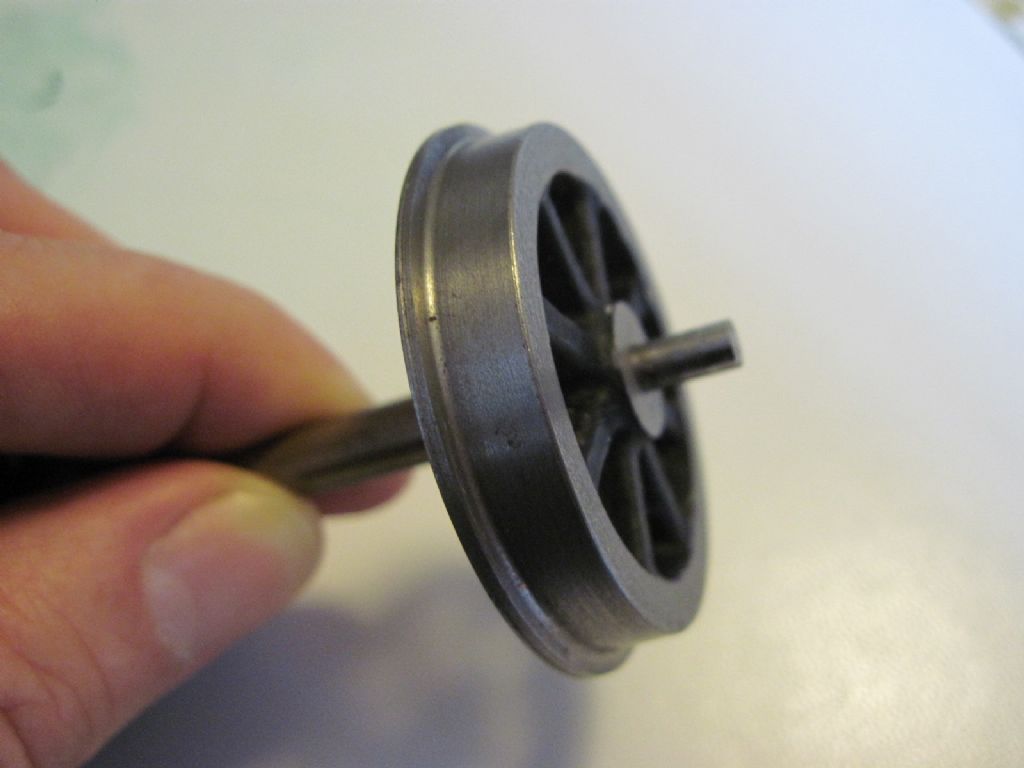

                  BTW – Mark Wood has some very fine wheel castings but (looking at his 'turning' advice) frankly I've never used a form tool to finish wheel flanges in G3 (and would not pay a toolmaker £100+ to make me one either). My usual practice is to turn all wheels on a fixed mandrel [square] to nominal size and then use a round nose tool to put on the cone angle (3 degrees in the G3S standard). This rounds the base of the tread nicely. The final 10 degree flange angle (at the top of flange) is simply done with a file. Never had a problem doing wheel castings like this.
                  Regards,
                  IanT

                    Nigel was correct above. I have machined G1 wheels like that. Note you don't machine straight across you leave the rim full thickness otherwise you will lose part of the flange. They aren't as fragile as you think if they casting is sound. A purist will then file the rear of the spoke to profile.

                      Thanks for the replies- sounds like I’m overly worrying, and will have to just jump in and try to follow the advice with sharp fine cuts- might try supporting with soft solder, for peace of mind… and filing the rear of the spokes- I genuinely hadn’t thought that people could leave them as machined- I was aiming for the same profile as the front, I was thinking.

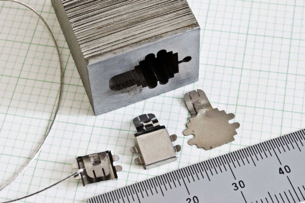

                                      While designing and building a 'bundle' of quite small prototypes, it was necessary to make about 300 stainless steel electrodes 7x7mm square by 1mm thick. First thoughts were to just chop up some 1mm stainless sheet and machine them as blanks.
                                      Attaching stainless (suture) wire for electrical (and other) purposes presented a few difficulties, as did securing the electrodes in place. Then I discovered a process that would allow me to profile them from much thinner material, SS 0.07mm shim to be exact.
                                      As you can see here …
                                      the electrodes could feature tabs as a means of attachment together with a (rather crude) means of attaching the wire.
                                      The block in the picture, now more of a desktop novelty is 25x20mm. The stack height of about 300 shims measures 35mm. Gauge steel pieces 1.5mm thick riveted through the length provided support hold the sandwich together.
                                      Held tightly in this sandwich arrangement produced clean blanks with no need for deburring.
                                      Although the wire EDM process was developed in the 60’s, it was about 1990 at a company somewhere south east of Melbourne when these particular electrodes were ‘burned’. Clearly from the literature and links, significant advances have taken place since then.
                                      The process might prove useful to Model Engineers!?
