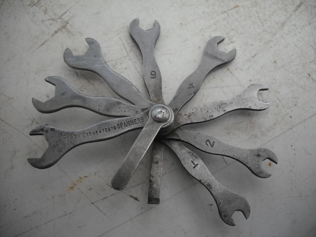

      What are the numbers for?
      #461011
      Anthony Knights
        @anthonyknights16741
        I found this while looking through an old box of tools. It has cleaned up OK and is marked "Terry's Sr.No.673876 SPANNERS". They are marked 1 to 8 with no 1 being the smallest. No 1 is a loose fit on a 6BA nut so I was wondering what if anything the numbers refer to. I seem to remember using them to adjust the contacts on the magneto, on my first motor bike, a 350 Royal Enfield.mag_spanner.jpg

          Yep, magneto / ignition spanners – there is probably a feeler gauge (or two) and a screwdriver in there as well. Unfortunately I have no idea what the numbering refers to.
          #461016
          Johnboy25
            @johnboy25
            I'm pretty sure they're BA sizes but don't know why they were numbered like that. They were common issue in MOD establishments. I'll have to see if I can find a set in the miscellaneous tool drawer to have a look. and remind myself…

              I am pretty sure they are not BA the smallest is No 1 and they get bigger BA starts at 0 and gets smaller.

                  Well if you want an answer ask your wife, I just did. Terry's numbers are not BA although other spanner makes did mark them BA. She can't remember why they are just numbered but No 8 is a 4 BA. Also Magnetos either used BA or BSF threads.

                          I have a set (also inherited from my father) which look just like the picture…except the numbers go the other way. I can confirm that mine are indeed numbered by BA sizes.
