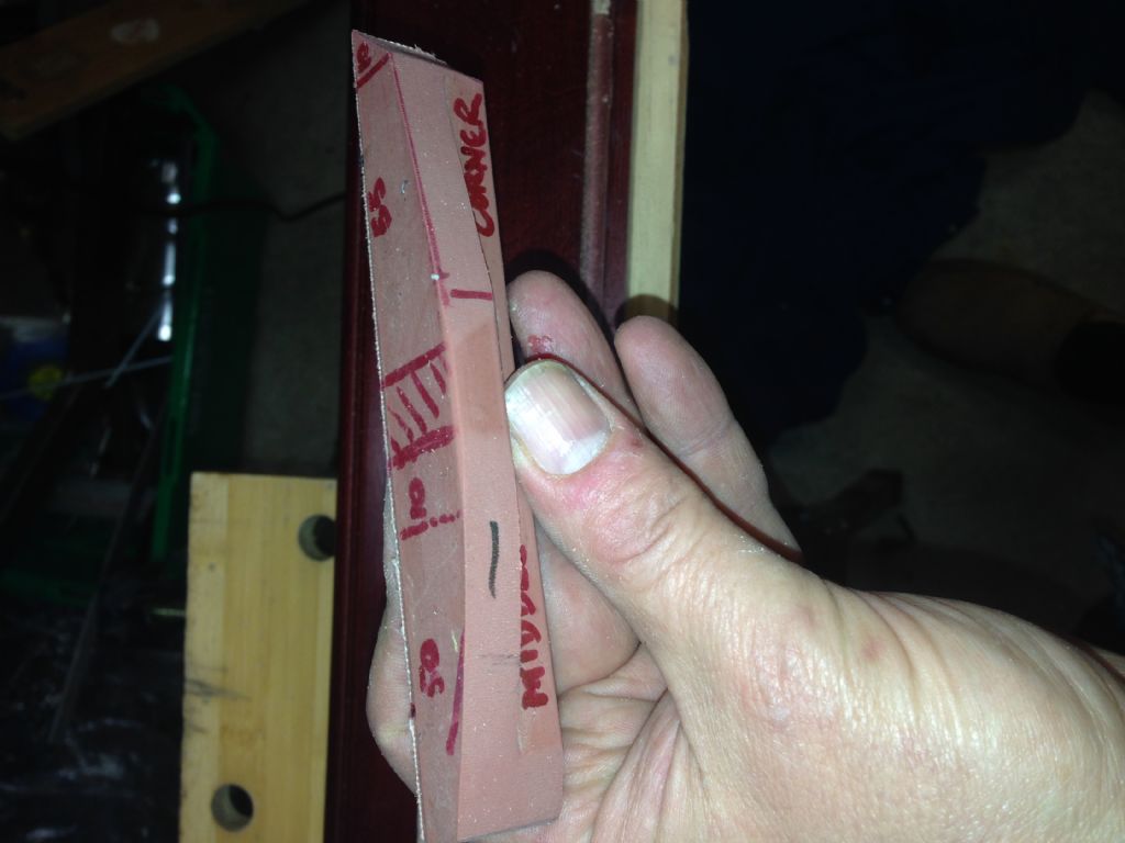

                          Muzzer
                            @muzzer
                            From what has been described above, it sounds as if cork would be very difficult for most of us to machine using single point tools or blades.
                            I've recently been "machining" some vulcanised natural rubber strips. These are actually snooker table cushions and are very elastic (they need to have a very high coefficient of restitution) and pretty soft. I had to taper them at each end where they merge into the centre and corner pocket areas.
                            My first thoughts were to try some form of sharp blade (ouch!) but this was clearly not going to work. Even with a very sharp wood chisel and a smart blow, it's impossible to place the cuts anywhere near you need them and blend the surface acceptably. I also tried some very sharp tin snips and the result was pretty awful.
                            The solution in the end was to hack off the bulk of the material with scissors or snips and then use a belt sander to remove the rest. As you can see from the test piece, you can get a very reasonable result indeed. Believe me, this is a miraculous improvement compared to the first attempts with the cutting tools. Just keep yourself to one side unless you want rubber crumbs everywhere! Of course, this is what the professional snooker table restorers do.
                            I imagine something similar would work very nicely for cork. If I was planning to "turn" cork, I would probably mount a Dremel tool in the tool post and use a fairly coarse one of those sanding wheels.
                            Muzzer
