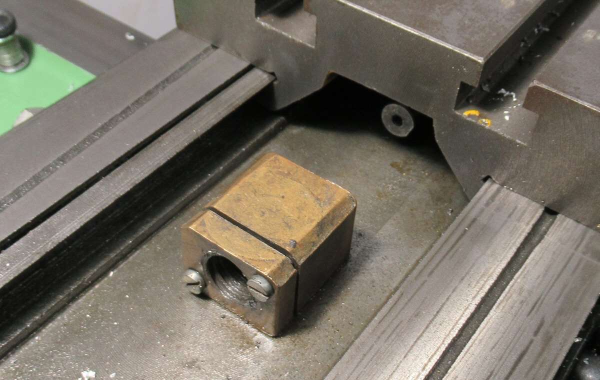

      How do these work, well I know what they do but this just rattles itself loose. there seems to be no way to lock it after adjustment.
      I have a couple of ideas how to resolve this problem, but first of all what is the norm, am I a bit missing  (there i nothing between these two plates)
      xLathexslide7155

        What are you doing that causes such serious vibration?
        What you show is completely conventional, nothing missing.
        A dab of the weakest threadlock on the screws would seem a pragmatic way to overcome your difficulty.
        Very much as an aside, is there any preferred direction for the split nut? Assuming it is for the cross slide, should the thin side face the operator or face the back of the lathe? Should the answer be different if you do a lot of boring?

          Threadlock the adjustment screws.
          Shouldn’t need adjusting very often.

              The screws pull the gap closed, bending the part enough for the female thread to grip the male screw more tightly. It compensates for backlash.   However, don’t overdo it – a tight fit causes rapid wear.   I only tighten mine when backlash gets above about ⅓ of a dial turn.
              The adjusting screws are normally quite tight – enough to close the gap slightly.  I guess they’re loose because you haven’t tightened them enough to reduce backlash.  An unworn lathe may not have significant backlash yet, so the screws are loose.  I’d nip them up a bit harder or put some threadlocker on.
              The design is a compromise: bending the part is an inexpensive way of compensating for wear.  Posh anti-backlash mechanisms are costly.

                I’d be tempted to add spring washers under the screw heads, to see if that helps.

                  Looking at the split nut by zooming in (a lot) it appears to me that the “slot” goes all the way through, creating two separate items..  I would expect there to be some sort of spring mechanism between the two parts to impart a bit of anti-backlash to the nut.  If not entirely split. I’d be tempted to saw the thin bit off and put a spring between the two with longer bolts, then Loctite them in, once the backlash had been eliminated. If the spring is “just right”, in compression,it should compensate for wear and subsequent backlash automatically. Finding the Goldilocks spring might take a bit of experimentation

                    No you don’t need a spring between the parts. Star washers of spring washers might work if you have them. Threadlock is only meant to make the screw tight not lock it solid. They tried calling it “threadmakeitslightlytightnotlocked” but it was too long to ft on the bottle.

                      The design is very basic, just a nut with a saw cut 90% of the thickness so the small screws can bend the thin part and take up the backlash. They were on the museums round column mill on both X and Y axes. As soon as I could get hold of the right pitch internal Trapezoidal threading inserts, proper adjustable nuts were made.
                      I still have the old nuts which are 2.5mm pitch, left hand for the X and right hand for the Y and about 22mm diameter threads.
                      You also need to minimise the end float on the leadscrew which is adjustable.

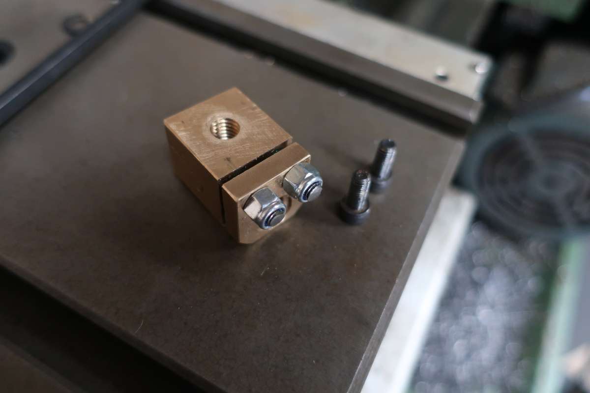

                          Fit studs in the body and use Nyloc nuts on the studs..
                          GH600 Cross slide nut

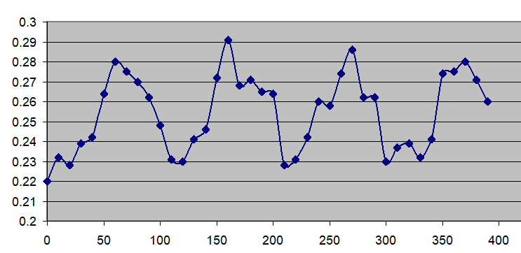

                              first of all the two studs with the nylocks is the way to go and that is what I will be doing
                              However, I tried a spring washer between the gap and i thought it went quite well, seem to get a nice tightness to the lead screw.  so tried a dial gauge to assess how well it was working, and its hopeless
                              the following is graph plotting the lead screw against the dial gauge, the Y-axis is mm from the dial gauge and the X-axis is thou from the lead screw
                              I plotted every 10 thou of an inch and should have produced a straight line at 0.254mm
                              clearly the discrepancy is related to the rotation of the lead screw – but what is going on ?
                              Obviously I need to repeat this a few times to check for consistency
                              but should the floating part o the block be alwys allowed to move inwards – (rather than locked in place as I have it with the spring washer between)

                                Try winding the slide right in, and then loosen the bracket that holds the screw/handwheel assembly and re-centralise it, with the aim of getting the screw co-axial with the nut – ‘best fit’ will do – a bit of trial and error will often find a sweet-spot.
                                Do I interpret correctly that deviation from ‘straight’ in your graph appears to be about 25um?
                                  Misleading.  This form of backlash adjuster is a crude clamp.  No point I suggest in putting a DTI on it.  Adjust it by feel.   The screws are tightened just enough to bend the nut so it’s threads bear lightly on the lead-screw.   The handle should turn smoothly with reduced backlash  until wear loosens the clamp and the screws have to be retightened.  The purpose is to reduce backlash, nothing else.
                                  I think the DTI is detecting that the nut isn’t bent tight enough.   And DTIs are sensitive enough to pick up a trivially bent or worn lead-screw and looseness at the handle bearing end.  My advice, don’t jump to high-precision measuring too quickly.  It’s tricky to do properly, and is most useful for homing in and proving rather than understanding the big picture.
                                    yes, every Ten ‘thou of an inch’ adjustment creates a movement between 225 and 285 microns.   So yes defianion 25 to 30 microns from expected
                                    25 too much when dial at 60thou
                                    25 too little when dial at 10 Thou
                                    If i have time today I will repaet the test a few times to get an average – then try it with the origina set up that allows to floating plate to move freely towards the main block

                                      You may be overthinking things here. I’m a bit unclear from your description on exactly what you are doing. But if you are measuring cross slide movement with a dial indicator versus the feedscrew movement shown o  the graduated handwheel, it is not telling you much.
                                      Stiction between the sliding surfaces will account for the inconsistency. Backlash in the nut is not critical. Cutting forces will push the cross slide nut back against the thread and take it any slack.
                                      Just take up excess backlash with the nut so there is only a few thou of freeplay on the handwheel dial and carry on turning.

                                          Any thread with inclined flanks (e.g. Acme, M, Un, etc.) will produce cyclic variations in advance movement if the leadscrew is not perfectly concentric with the nut quite apart from the effects of having adjustable nuts.

                                            Just looking at your chart again, and reconciling the two different measurement systems, it looks like you are getting a variation of between .02mm and .03mm, which is about .001″. One thou.
                                            You really can’t expect to get much better than that on a low cost hobby lathe. In fact you are lucky to get that close. It’s not an industrial precision grinder.
                                            Again, I’d adjust your nut to eliminate most of the freeplay and carry on turning . Learn to turn the handle back past any backlash and always approach from the positive direction.
                                            ChrisLH’s point about concentricity of the screw and nut is very relevant too, especially on a low cost hobby lathe where manufacturing standards are notoriously inconsistent. Bent screw can do it too.
