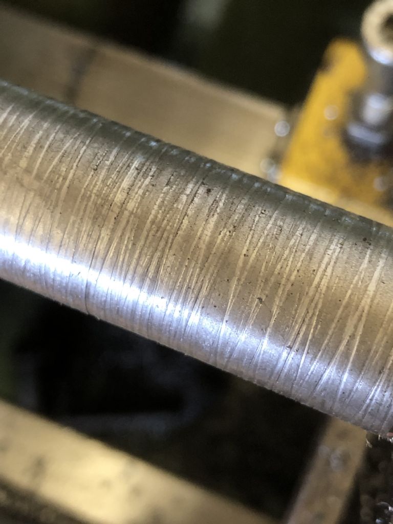

      Hi There
      New to the forum and to working with lath. I recently bought a Waco WM240B Belt drive lathe.
      It worked well in a sense that it gave my smooth fine surface. But the other day I change gears for thread cutting, then change it back to the original setting (presumably) and ever since i got very raged surface finish even thug i am using the automatic feed. When it got to the end i disengage the cutting head and manually bring it back to the beginning. During the path back i can see that the cutting head still cutting the metal? (See attached photo). Any idea what wrong?
      Thanks

          Have you returned all the levers to their original position ? Seems like you still have the leadscrew engaged or federate positions wrong. You should wind the tool away from the workpiece to return to the start position.

            Typical cutting on returning the cutter to the starting point is poorly adjusted gibs on the carriage. But you problem could also have other causes. A poor cutting edge is among the others.

              Change of material? Tearing is common with low carbon steels and insert tooling if you don't get speeds and feeds correct. Cutting on the return is common. It can be caused by the work deflecting away from the tool slightly on the cutting pass and then springing back.

                Looks like you're cutting a thread there, so it's understandable that it would cut the untouched sections when you wind back. Does the carriage move slowly or quickly when using the power feed? As others have said, check you have reset everything to how it was before.

                        What tooling are you using. HSS or carbide tipped tooling? Positive or negative top rake? I've seen negative top rake cause this before, especially if you have a longish workpiece unsupported by the tailstock. Some refer to it as "springback".

                              The marks on the piece in the photo look maybe like the feed is still in screwcutting mode. Looks like one set of marks about 1mm apart going in the right hand thread direction, then another set coming back in the left hand direction.
                              Looks like you maybe need to check your lathe owners manual and the settings of all your gearbox levers and change gears or whatever you changed when you went from fine feed to screw cutting. Sometimes you have to jiggle the headstock spindle back and forth as you change the gear levers on the gearbox so they can move to the new position fully.
                              A picture of the work after one cut without winding the carriage back would give a clearer view of how the tool is cutting. The return marks are somewhat confusing the issue I think.

                                  Yes I think you are set up for screwcutting, not turning. Can happen, ask me how I know !!

                                    Thank you all very very much for your replay. I think the problem must have been because of me putting back the gears wrongly. I am not sure that i can see in the manual the original setting but i will contact Warco for that.
                                    Thanks again for all your replay. I got a lot of tips & trics out of it.

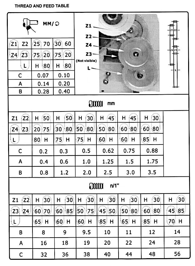

                                      Journeyman
                                        @journeyman
                                        The manual should have a chart like this
                                        Or indeed there is a chart affixed to the change gear cover that shows where each gear should be. The chart above is for the WM250 but yours will be very similar. Don't forget the 3-way gear change knob on the front which also needs to be set to its slowest range position C.

                                          If it's any help. my WM240 came set-up with 90T, 90T, 80T, 33T & 25T (+ 2x40T fixed) change gears for fine feed. I didn't know the WM240B came with a 3-way gear change.

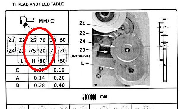

                                            +1 to John (Journeyman's Chart)
                                            The fine feed settings are shown at the top, and I've ringed the set-up I'd use in red.
                                            I think the example gear arrangement pictured on John's picture is what's needed for fine feed. The big 80 toothed gear at bottom 'L' engages with a small 20 'Z3' hidden behind the big 75, 'Z4'. That engages with the visible small 25 'Z1', which turns the big 70 'Z2' behind. The 70 toothed gear engages with the spindle hidden behind the pulley.
                                            All my gears (for a WM280) are stamped with the number of teeth, but the numbers aren't obvious! I've written the numbers on boldly in felt tip to make life easier. (Felt tip needs a grease free surface.)

                                              Posted by Bo'sun on 31/03/2020 10:59:27:
                                              Your right, the WM 240B doesn't have the extra lead screw gear change. My bad, sorry.
