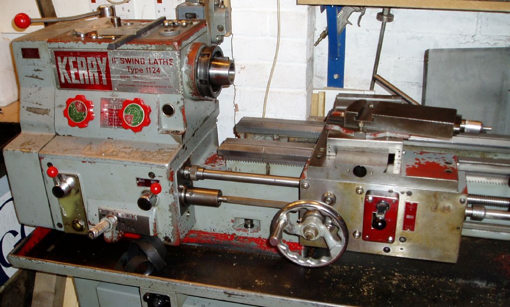

        I'm chasing a bit of a needle in a haystack khere.
        I have a Kerry 1124 lathe, which I bought cheaply way back. Although I've shown it nothing but love, at least one previous owner was less caring, The top slide has suffed a nasty crash, and the thread cutting plate has disappeared, to name just two of the issues it has.
        More recently, I discovered why i've been making under-size parts all these years. I thought it was just poor technique – which of course it was – but compounded by the fact the cross slide has a metric dial, 2mm per turn, but the leadscrew itself appears to be imperial, and moves 2.54mm per turn.
        I've looked around for something to replace it with, but never quite taken the plunge. Since buying it, I've acquired quite a lot of tooling for it, which I don't really want to have to buy all over again. In the end, what I would really like is just a better version of what I already have.
        So, getting – finally – to the point, I would be very grateful for any leads either to a complete lathe that might be for sale or anyone with suitable spares for a Kerry 1124 or compatible machine.
        Thanks very much

          Andrew,
          Is it your wish to have a metric screw or an imperial dial? What are main leadscrew and compound leadscrew metric or imperial?
          Could be that someone has swapped all the screws and that's why the threading plate is missing, it would no longer be relevant.
          Pete.

            Hi Pete
            In general I would say it's a metric machine. I'm going to use the wrong term now, forgive me, but the "main leadscrew" for screwcutting has a 4mm pitch and all the dials are graduated in mm. Since discovering the mis-matched part, I've bought a cheap digital display, one of these digital verniers with a remote display, but it would be good to have a screw that matches the dial
            Cheers

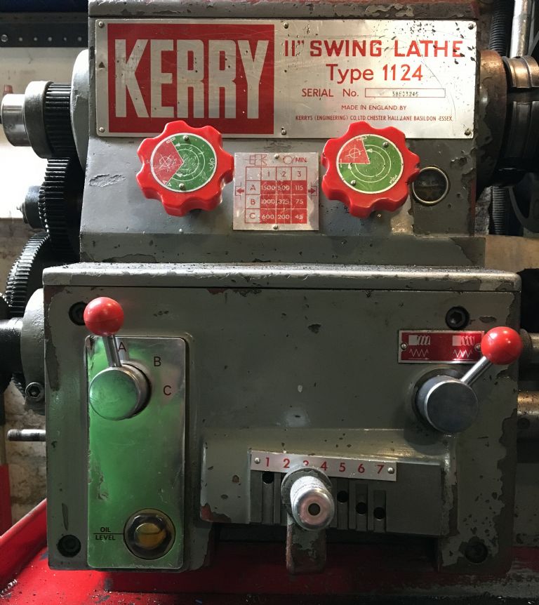

                              Every lathe I have seen a 3-position lever on, the lever has been for 1x 2x 4x feed/lead rates, so you would set gears for 1mm, 2mm, 4mm pitch (according to the lever position), or otherwise 0.75, 1.5, 3mm pitch, if you follow me.
                              You'll need the appropriate gears for the end cluster. Do you have those? If so, providing the stud gear, gearbox input gear tooth counts plus what other gears you have would help towards building up a table of change-gears for various threads.
                              EDIT: does your machine perhaps resemble anything on this page?

                                      Yes, Pete Rimmer, you are quite right, as you suggest, the ABC control translates into 1 x, 2 x, 4 x feed
                                      (based on measurements with a digital RPM meter)
                                      What I haven't quite worked out yet is what change gear options there may be. There were no additional gears supplied when I bought it .
                                      As far as I can see pitches of 0.5mm, 0.75mm, 1mm, 1.5mm, 2,0mm and 3,0mm are possible with the existing setup, but not 1.25mm or 1.75mm

                                        Andrew, the photos in your album show a lathe with a full screwcutting gearbox. Is that your one?
                                        The lever being 3-position rather than 2-position is probably due to the machine being metric rather than imperial, I would guess.
                                        Edited By Pete Rimmer on 01/12/2019 12:31:36

                                            Andrew, I had another look at your photos and you have a 127/100 compound gear in the end train. With your 4mm screw this can only be because the previous owner was cutting imperial threads on the metric machine. Perhaps he also changed the cross-slide screw for an imperial one because he preferred to work in imperial.
                                            Perhaps the missing screwcutting chart is due to him having an anathema to the metric system, just as my father did (though he would never vandalise a machine because of it)?
                                            In any case, if you want to revert to all-metric it would not be too difficult requiring only the cross slide screw replacement and to re-arrange the end-gearing back to how it should be (or to what works). If you wanted to build a screwcutting chart for metric and/or imperial that would not be difficult either, but it will take a bit of input from yourself as to what gearing options there are to work with.

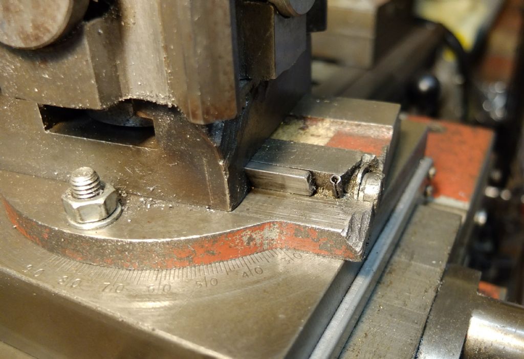

                                                The top slide damage is a common occurrence, especially with no overhang toolposts such as a Lantern type.
                                                It does not affect the performane of the lathe in any way – i would just dress it out & smooth it up with a file.

                                                  On the Kerry, that damage does make a difference. It is a wedge type gib strip held endways by the mangled screw you can see in the photo and another at t'uther end. Someone has then drilled in a roll pin to hold it as a repair, but the gib strip cannot now be adjusted.
                                                  Three ways out as I see it:
                                                  • Get the base casting built up with weld and machine back to original. Could be tricky to machine the weld back and blend well enough for a machine slide.
                                                  • Shorten the base and re- drill for the gib strip screw. Will leave you with a little less support, but probably fine.
                                                  • Make a pattern up and get a new base cast. You might be very lucky and find a foundry that would work from the knackered base if you build it up with isopon or similar, but they are a rare thing these days.
                                                  The upper top slide casting is easy, you can hack that out of continuous cast bar – don't ask me how I know that.

                                                    I would repair that gib adjuster by counter-boring the adjuster hole deeper and making a new adjuster screw, trim the end of the gib to suit.
                                                    #439857
                                                    Clive Foster
                                                      @clivefoster55965
                                                      Agree with Pete about boring the adjuster hole a touch deeper to give a clean seat for the screw. However I'd clean up the end of the gib and carefully weld an extension on to take the adjuster screw engagement slot.
                                                      Done right by welding both sides with suitably low currents and a bit of peening whilst it cools to counteract the bending stresses the extension ends up essentially straight. Dont try to straighten it if it is a bit wonky. Excellent chance of distorting the gib.
                                                      Just carefully file the extension until the shape is close enough that it fits in without binding. The area covered by the extension contributes vey little to overall stiifness so a thou or three clearance just there matters little.
                                                      I'd probably attack the main casting with the welder too and work it back to the right shape. But I have form for doing such. Realistically a bit of metal loaded filler to hide the distress is a more sane way of dealing with things.
