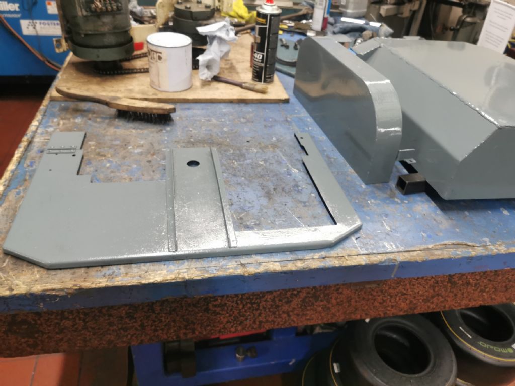

          Latest update i have just got around to sorting the J&S out beed delayed with work and health issues but i have removed the pump and motor emptied the oil tank and cleaned it all the tank is very rusty in places and with the cleaning has shown up a few pin holes that i will weld a plate over. my main question is does anyone know of a paint that i can paint the inside of the tank with like an epoxy or similar that will be ok with the hydroolic oil and help as a sealer?

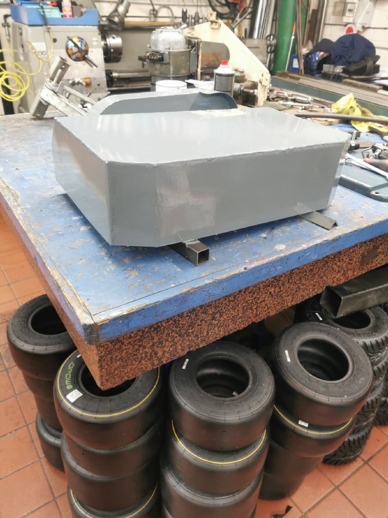

              Right next update is when i toog the grinder to the tank to clean it up loads of pin holes appeared so i cut the bootom off the tank and replaced it with some new 2mm sheet left it overnight with Kerosean in it not damp spots or drips in the morning soi have just painted it with machinery enamel as this seems to be what was in it from new just have to take the bed off now and clean out the gallerys and slides.

                  Hi Bob nice to see you are still working on the grinder, how about a few pictures. I have seen many tanks on these with holes in. Any coolant, which is made by mixing water wuth soluble oil , gets into the tank and it sinks to the bottom of the 32 grade hydraulic oil which floats on water. The coolant deteriorates and causes rust to eat through bottom of tank. I have used a resin 2 part paint to court the entire inside of the tank and that after shot blasting first fills any holes and proofs against leaks.

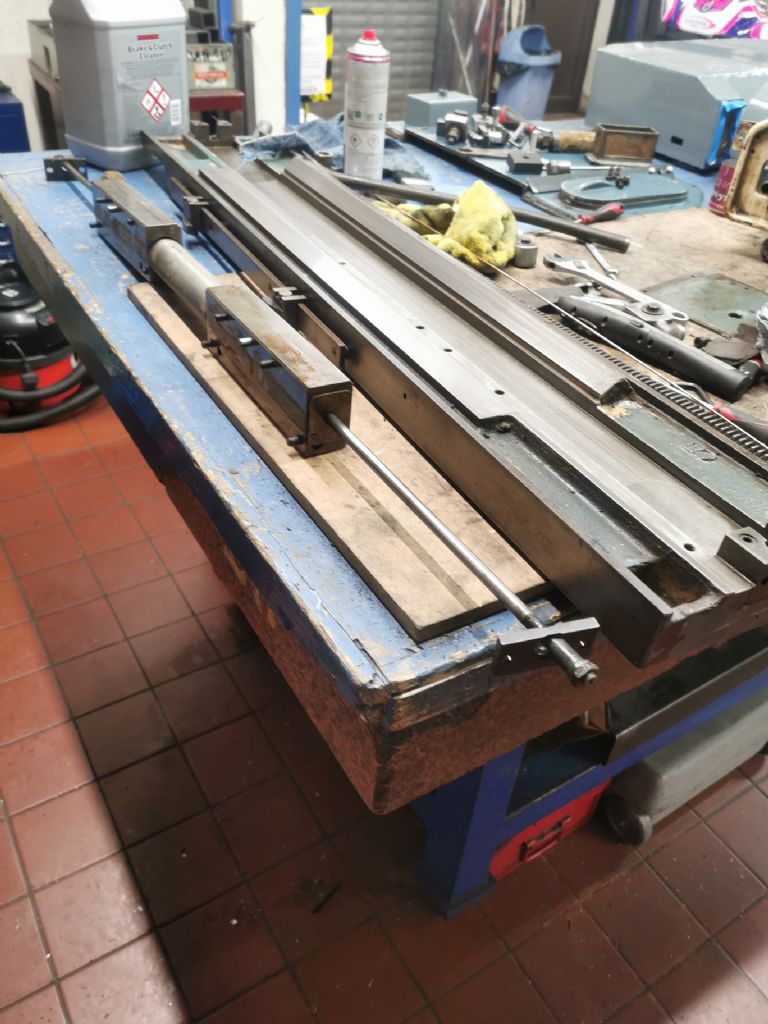

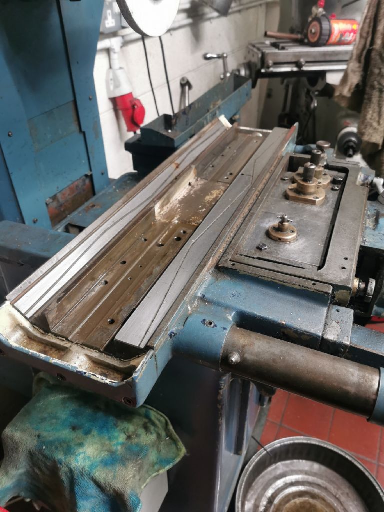

                    img_20210108_140525_resized_20210108_020643112.jpgimg_20210108_140515_1_resized_20210108_020643303.jpgimg_20210108_140509_resized_20210108_020643481.jpgI have now painted the tank and a few other bits also got it stripped and my son is cleaning everything and poking out all the gallerys also added some pictures for David who has been a massive help with information this i am gratful forimg_20210108_140551_resized_20210108_020642904.jpg
