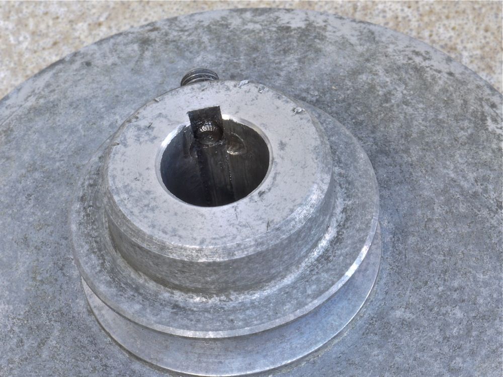

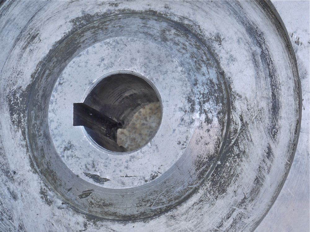

                                    For info … [see my earlier post]
                                    Here are some pics of the pulley and motor shaft from my recently purchased [secondhand] ML7-R
                                    The damage on the motor shaft [and the consequential damage to the bore of the pulley] is obviously down to the absence of a key … but the scuffs and digs on the pulley suggest that it has been removed before; so I still don't know how it was originally assembled.

                                      Michael, as you can see in your pictures the grub screw sits almost on the edge of the key, which is missing in your pictures. When you tighten the screw you have to make sure the key is in the correct place under the grub screw and the pulley is lined-up accurate otherwise the pulley will work loose during use. Tightening the grub screw is much hampered by the belt gard back plate. Niko.

                                        #162928
                                          Posted by speelwerk on 07/09/2014 14:00:45:
                                          Michael, as you can see in your pictures the grub screw sits almost on the edge of the key, which is missing in your pictures. < etc. >
                                          Thanks, Niko
                                          Yes, that's what I was pointing out …
                                          What worried me was when Ted [john fletcher 1] indicated that he has seen several like that. … suggesting that it may have become "standard".

                                            As far as I know they all should have a key held in place by the grub screw, but as Ian S C has pointed out placing it on the edge is not how it should be done and I can understand they get missing over time. You can improve it a little by rounding the underside of the key so you can push it further in the key way of the shaft. Niko.

                                              In my opinion, that’s been butchered by a previous owner who lost the key. I’d clean the shaft up with a file to lose the burrs and and then look at getting a replacement key. It would NOT have left Myford like that.
                                              #162948
                                              Chris Trice
                                                @christrice43267
                                                … and the burring on the edge of the shaft slot is why you struggled to get the pulley off.

                                                  Posted by Chris Trice on 07/09/2014 18:23:51:
                                                  In my opinion, that's been butchered by a previous owner who lost the key. I'd clean the shaft up with a file to lose the burrs and and then look at getting a replacement key. It would NOT have left Myford like that.
                                                  Chris,
                                                  " I'd clean the shaft up with a file to lose the burrs "
                                                  That's exactly what I have just done … but it doesn't explain Ted's observation.

                                                      Unfortunately, it's not going to be a simple job after all
                                                      The motor shaft has cleaned-up nicely, but the hole in the pulley is bell-mouthed. presumably because it's been rattling … all very frustrating, but I shall probably leave it for now: I can re-bore and sleeve the pulley when I fit a 3-Phase motor.
