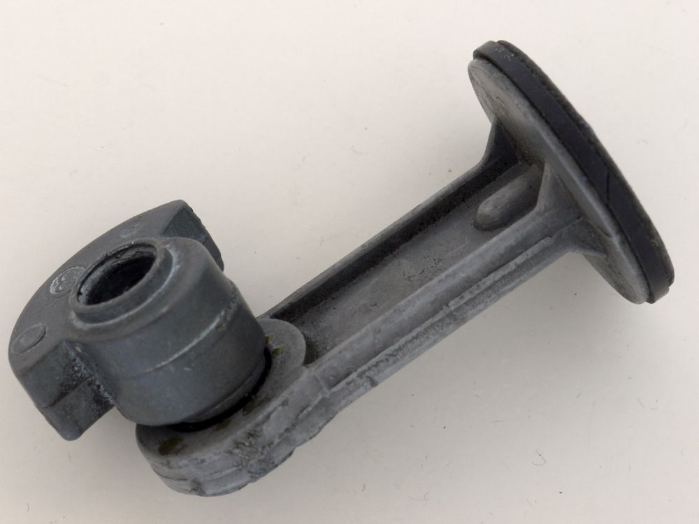

      I am trying to rebuild a small air/vacuum pump
      It's like a mains-powered version of the popular tyre inflator, and was rather better built. … until someone had a go at fixing it.

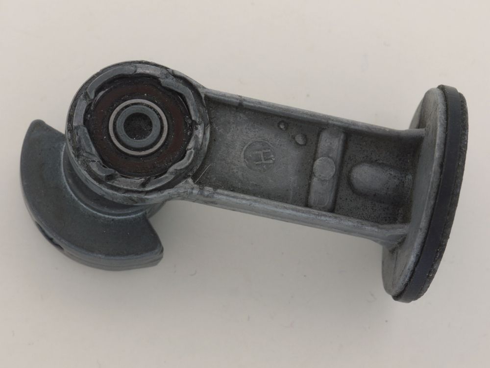

      The big-end bearing appears to have about +/- 10 degrees of angular play, but most of that is in the housing !!
      A few drops of Loctite 'Bearing Fit' would probably have fixed the original problem … BUT the genius technician decided to do this instead:
      crying 2 … Yes, folks … it's been 'staked' or 'peened' … or some-such … crying 2
      This is going to be an interesting restoration
      Edit: for scale … the bearing is 1/4" bore

            Nothing really wrong there,it,s just a different approach,they call it GUNTERING
            #373917
              Posted by larry phelan 1 on 30/09/2018 10:07:57:
              Thanks Larry – another new word learned. I must remember not to use it in front of mother…

                Looks a bit thin in the wall to bore and bush. Brass shim perhaps?
                Or machine a replacement from solid, then you'll know that it's right.
