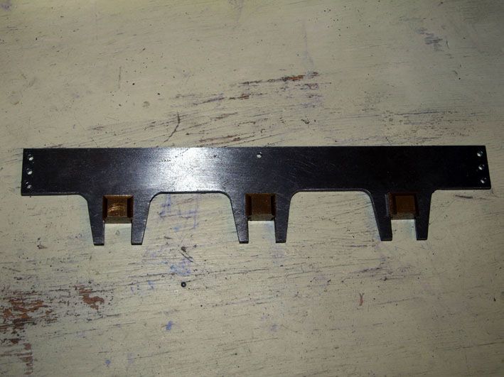

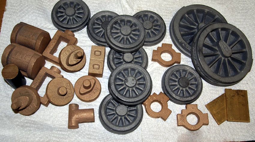

                                            Well Ive started. Reason for the 8 little wheels? I decided to make a 6 wheel tender, hence the long sections of frame steel in the second picture.
                                            PhilH

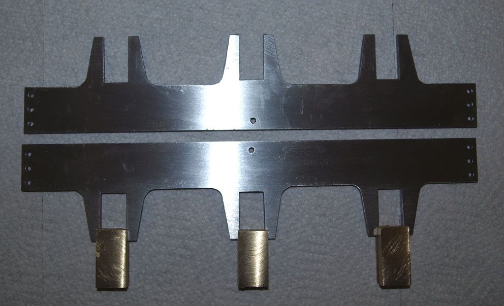

                                                  A weeks spare time has ended with the tender frames. A good few hours of hacksawing, filing and a bit of milling. They just need to be polished a touch. Also shown are the embryo axleboxes.
                                                  PhilH

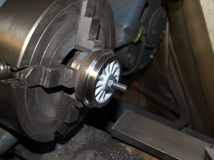

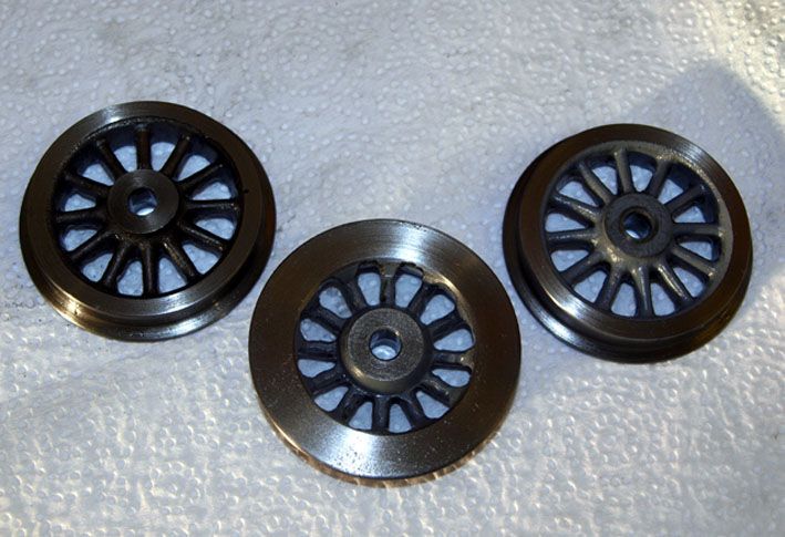

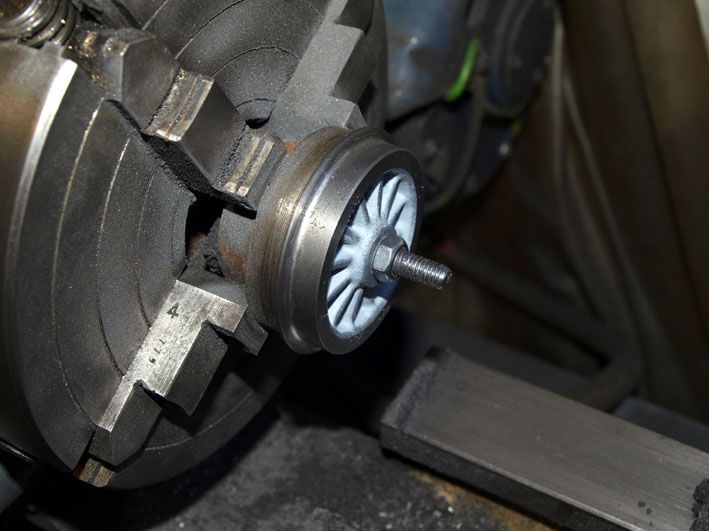

                                                      Well its December so I thought I should at least report in to show the small amount of progress on the tender.
                                                      This first shot shows the machining set up for the wheels.
                                                      Wheel being machined

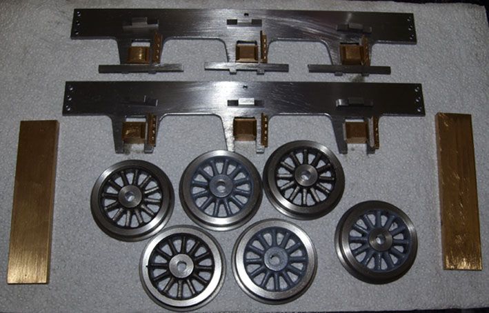

                                                      The finished wheel below;
                                                      Finished wheel
                                                      One of the frames with the partly machined axleboxes;
                                                      Frame and axle boxes
                                                      Three of the finished wheels. Note that the spokes at the back of the wheels still need a small amount of polishing so that they look as smooth as the fronts.
                                                      Wheel set
                                                      The final shot showing all the components as they stand. The spring retainers need to be drilled and polished and the horn stays need to be drilled and split in half. You might also notice the expensive brass option for the frame stretcher/ buffer beams (at least it helped to save the 6BA tap) and I have decided to machine some 1/4" brass angle to fit as axlebox horns.
                                                      Tender parts so far
                                                      Its slow going but at least it is moving forwards.
