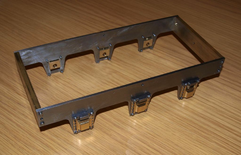

        #108079

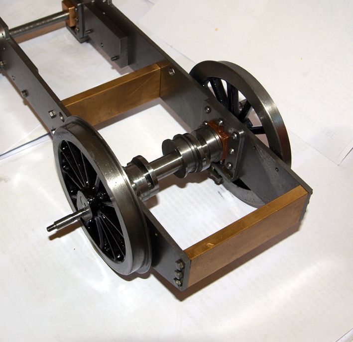

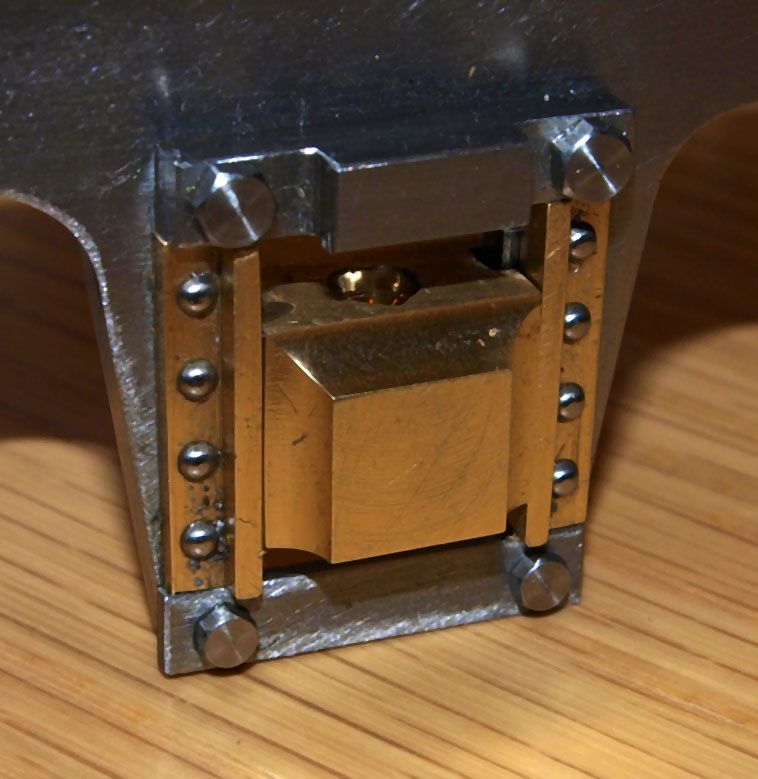

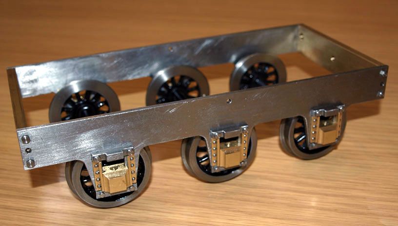

        Phil H 1
          @philh1
          The chassis virtually complete – just the axles and couplings to be machined.
          Close up of the axlebox
          PhilH

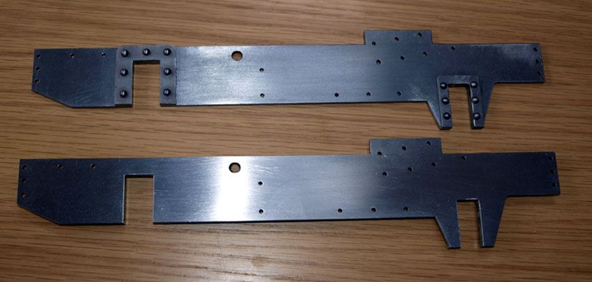

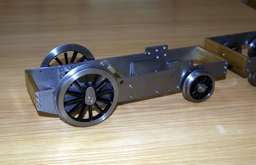

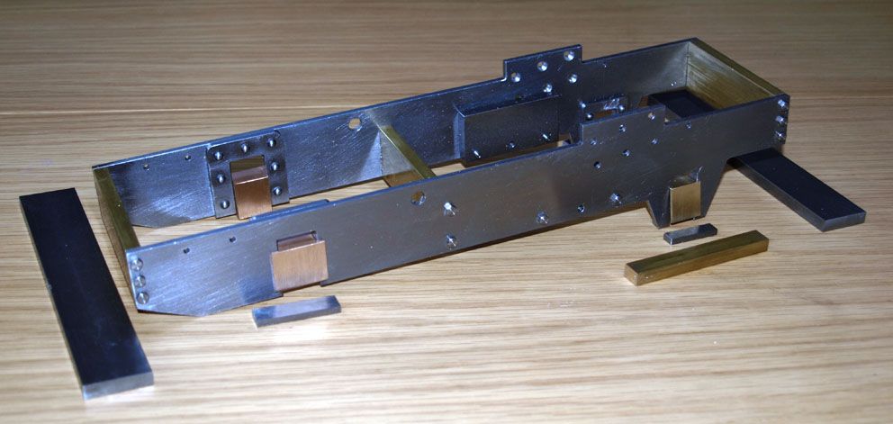

                          Phil H 1
                            @philh1
                            I have now started the engine.
                            PhilH
                            #154505

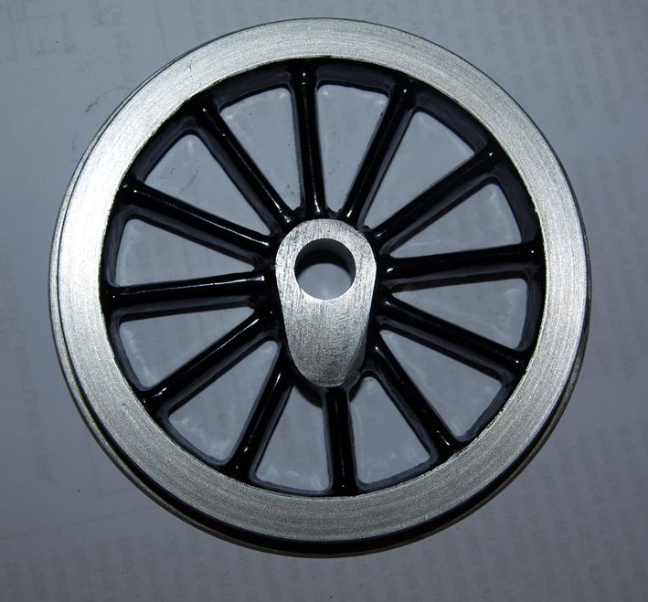

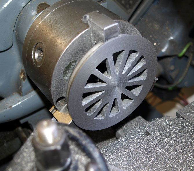

                            Phil H 1
                              @philh1
                              northumbrian23rdmay2013 008 - copy.jpgnorthumbrian23rdmay2013 011 - copy.jpgCurrent status. Not so clear on this shot but one of the wheel castings had a defect in the bore. One option was to bore the defect out and add a bush. The second option was to bore most of the defect out and adjust the axle parts. I took the second option.
                              #154522
                              Jeff Dayman
                                @jeffdayman43397
                                Looks great so far Phil, nice job. JD
                                #154562
                                doubletop
                                  @doubletop
                                  Phil
                                  I agree with Jeff Its looking great
                                  Pete
                                  #154569
                                  Eric Cox
                                    @ericcox50497
                                    I took the first option, bored it out and fitted a bush. I used a set of soft jaws machined to suit the driving wheels and just managed to fit the wheels on a conquest super lathe, 80mm chuck.
