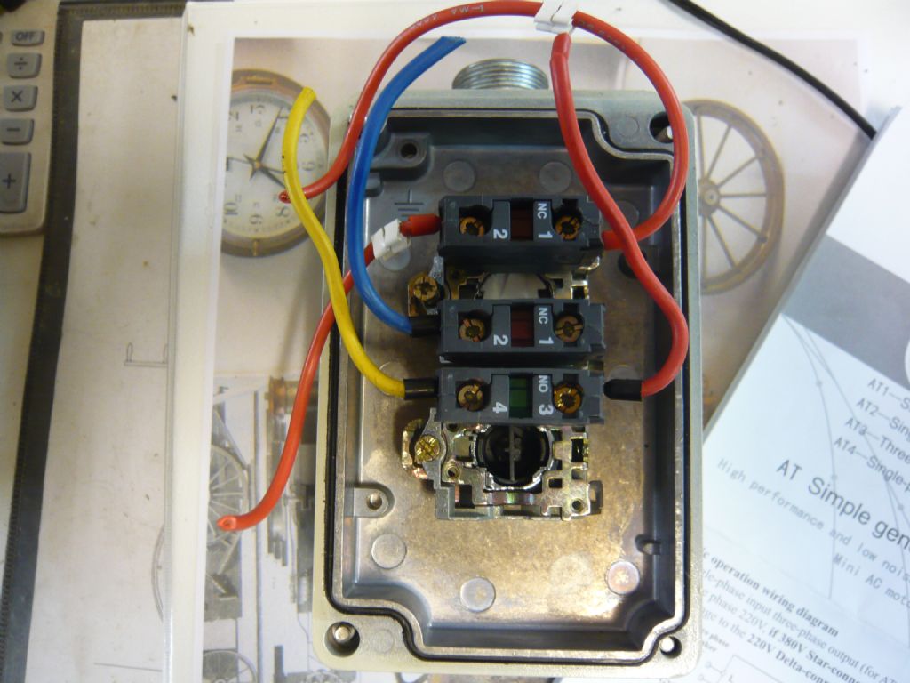

                                          Just to clarify what I'm up to; the machine is a Tom Senior Major Mk2 milling machine that was once owned by the Boots company. It was fitted with a number of safety switches on every door, all connected to a huge box of tricks to control them. All of which have now been removed and I have bought an inverter rated at 2hp (1.5kw).
                                          A previous query on this excellent site will enable me to wire the inverter to the 3ph motor but I wondered if a remote emergency stop button might be a good idea, especially as I have a box with start and emergency stop buttons.
                                          This box has 2 switches marked Telemechanique 240V under the stop button which is the type that locks down and has to be rotated to release, and a single identical switch under the start button. Being a miser it would be nice if this could be reused but I would need guidence on the wiring.
                                          Brian
                                          #436325
                                          Emgee
                                            @emgee
                                            Brian, check your VFD manual for the remote Stop/Start circuit.
                                            if you have a separate drive for table traverse that should also be connected to stop if the Em stop is operated.
                                            You may be able to add a second NC (normally closed) contact block on the Stop function.

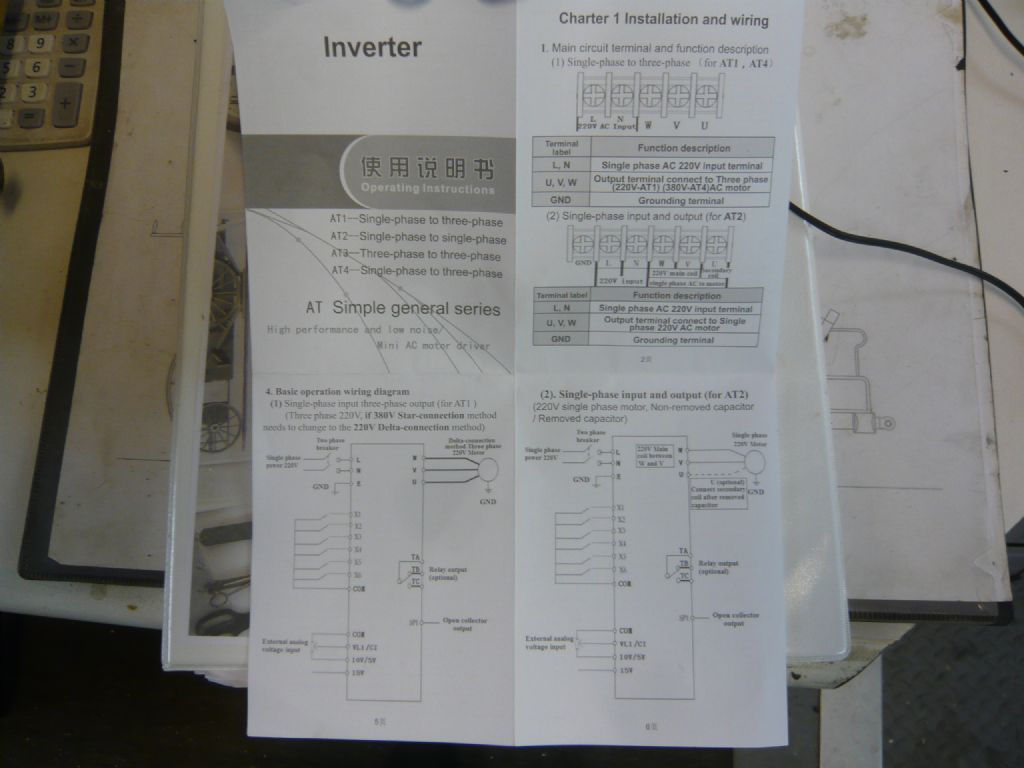

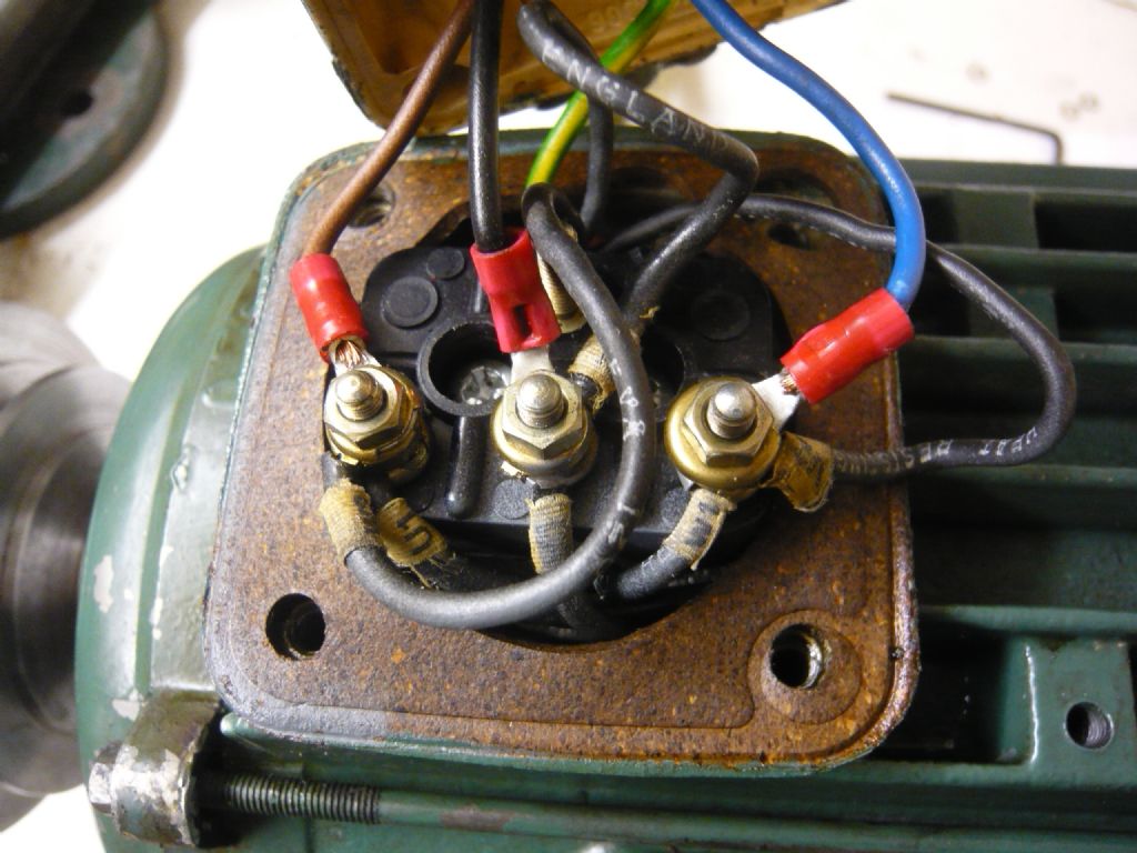

                                            #436340
                                            Brian H
                                              @brianh50089
                                              Back again, this time with pictures!
                                              I have now rebuilt the electric motor (a Crompton Parkinson 1.5 kw one) and have relaced both bearings after finding one siezed due to rust.
                                              I am now ready to test the motor before fitting it back in place in the base of the mill.
                                              I think that I have followed the instructions given previously but would be grateful for confirmation that I've got it right.
                                              I left the U,V, W wires in place and then placed vV2, W2 and U2 over them. I then added the connections to the inverter.
                                              The inverter instructions follow;
                                              The rear of the proposed start/stop controller is next and if someone can advise where to wire this in then I would be most grateful.
