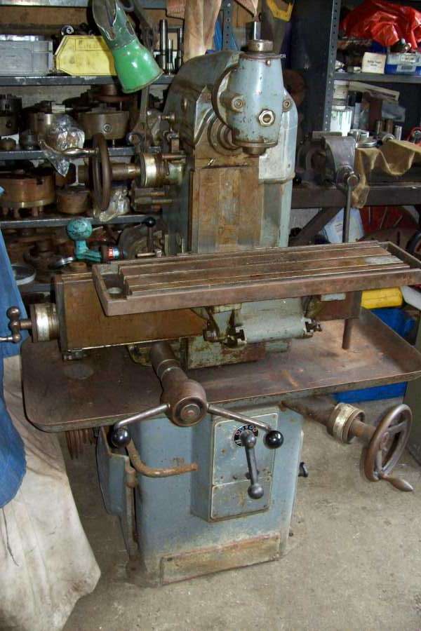

                This is the machine, looks dreadful in the pictures but been stored well greased for nearly thirty years, previous owner bought it from his employer but had no 3 phase so never got around to using it. The protective grease has done it’s job well but is an absolute horror to remove, should keep me amused for a while. Underneath the grease and grime it is in great condition, a friend who is a dealer put me on to it as I’m the only person he could think of that is mad enough to take it on! Can’t wait to make a start.

                  That’s a lovely little machine.
                  Get a gallon of duck oil and another of brake cleaner. from the auto parts store. Mix it up about 20% oil 80% brake cleaner into one of those pressure pot sprayers you can get for about 15 quid from motor factors. spray that onto the cosmoline grease and let it do its magic for a minute, wipe it off with scott blue workshop towels or rags. If it’s stubborn take a 1.5″ paint brush and cut the bristle down to between 3/4″ and 1″. Makes for a great little scrubbing brush for degreasing grubby machine parts.
                  This makes a great cleaning/degreasing spray for your machine tools and is also good for keeping condensation at bay to stop your surfaces rusting. If you use neat brake cleaner you might invite rusting especially this time of year.

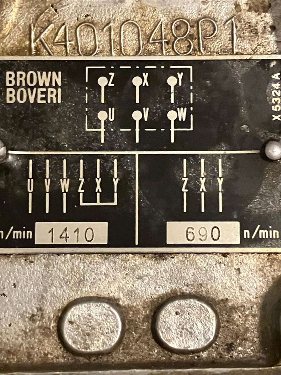

                          Back to the little mill. i ran it up today on my rotary phase converter and it does run very well indeed, but looking at the motor pully was confused as it really didn’t seem to be running at 3000 rpm as stated in the manual. I can’t see a motor plate on the outside but taking off the terminal cover it shows the motor connections and states the motor speed to be 690 and 1410 RPM, a bit of googling shows some earlier machines did have this lower speed range, so mine must be an early model. Another question (sorry) would it be possible to reconfigure this motor to run in delta on a 240v inverter, or alternatively if buying a new motor should I still buy a 4 pole as recommended before? Any advice much appreciated.

                            The motor has 6 windings, 3 pairs. For low speed each pair is in series and the 3 are wired in Delta. For high speed the pairs are connnected in parallel and the 3 are wired in Star. This gives the higer voltage . around 400V as well.
                            For Low voltage, 230V you can connect the pairs in parallel  and then the 3 pairs in Delta. This will of cours give you low speed. The VFD running at 100Hz will give you high speed.
                            Six windings is 12 “ends”. You only have 6 terminals with two ends on each terminal. This does not allow the desired connection. So you will have to split out the connections. This is easy if there are two wires on the back of each terminal stud. Not easy if the connections are at the windings.
                            So first hting is to look at the back of the motor terminals to see how many wires there are.
                            A photo would help.

                              Thanks Robert, that’s what I was hoping, I’m away during the week but will post some pictures next weekend.

                                Short answer is no, you can’t just re-configure a pole-changing 2-speed motor to act as a delta-wound motor. What you can do is strip the thing down and find the winding ends then permanently re-connect the 12 ends to create a delta configuration which is what I have done on my TOS mill but you can’t just do it at the terminal block and it’s not as simple a matter as finding the star point, it’s quite involved.

                                  Managed to have a quick look in the terminal box of the motor this morning and there are definitely only six wires connected, so any other connections must be in the windings, impossible to photograph while in the machine, had to use a dentists mirror and torch to peer at the terminal block. I’ve seen your TOS restoration posts Pete, very impressive, at one time I had a Thiel 158 which looks to be very similar, I used it for cutting traction engine gears and some of the heavy machining (great as a horizontal borer) and then sold on to a friend who still has and uses it. Wonderful machine but I ran out of space! I must admit I don’t really fancy poking around in the windings of a 60-70 year old motor, so I’ll order a modern replacement to use with the Mitsubishi inverter I have. Does give the option as Duncan states of going over 50hz to get a little higher top speed if required, looking at the workshop manuals the mechanical arrangements are the same in the earlier and later higher speed machines.

                                    As the winding ends are not brought out it is likey that there is just a tap into the winding. This will not be easy to locate and bring out as separate connections. Not least because there will very little wire to connect to.
                                    I think you are right to go for a new motor.
