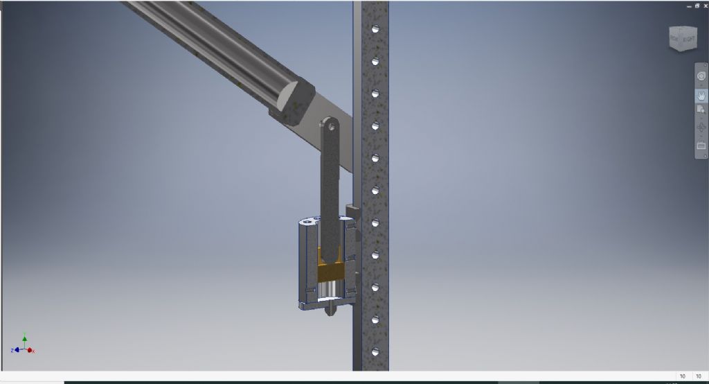

          Well I've drawn up some plans of my own as no one came up with anything!
          The design I've put together looks like it should do the job, I have no injection molding experiance but some knowledge. A friend of mine (also an engineer) used to specialise in injection molding so I'll be running the design and numbers past him and see what he thinks, its obviously going to be a long and crude way away from what he's used to!
          The hand lever arrangement I've designed offers around 3.5kpsi of injection pressure with a relatavily achievable 50kg pull on the handle. I just need to check the stress on several other components as the handle and lever had to be very substantial after looking at the stresses involved.
          I've ordered a pair of temperature controllers, one for heating the cylinder, one for heating the die (as I expect 3.5kpsi of force won't be enough to inject my rather large part into a cold die.
          Once it's up and running I'll make several "rods" of plastic for tensile strength testing and compare strength and cooled size vs die temperature to see if there is much effect on finished strength. I may also connect a loadcell to handle and measure strength vs injection pressure.
          I think it'll be ok, it'll be interesting to see strength vs die temp and how much shrinkage is observed.

                  I have pretty muich done the basic design, it all used either M6 tapped holes or M6 clearance. I haven't made the die support yet as I'm not sure the square column will take the stresses involved as it was much much higher than I anticipated, so I will check the column isn't going to bend or stretch, then take it from there!

                    I would not suggest following ANY advice from ARW about injection moulding. He clearly has no clue about building a safe to operate moulding setup or how to operate it.
                    The Gingery machine has been built many times and does work for very small parts – but a common complaint from builders/users is lack of part to part dimension and strength control.
                    One key aspect of injection moulding machines that people seem to miss is that the mould needs consistent and even clamp force across the whole mould, and the mould and injection barrel need to be kept aligned. Setting a mould loose on the beam of a hydraulic jack press and having the injector cocked at a strange angle under huge force is asking for an accident.
                    To calculate the clamp force needed, to need to find the projected (plan view) area of the part then multiply by your max possible injection force. Multiply that number by two or three and that is how much clamp force you need as a minimum. If your planned parts are large you will be surprised at the forces involved.
                    For any consistency of strength and density in your finished parts, barrel temp, mould temp, injection pressure, heating time, injection time, cooling time (at a minimum) will need to be controlled. Most resins do not do well sitting in a hot barrel between shots either (called "holdup time". Feed resin, heat and shoot, repeat, with no wasted time, with carefully controlled parameters, is the name of the game for consistent parts.
                    If I were you I would look into making a mould or moulds to standard industrial practice and handing it to an injection moulder to run in a commercial injection moulding press. Find and talk to a moulder and he will steer you to what mould dimensions and construction will run in their presses. The moulds are where the art is. Think of it as if you wanted to make turned parts – would you build a lathe or use a ready made one? Good presses are already out there at injection moulding firms. Fewer such firms now in UK and North America than there used to be, but still plenty around.
                    Just my opinion from many years in industry involved with plastics design and moulding.

                      Thanks for the input, regarding clamp force, I had planned on justing bolting the two halves together, as I don't mind making one, then waiting for it to cool, taking it apart and making another, I'm not really trying to brake any speed records, maybe half a dozen in an hours, and I'm happy.
                      The barrel/nozzle are fixed, I'm relying on a brass piston in an aluminium bore to maintain it's own alignment, it's a sqaure piston diameter to length, 25mm diamter, 25mm skirt, I could easily extend that skirt to 30-40mm if I have any problems with rev1.
                      It sounds like I won't be getting the finest quality parts, but I will be testing and gather quite a lot of data and see what works best. I will keep in mind "hold up" time, obviosuly it's a 1 shot wonder, but I don't know how long I need to leave the material in the got barrel before I consider it to be thoroughtly melted and ready to go so given your comments, I'll test parts for strength having given them maybe 2, 4, 6, 8, 10 minutes heating up, see if a sweet spot appears??

                        Hi Russ, You don't mention what type of resin you want to mould. Some resins will tolerate several minutes of holdup time before starting to degrade, and others less than 30 seconds before they start to degrade. (polycarbonate is one example that degrades very quickly).
                        Knowing your resin's melt temperature and using a thermocouple / readout on the barrel would go a long way to knowing when to shoot the resin. If you mount the mould such that it can be lowered away from the barrel between shots, you could fill the barrel with some extra resin than needed for filling the mould, and do a test push on the lever to see if your shot melt is flowable, onto a scrap piece of card or wood or metal sheet. If you see that it is ready, you would raise the mould and shoot it asap. Commercial presses have the ability to pull the barrel and nozzle back from the mould to purge out any degraded material and ensure fresh, ready to inject melt is in the barrel prior to production run starts.
                        Again if you went the route to make only the moulds you need, designed for use in a commercial press, you would not need to worry about many of these things and the mould would have ejector pins to eject your finished parts and be ready for next shot in seconds, rather than having to undo bolts in your moulds. In addition you would have full control of your process temps and timing to control your parts' mechanical properties.
                        BTW mould shrinkage varies with resin type as well – you can google resin brand names through Matweb.com to find the general shrinkage factor for mouldmaking.

                          Hi Russ, one further note – getting your piston out of the barrel to reload resin, if the piston is loose and not joined to the connecting rod to the lever, is likely to be a real pain and a sticky mess depending on the resin used. Getting everything clean enough between fills will also be difficult. In any case I would suggest having the piston joined to the lever so you can use the lever to get it out while hot.
                          Again using an injection moulding press eliminates all the faffle above and will result in much better part properties. The moulder will also likely share a huge amount of plastics expertise with you in your first discussions about the parts you plan to make.
                          I suggest getting someone you know to make 3D printed models in full size of the parts you plan to make, and if you visit a moulder or moulders take them with you as well as info on what resin you would like to use.

                              Jeff, the piston is connected via a gudgeon pin, you can't see it in the screenshot as it's the same colour as the conrod, I just modelled the one in for stress anaylsis, the opposing pin will obviously feature equal and opposite stress. The head of Cylinder is flat and removable to aid cleaning when the jobs done.
                              I have one of the finest, if not the finest FFF 3d printer on the market so I can print the model myself. I'm looking at a small 6mm pipe connector with a 1-1.5mm wall thickness. We're looking at about 55mm total length, the most difficult part I want to make is a 4 way cross.
