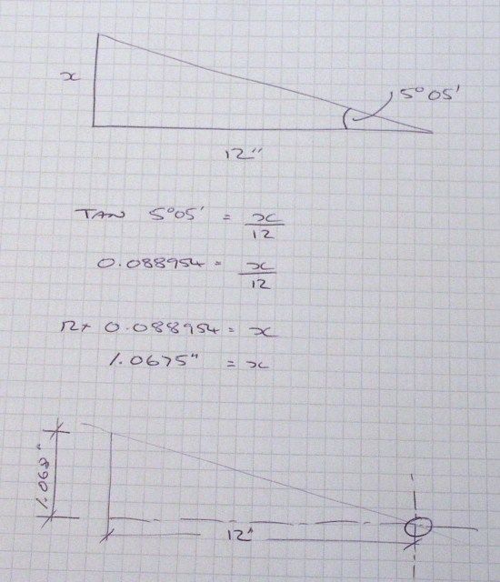

                  You may not need to measure the angle, it could just be there as a check. If the position of the cylinder is shown as a distance from the axle and height above it you don’t need to measure the angle.
                  You can also use trig to mark the angle onto the frames, measure say 12″ from the axle and 1.226″ above it and join this point to teh axle centre line, that will give you your 5 deg 05′.

                      I’ll post a sketch later

                        #71358
                          Well it always pays to write out your calculations, for a 12″ length the rise at 5deg05′ will be 1.068″ not what I said earlier.
                          As you can see we know the angle and can choose a length, in this case 12″. Using trig we work out the the opposite side to the angle and get 1.068″.
                          So rather than use a protractor, angle gauge or similar to mark the angle just measure along the frame 12″ and up 1.068″ and draw a line through this point and the axle center line. If there is not room for 12 ” then use say 6″ and 0.534″ rise or any pro rata sizes.
                          Sine plates would be another way but use the same principle of a known distance and a rise that is set by packers to give the angle.

                                Something is escaping me. Last night I tried to score with measures that gave JasonB, but where it crosses the line with the center point is far from the point that drawing. As I have a protractor to measure and tried in this way is more nearly in point. It was too late and was tired, not to repeat the calculations, I’ll try again tonight.
                                JasonB how to get the value 0.088954 and R?
                                Armando
                                #71403
                                  If you enter 5.08333 into a your calculator and then press teh TAN button this will give you 0.88954.
                                  Its my writing thats not an R its 12 eg the 12″
                                  My sketch is not to scale teh angle will be less than I have drawn.
                                  J

                                      Yesterday I went back to try to set the angle. As I said yesterday, last night, was tired and did not realize that this scoring less than 12“. Yesterday tried again and it worked properly marked. Thank you.
