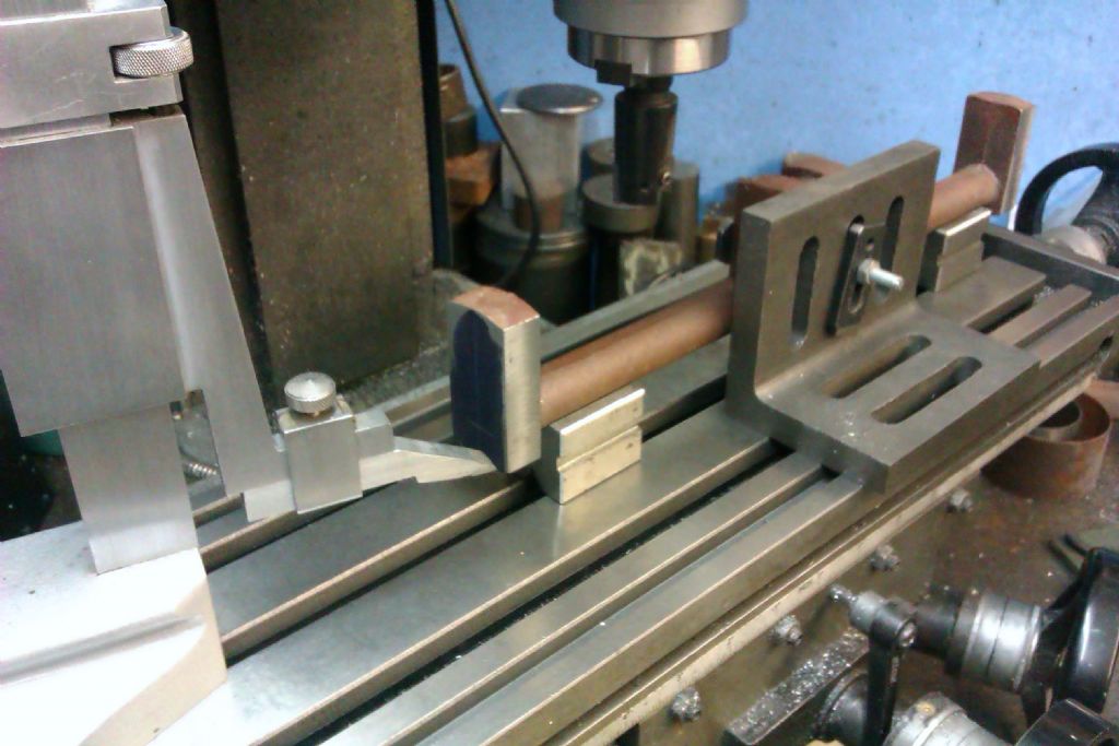

The calibrations on your hand wheels are very accurate, so to mill your grooves across/along a piece of bar you just have to establish your datum edge and the edge of the bar. So the first thing you do is to purchase a pack of cigarette papers (the thinner the better, I have some white packaged ones , must be 20 years old). So stick a piece of the paper on the datum edge, switch on the mill and carefully bring it up until it whips the paper off. Note handwheel reading and direction of travel. Drop the table and wind on the necessary distance, calculate it on a piece of paper. Move the cutter out of the way (right angles to first datum check). restore table height and go ahead. Off course you can use an edge finder, but then you have to allow for the diameter of it, its all too much for my little brain.
The only thing to check is that if you set the datum by moving the table from right to left, then all movements must be finalised by a right to left motion. I actually use white cardboard for my notes (ex Christmas cards), it survives the odd soaking in suds.
