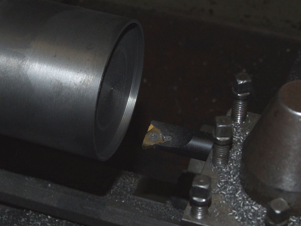

                                    Anonymous
                                      Posted by Ian P on 02/02/2020 22:22:11:
                                      I have just had a quick look for an insert but small sizes of 55 degree ones seem rather thin on the ground and I'm unclear about the what the tip radius is (or how fine a pitch it could cut).
                                      I've recently stocked up on 32tpi and 40tpi Whitworth inserts from Cutwel. Errr, a 32tpi full form insert will cut a 32tpi thread, and the tip radius should be as per the Whitworth thread specification. Here's a short 32tpi Whitworth thread being screwcut in cast iron:
