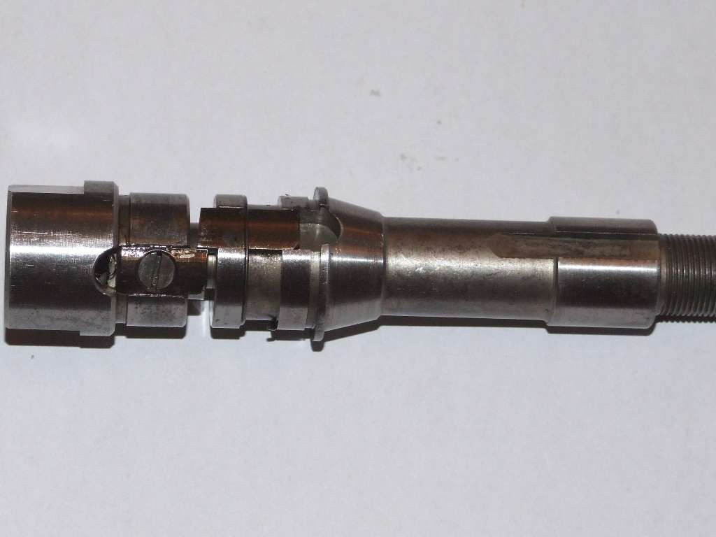

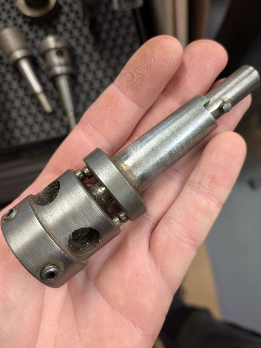

      Hi guys.
      I picked up these die holders with the purchase of a lathe some time ago. I don’t know if I m just being dumb but I can’t understand how they work? The mechanism doesn’t make much sense to me? They have a toothed clutch at the front and a ramped notch at the back.
      They came with a Boxford and I believe they are a genuine Boxford accessory.

        The front dog clutch works when it is being advanced onto the work but quickly releases when you stop feeding it. Then reversing the machine will pick up on the rear one. The ramp ensures the rear clutch  cannot pick up when running forward.

          Same principle as the tap and die holders on the Britan repetition lathe. Very fast in operation, two or three seconds at most per thread.

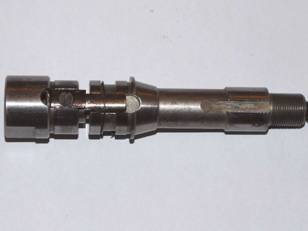

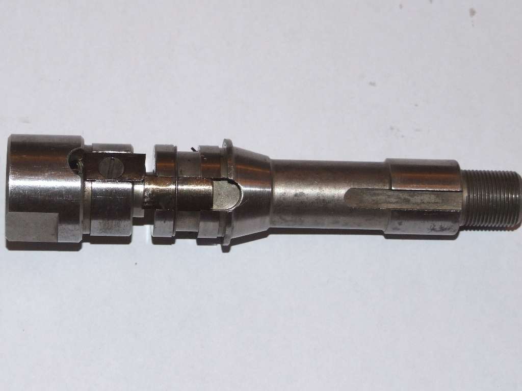

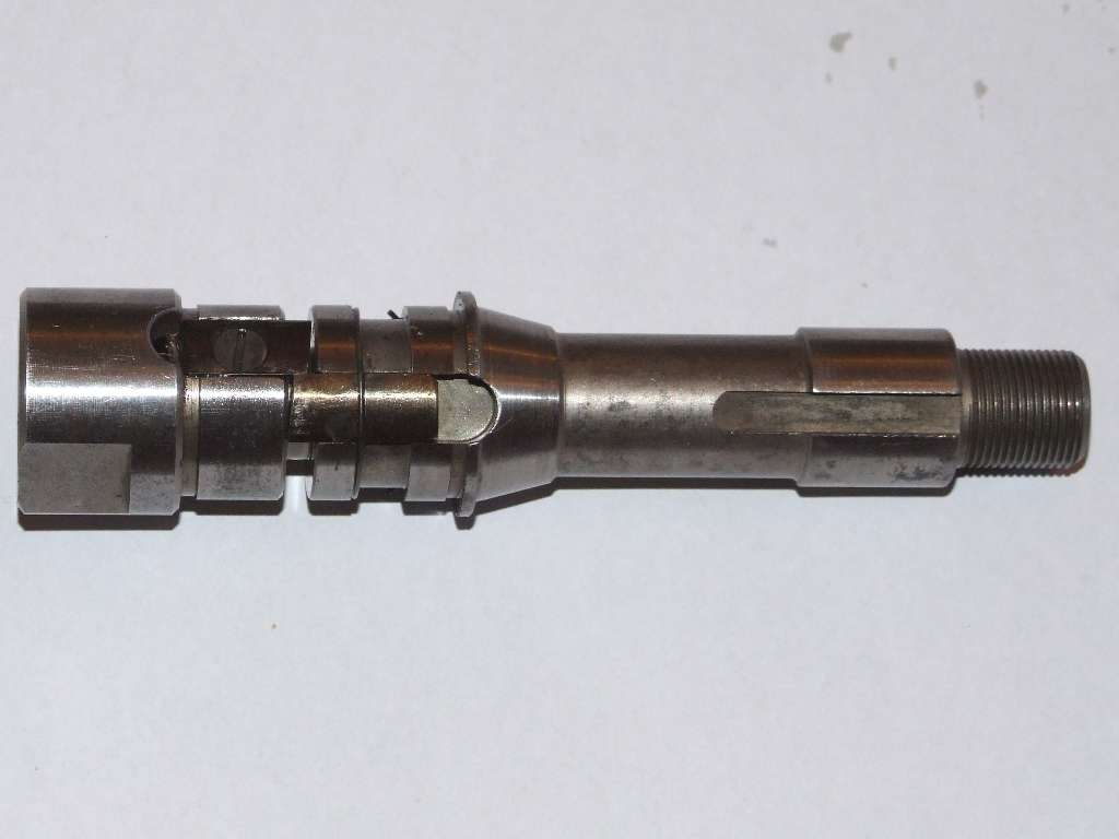

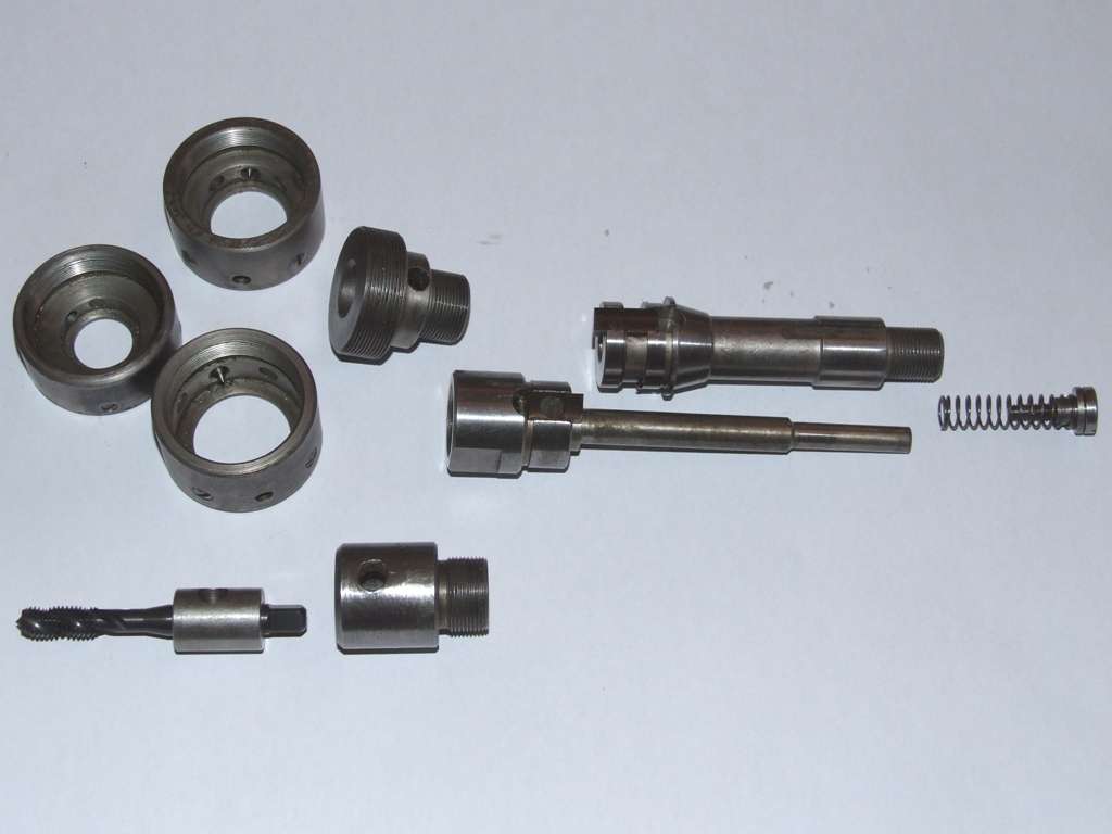

                On the Britan the same style of dog clutch mechanism is used for both dies and taps, just a different holder screwed onto the front:
                Tap_Die_Set
                The sequence of operation is as follows, first dogs driving:
                Tap_Die_Driving
                Once a stop is reached the dogs at the point of release:
                Tap_Die_Disengage
                The dogs slipping, ie, the tap/die just revolves with the work; no feed:
                Tap_Die_Slipping
                Dogs reversing the die/tap after the spindle rotation is reversed:
                Tap_Die_Reversing
                I’ve used the tapping function for making hundreds of custom nuts. The die facility is far less used as I prefer to use the Coventry diehead.
