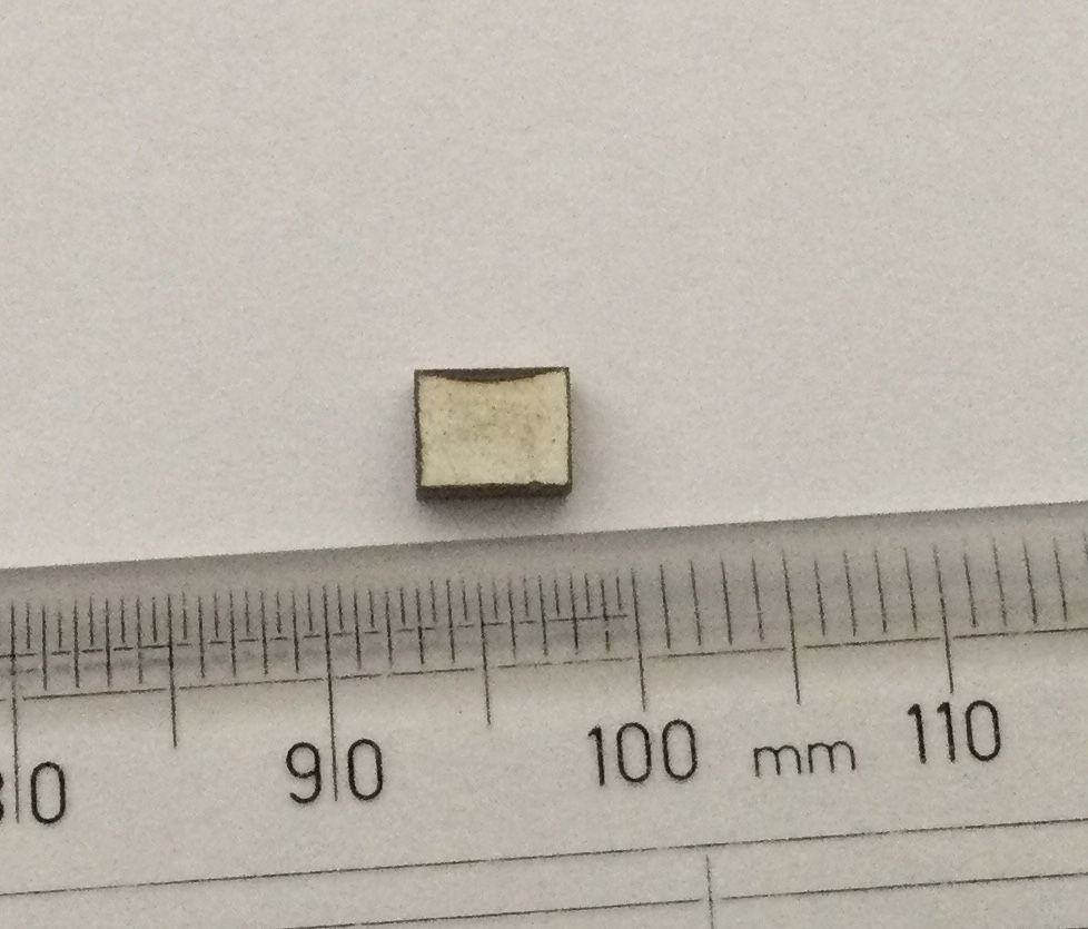

                                I've very recently seen a thermostat that uses what appears to be a ceramic strip with a printed on resistive material that heats up and causes the ceramic strip to bend and open a pair of contacts. Rated at 15 amps as well.
                                If you have ever opened a microswitch, the mechanism looks to be very similar, the ceramic strip replacing the phosphor bronze leaf as in the microswitch.

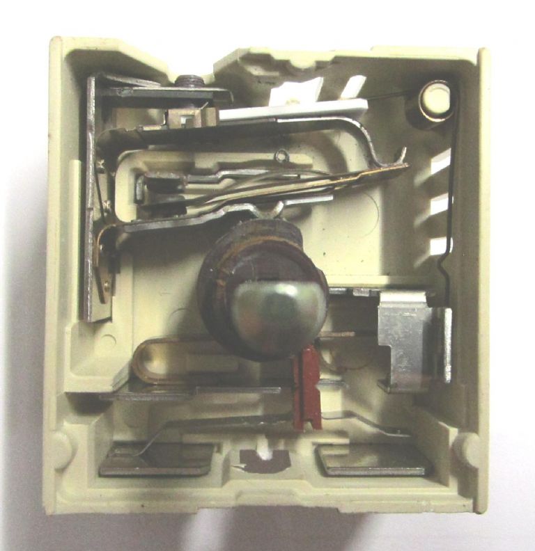

                                          I mentioned earlier that I had been looking at a thermal switch that used a ceramic element to open and close a switch, I've taken some pictures so that you can see the parts and the arrangement of the device.
                                          This picture is an over all view inside the plastic case. The thermal mechanism is at the top and there is an auxiliary switch at the bottom of the picture. The auxiliary switch is not thermally activated it is a straight on/off one.

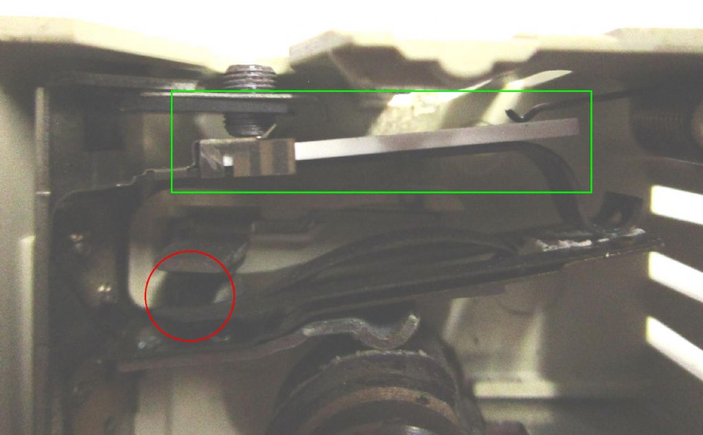

                                          I've outlined the ceramic element in green and the switch contacts in red. There is a spring on the right bearing on the ceramic strip, and an adjusting screw on the left which can be adjusted with an Allen key through the top. I did notice that the adjusting screw is connected to the live mains input ! So this is just for factory adjustment. The cam on the switch shaft brings the thermal device into play.

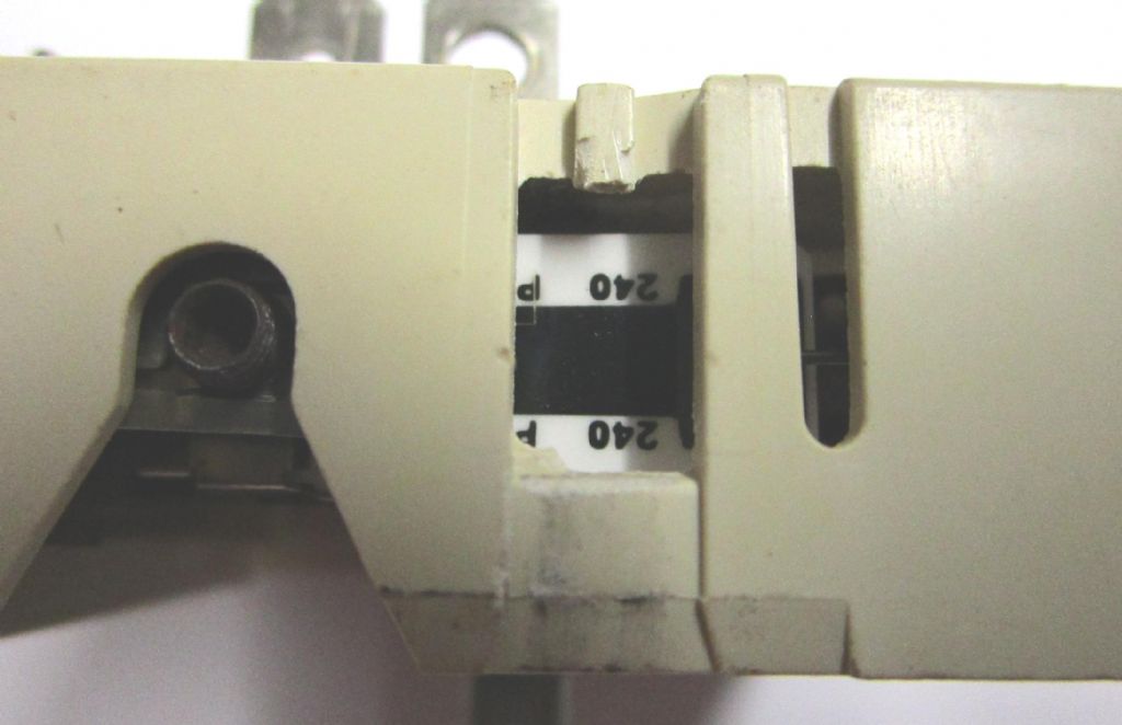

                                          I tried to photograph the ceramic strip. I broke out the bit of plastic so that I could take a picture of it. You can see the voltage rating and the printed resistive element which measures about 15K ohms. You can feel the heat radiating off it after about 15 or 20 seconds. The contacts short the ceramic element out when the switch operates.
                                          Quite ingenious !
