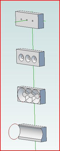

      Hello.
      I try to make Compo the Compound Oscillator ME2520 p.640 as my first model steam engine.
      Then, I am faced with a problem.
      I can't understand a sentence in 4th line p.641.
      "The curved recess is formed by marking down the length of each block, then dividing it into four."
      Which direction I have to divide each block into four?
      Please tell me a little bit more in detail about this part.
      #7902
      Junichi Kobayashi
        @junichikobayashi82080
        #215814
          Top image, divide length into 4 equal parts along the centre line and punch then centre drill each mark
          Second image use 3/16" drill to form shallow indent
          Third Image use 3/8" drill to increase size of previous holes, only drill to depth of drill point
          Last image complete using a round file
