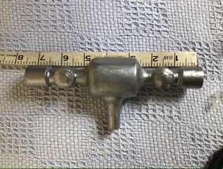

      This is the rear axle for a replica tether car that I am building it an American car from the 1940s
      I want to drill. 3/8” through the aluminium casting of the axle, I have a Myford 254 lathe a Seig x3 milling machine and a pillar drill. The milling machine is not tall enough to do it.
      The hole needs to be straight as it will have a rigid shaft in it support by bronze bearings. Any help gratefully received.

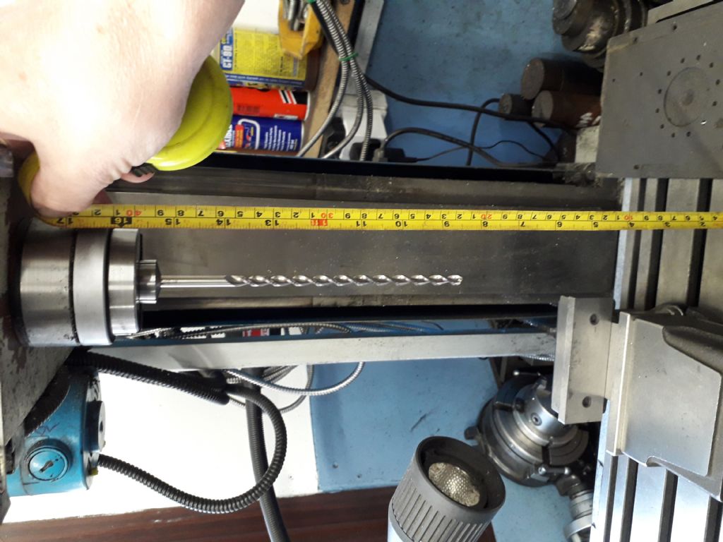

          I'm not sure why you can't drill it in the X3 as I have drilled similar sort of lengths with my X3. You may need to use MT collets and put along series drill into a part drilled hole before moving it under the spindle and fitting the drill rather than having 7" part plus 7" drill exposed but it can be done.
          On the lathe you could use the method of drill in a collet and feed pressure applied by the tailstock ctr in the opposite end of te work, flipping it around so you drill half way from each end, I've done 9" that way..

            Jason it does not have a diff, a solid axle with a bevel gear. On the side you can’t see there is an opening that will be covered with a plate.

              Should be enough height, 15 1/2" under the collet, as said if you need more then drop the drill into a part drilled hole and then lift up into the collet. I'd start with a stub drill to get the hole going with minimum risk of wandering then upto a jobber length, long series and then extra long series though you could save on the last if you came at it from each end but risk them not meeting.
              If the worse comes to the worse the bearings could be set in something like JBWeld with a rod through them to correct any wander.

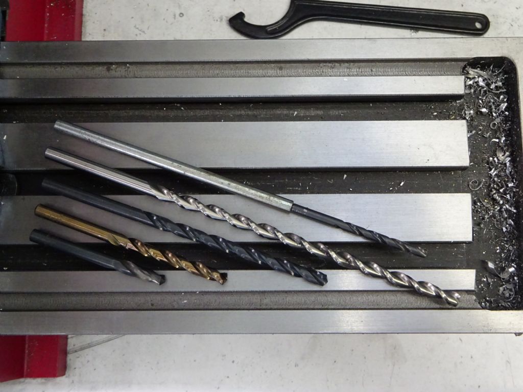

                    Over 6mm they are odd ones that I have picked up at shows, smaller came from ARC. You should be able to get them from MSC or Drill Services.
                    4 lengths of 6mm drills

                                                      The ends cannot be skimmed up on the side you cannot see there is a bracket for part of the suspension also I don’t have a steady for the lathe. So a non starter.
                                                      Its going in the mill
