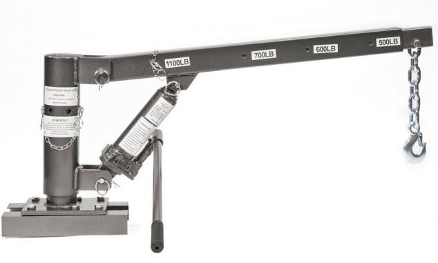

      Has anyone used one of the hoist frames advertised on Ebay. You would normally mount your own electric hoist on the frame. They usually come in several versions, extending and non-extendiing. The assembly is bolted to a 48/50mm steel scaffold pole fixed against your wall. The short one (750mm long) with a 600 Kg load capability and when extended (1100mm long) 200Kg.
      I need to pick up a indexing head (weighs around 67.5Kg) and be able to put in on the table on a Bridgeport sized machine. Problem I have is I have not got a brick pillar close enough. I really need a overall length of around 1.5 metres.
      I am wondering whether if I replaced the extension arm with a longer one what the load capacity would reduce to, and would it be safe. So long as it would take between 80-100Kg.
      The indexer is on a hydraulic table but not always easy to get this next to the machine.

                    Don't see any great issues with extending the arm for the sort of weights you envisage. When putting up my extension the builder and I had mine working hard with the cable doubled and the hoist just outside the strut lifting a 15 ft RSJ. I never dared check the weights but Mr Builder said it would be fine. Scaffold pole support deflected somewhat.
                    Would it be practical to mount the pole in front of the shelves and swing the hoist around when access is needed to the one its normally parked in front of? Might need storage re-arrangment to put the rarely needed things behind the crane. Maybe handy if you have heavy stuff on bottom shelves.

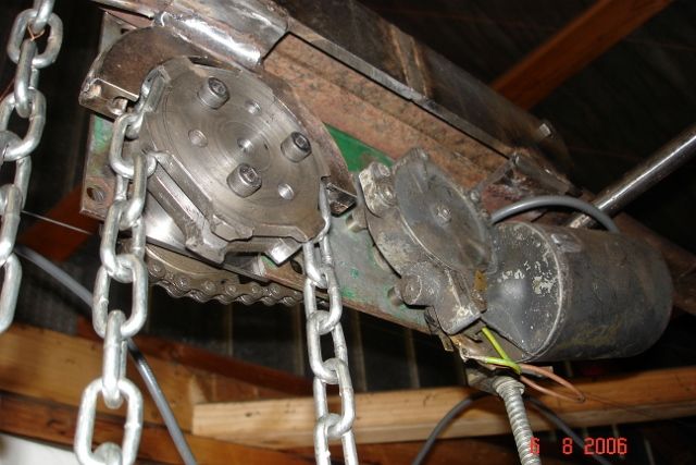

                        dsc00231 (640x427).jpgMy hoist could be adapted to work on a short boom. My set up has a rail made by welding two lengths of angle iron back to back. My hoist is mainly used to lift the 8" 3 and 4 jaw chucks for my lathe, I don't think I would try lifting the 6'" 4 jaw now. The hoist is powered by an old garage door opener motor (36v), but run on the 18v power supply that I use for the power traverse on the vertical milling machine.
                        Ian S C

                          That's what I've got, rail is made from unistrut, at each end I have a length of wood sitting on top of 2 roof cross members, the unistrut is supported from the centres of these timbers, thus any one roof cross member never sees more than half the supported weight. I bought what a friend called a 'jeweller's chain block' light enough to pick up with one hand but 250kg lift

                                              Paul Lousick
                                                @paullousick59116
                                                Colin,
                                                If you are using one of the column mounted hoists as shown, there should not be a problem with lifting 100kg at 1.5m.
                                                The bending moment of listed load at the extended position (neglecting electric hoist) = 1.1m x 200kg = 220 kgm. Your bending moment at 1500mm = 1.5m x 100kg = 150kgm. Therefore OK because less than before.

                                                  Howard Lewis
                                                    @howardlewis46836
                                                    Another thing to bear in mind if extending the lifting arm.
                                                    Extending it may keep the bending moment within your limits for a vertical lift.
                                                    But being longer, it will be relatively weaker in the horizontal plane. This needs to borne in mind, as you do not want the arm to bend horizontally as you swing the load from one place onto the machine, or vice versa.
                                                    Extending the arm by 50% will reduce the horizontal resistance to bending by 70% (BD^3 /12 )
                                                    If there is storage space, I would advocate adding additional reinforcements to each side of the extended arm, to prevent any unwanted risks.
