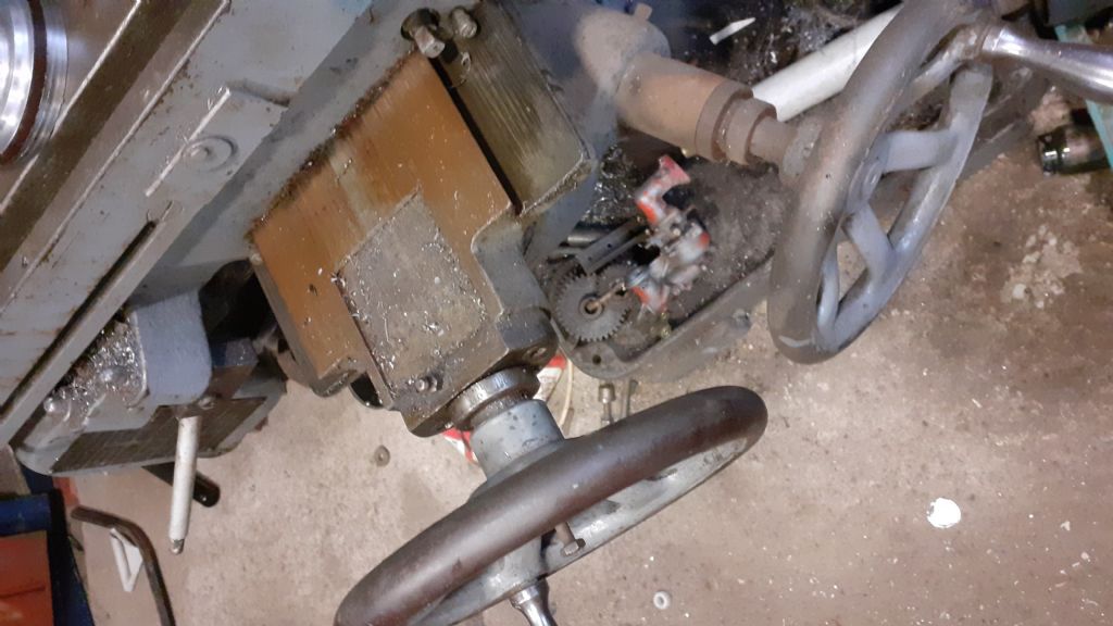

                                                  #503106
                                                  Pete White
                                                    @petewhite15172
                                                    #503107
                                                    Pete White
                                                      @petewhite15172
                                                      I am not sure which casting is broken on your machine, that pic of mine shows the top of the knee mainly, big issue if that is broken .
                                                      Edited By Pete White on 24/10/2020 09:16:54
