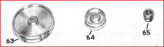

                I note that the MOTOR pulleys in the schematic above are not stepped but I thought this would be simply artistic license. However in the parts pictures, only a slight step is shown as you can see here:
                motor pulley pics from catalogue

                  Ignore that last pile of old nonsense please. I went back into the workshop as I suspected my theoretical large pulley might be a bit of a tight fit in the box. It was! Then I saw the reason why. I had inverted the dimensions of my SPINDLE pulley. With this dunderhead error now corrected, I re-calculate the motor pulley diameters as:
                  A         B         C
                  118.8   59.4   29.7
                  119     59.7    27.5
                  I think we are now much more aligned, and these will much more closely resemble the catalogue part pics.
