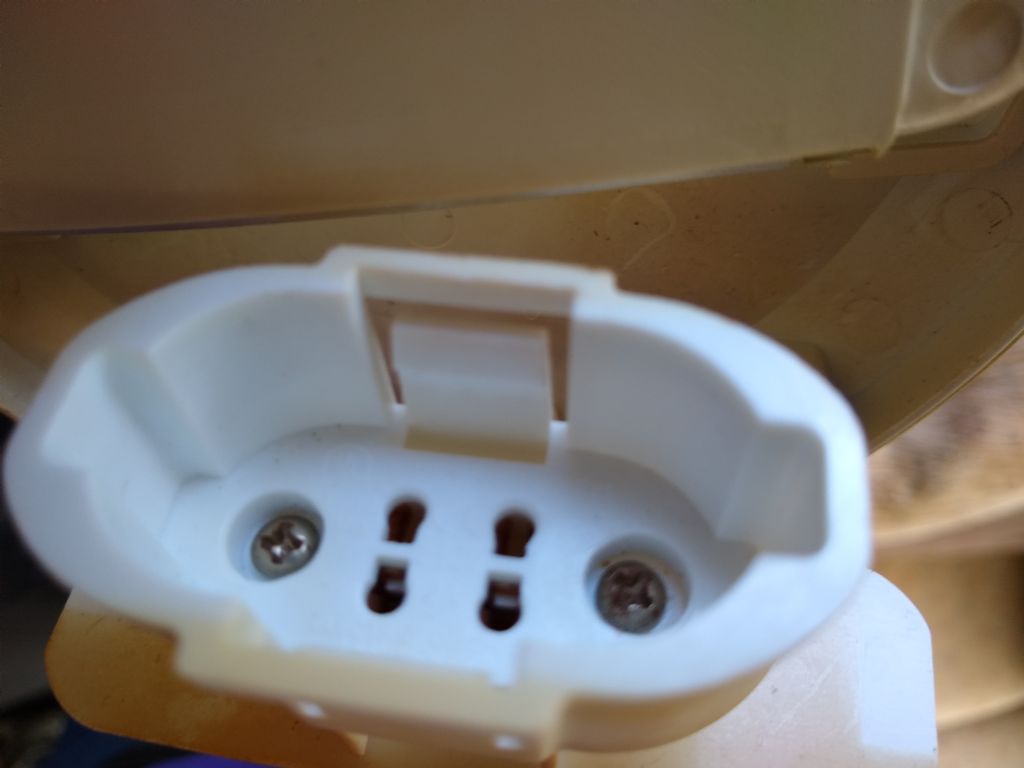

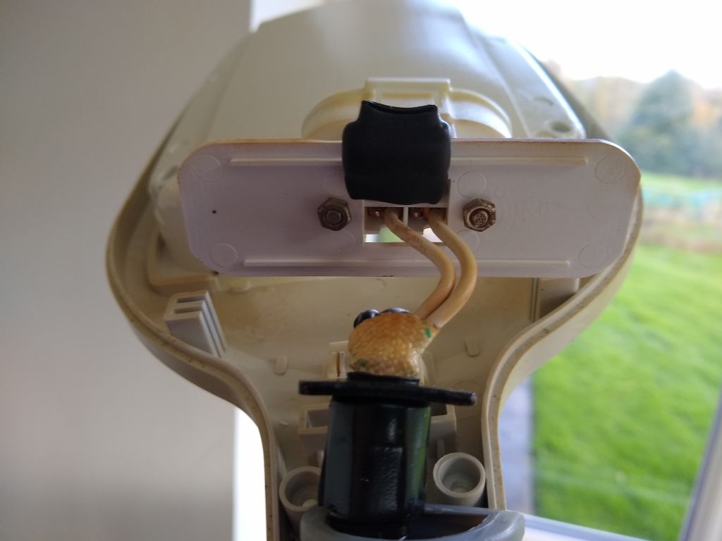

      This is a 27W 4 tube flourescent bulb that fits into a 4-pin holder and has ailed. Replacement bulbs dont work but a mains tester gives power to the female pin holes. I guess its the capacitor? that has failed. I don't see any easy way to remove it (neatly) again guess that it's crimped and snaps in. Removing the heatshrink shows a blue component with no markings.
      Advice appreciated please.

          As far as I understand there should be an electronic ballast between power input and FML.
          I do not see that in your pictures. Is the ballast in the foot of the lamp?
          Possibly the ballast should be replaced.

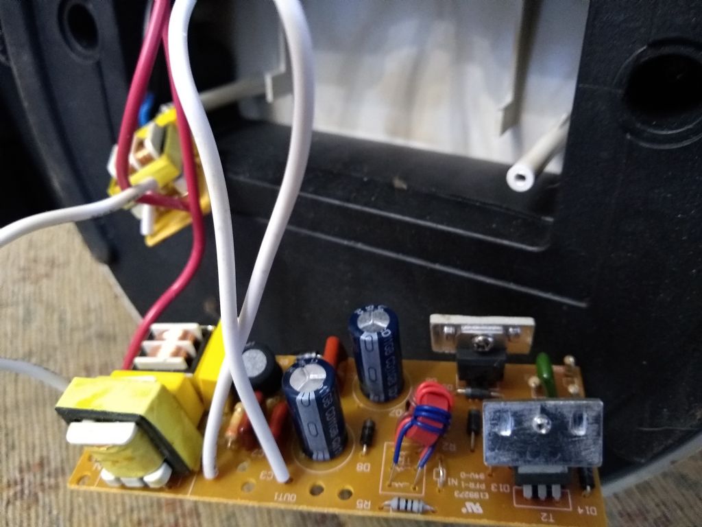

            You were right, Sir. At that point I hoped it would be some obviously replaceable component but was faced with 2 plastic boxes in the base. Nothing looks obviously charred, swollen or loose but unless there's an off-the-peg replacement ballast then I'm out of my ability/comfort zone

                From here I can not advise you how to check if the electronics is still OK. Perhaps you could take more more detailed pictures showing the electronic components and that somebody else can advise how to measure.
                It is something for an electronics forum, e.g. circuitsonline.net (Dutch).

                    You could have a closer look at the components first before you decide for your proposal. The pcb is not to difficult. If you recognize some deviation, replace it. Check resistors and diodes for discoloration, capacitors for deformation etc. But be careful when measuring when it is connected to the grid!

                      The components look normal, no changes that i can determine visually. My abilities with a multimeter are too basic to check them properly.

                        Also no discolorations at the soldering side of the board?
                        Most of times such electronics suffers from continuously overheating..

                              Nothing visible.
                              A replacement has been ordered. This is a floor standing lamp and cheap enough. Any cheap sewing machine light or similar (I own several Lidl led clip on lights which are excellent for local illumination) would have required a bodge to attach to the stand – not worth it for the saving and the ear-ache.
