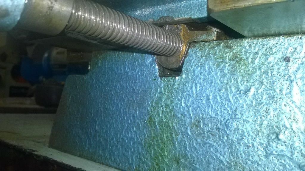

      Hi everyone
      Let me say first that I am a complete novice and after a long time gazing and wondering at some of the items you guys have made i have finally managed to secure myself a milling machine and a good lathe
      My first question is do you guys know of any courses that i could attend on an evening within the Bristol Area, or are there any guys here who would be willing to give up a bit of free time on a Saturday morning, paid of course to just teach a few basics??? I am Currently in the process of joing BSMEE.
      Ive tried reading from books but i do struggle i think i may be more of a hands on type
      Second of all the milling machine i have purchased is a Dore Westbury MK2 although it seems to be in good condition there is allot of backlash within the X axis of the machine ( parallel with the drill) i can nearly turn the handle a full 180 degrees before the bed begins to move. Can i remove this easily or if i use a DRO will this matter?
      Or am i going to grow out of this machine quite quick is it worth saving the pennies and get something a bit more robust like a Boxford VM30?? (Bridgeport is out of my range and wont fit in the space allocated)
      As of yet im not sure what my full intentions are in terms of what i want to make i just want to get started, i would like to get into clocks tractions engines,etc even make the odd item for my kit car
      As i have stated before I am a complete novice Im not even sure if ive installed it all correctly???
      Any advice you guys can give will be great

          Sound like you will have to improve the backlash problem. Might jut be something loose. Easy to fit readout. Did it myself in an afternoon. Bit of weight lifting involved though. If you don't find the reading helpful, get an online subscription to Model Engineers Workhop and jut look at the photos and drawings.

                  As A DW Mk 2 owner owner of nearly 25 years now, I think you will find it a worthy little mill, don't be in too much of a rush to replace it. I have made a few modifications to mine which you might care to consider, the first was to replace the column key with something more robust. The original cracked and I only found it by accident when adding power lift.
                  The back lash you mention is excessive, mostly I suspect from sloppy setting of the cone nuts that the axis handles run off. Remove the handle, hex wrench countersunk screw on the end, pull off the handle from the steel taper cone and screw it in towards the support for the leadscrew to take up the slack, leave a little for free running and refit the handle

                                I had a very small window of opertunity to have another look last night whilst the misses was out
                                My machine in particular has a power feed unit within the Y axis 90 degrees to drill) this leadscrew has a small amount of backlash an upon closer inspection it looks as though the lead screw has been extended and there are a few washers either side of the table mounting casting which then appers to be attached to the power feed drive , there seems to be some slack in the washers as i alternate the direction i can see one bunch of washers closing up and another opening, so there may some adjustment to be found there.
                                In the X direction (parallel with the drill) the lead screw looks as though it operates through two bronze bushes which in turn i think are fixed to the table the backlash appears to be the bronze guides moving along the leadscrew until the are stoped in the machine casting they apper to move a few mm in either direction.
                                Can i cure the x direction with Brians meathod or do i need to take the table away, i did this once by unbolting the 15mm bolts on the underside of the gibs ??? to my horror is saw a series of brass packers which stayed in placed by the amount of oil there so i quickly put it back before i assume made things worse??

                                    Brian i have some pictures and a little video which shows i think the problem can i email it to you?
                                    Last night i was able to sneak into the garage and had another go at looking at the mill
                                    I removed the machine screw which holds the handle on and tried to adjust the cone nut this did remove a bit of slack but made the leadscrew so tight that as sonn as i turned the nadle the machine scre came loose and th handle was turning and not the leadscrew, i had a more detailed view of the bronze guides and it looks as though the amchine screws that hold it to the table ahve come loose these bronze guies are moving until they hit either edges of the casting then the table finally moves please have a look at the photos below i have made a video but i dont know if i can post it
                                    For some reason phots wont upload aggggghhhhhhhhh

                                      Managed to upload a phot into an album hope this helps

                                        The secret to getting the cone nut to take up slack without then binding the feedscrew is to back it off a trifle after you have set it, then push the handle back onto the cone without moving it appreciably before securing the handle to the shaft with the hexagon headed screw. When that hex screw is tightened it also tends to take up clearances in the fine thread between the cone nut and leadscrew and it may take a number of trials to set it nicely.
                                        For another attempt, try the following method.
                                        As you did before, screw the cone nut up to just take out the slack on the leadscrew. You should still be able to turn the leadscrew by gripping the bare shaft by hand at this stage; if not ease the cone nut back a little until you can. Then back it off by 1/4 turn before refitting the handle again. You should now have some running clearance without excessive slop
                                        Regards
                                        Brian

                                          You say X axis parallel to the drill. To me, vertical travel means Z axis, with X axis being Left/Right, and Y Front/Back.
                                          The pictures look as if you are dealing with the vertical feed for the table (Z axis in my speak).
                                          Bevel gearing will introduce additional backlash to that already present in the Leadscrew / Nut.
                                          Also, the gears each need to be fixed firmly to their respective shaft, not only to reduce overall backlash, but to prevent damage to both shaft and gear. (End float on the driving gear shaft will also increase backlash)
                                          From what others have already said, the carrier for the nut can become loose, so that will increase backlash even more, and cause wear of the holes and securing hardware.
                                          Once correctly positioned, would it be possible to dowel / rollpin through the frame and into the nut carrier?
                                          If you are desperate to eliminate backlash, if there is enough material in the nut, it could be partially slit, and then one end tapped for a screw to force the two sections apart. This will reduce backlash; although not as elegant a solution as having the ability have a second nut rotatable relative to the main one, to act as sort of locknut
                                          In my experience, it is not too uncommon to have about 0.020" backlash in a drive. You need to be aware of, and allow for it, if reversing the direction of travel. My method is to lock the travel, reverse to take up the backlash, set the dial to Zero, and then unlock before traversing.

                                                I have managed to repair this by removing the handwheel and conical nut and also the small aliminum chip gaurd from there i was able to push the table back as it was no longer connected to the leadscrew, and there is was the screws on the bush were loose so re-tightened them with some loctite and a spring washer, then had to mill out a bit of the bottom of the chip gaurd
                                                I put everything back together and adjusted the cone nut as you guys have suggested and it a great deal better so hopefully be able to starting to use it soon
