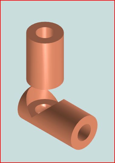

                      Just remembered I sketched something out for Andrew J.
                      I have used this method a few times, pic is the basic joint, you would use 3 pieces
                      You then just machine/hand finish the stubs on the ends so they blend in, like this water lifter elbow
                      Or this clack

                        Thanks for the various suggestions, gents. I like JB's sketch suggestion (simplest for me!). I can't see his photographs.
