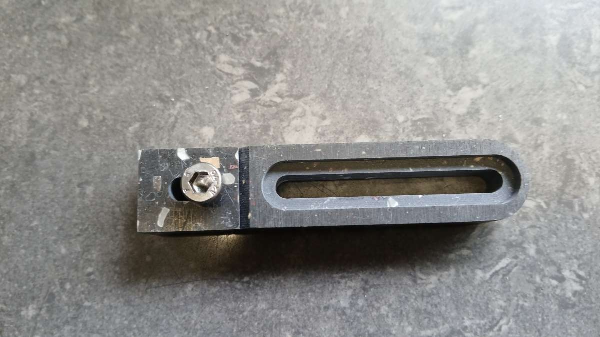

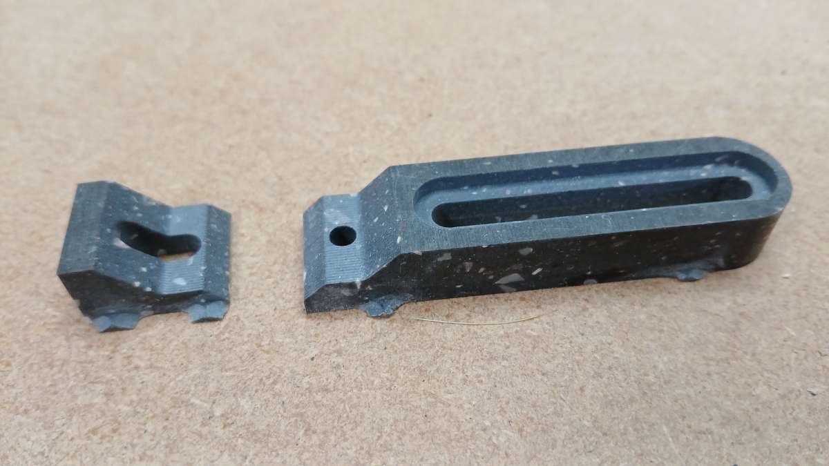

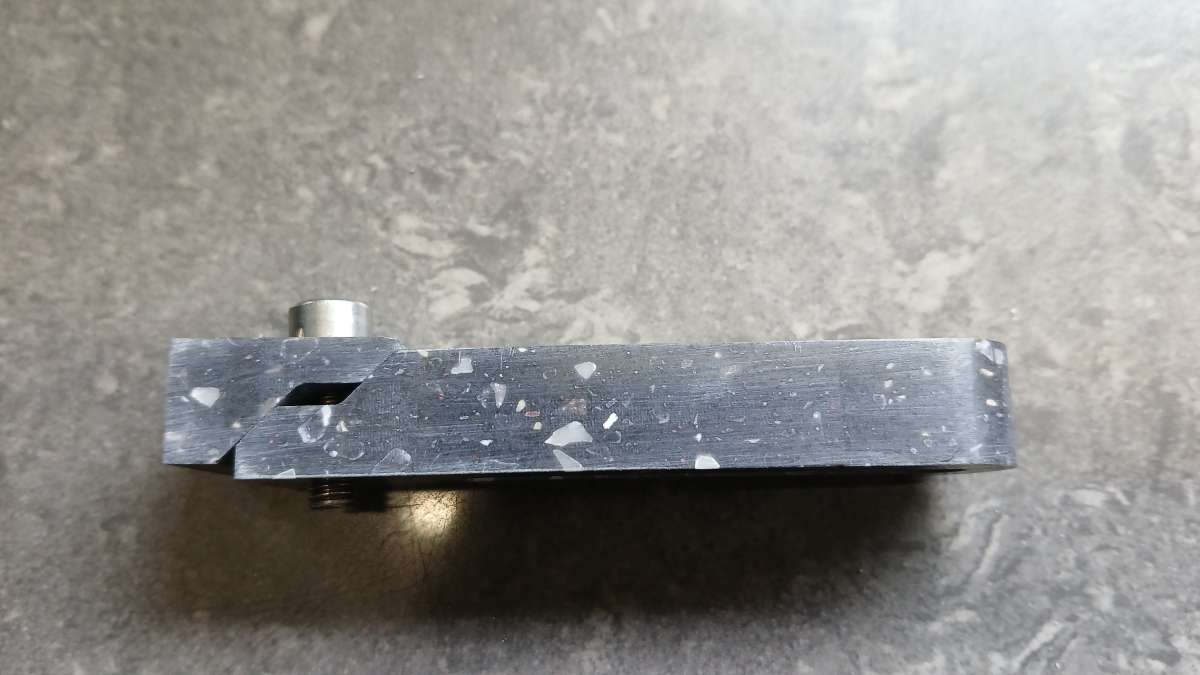

              Using a tap would probably be th ebest option for now, then find something not too hard to practice the thread milling on. Cutting speed would be the same as similar diameter cutters on teh same material. As would feed rates for a similar dia cutter with the same number of flutes. What you have to decide for yourself is DOC which given the fragile nature of these cutters is best kept quite low. You do this by having the tool make several passes slowly cutting deeper each time.
              A bit of a teaser while the video uploads.
              20260506_151410
              20260506_153259
              20260506_153308
              #847080
                My piece of Corian was a bit short but otherwise all went well.
                Towards the end of the outside contour I move the camera away to show that the swarf is contained in the trough with very little elsewhere but the narrow nozzle keeps it away from the area immediately around the tool.
                Depths of cut and stepovers were a lot too fine for Corian but I had used my Aluminium settings. I did wind up teh feed rate which can be done on the fly with some of the contour being done at 900mm/min feed rate but knocked it back down to 700 for the tabs. Run time was approx 35mins but could easily have been 20mins in Corian.

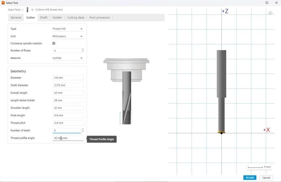

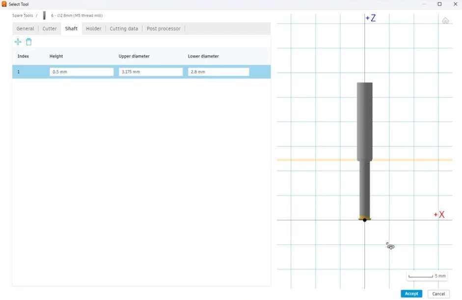

                      Further to the above, I think that I’ve successfully created a thread milling tool and applied it to the model in F360.  The simulation works OK but I’ll try it on something more forgiving than aluminium to test it.  I derived the information from this YouTube video.
                      Screen grabs include this:
                      %mm thread tool specs
                      from which I nicked the basic dimensions, and this
                      %mm thread tool shaft specs
                      which gave me the shaft dimensions of the Makera supplied threading tool.  I made the thread with 3 passes.
