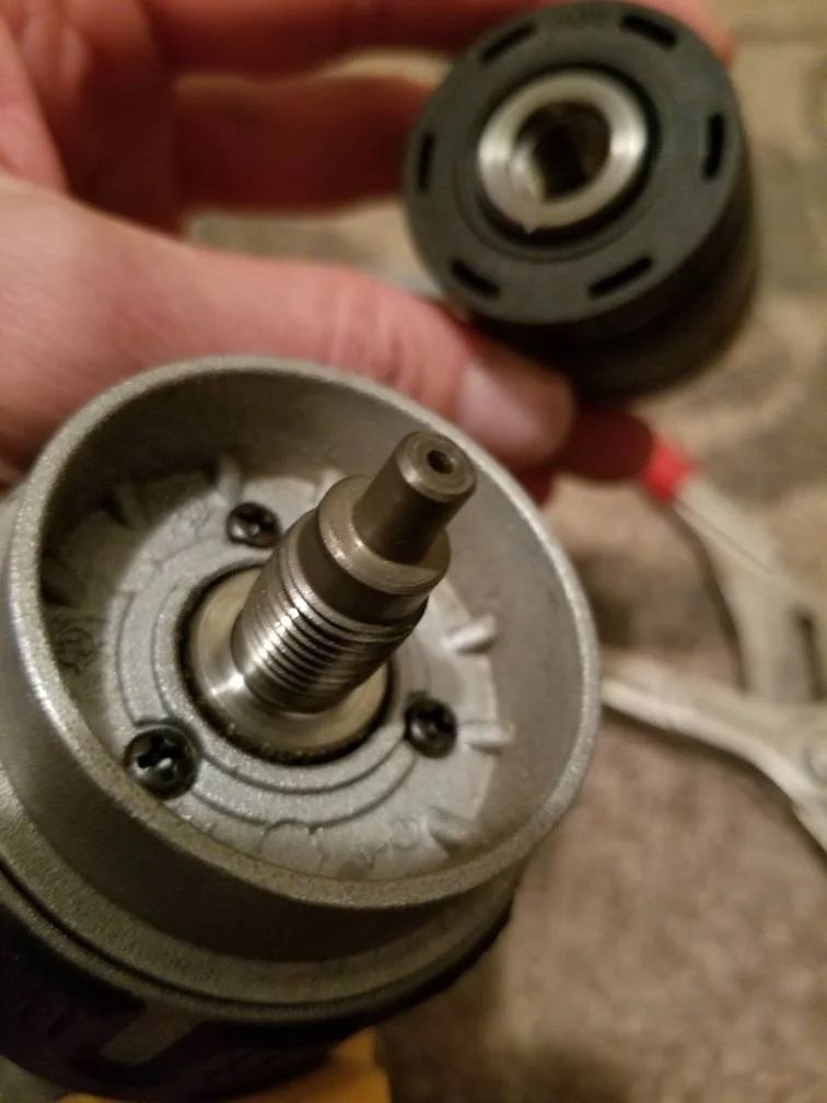

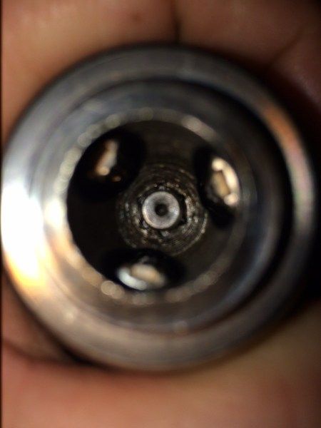

                There is no retaining screw at all – should be as per the photos below.
                I gently heated the drill shaft in the chuck ( with a good heat gun and 8mm nozzle), and smacked the allen key, nothing. Heated some more and filled the chuck with penetrating oil, left it, smacked it, nothing. Heated it again till really hot, poured ice water into the chuck – it fizzled and spat madly – hit the allen key with ALL my might – NOTHING! Got mad, put the drill in the woodwork bench vice, heated that chuck till it was smoking hot, and smacked that allen key with a 2kg hammer – I tried clockwise, and counter-clock..Nothing, other than the drill still works fine….I give up.
                View down the chuck throat – that spigot is the drive shaft through the chuck. The hex looking thing is the chuck body, not a nut or bolt head
                And this lucky bugger got his chuck off…clearly see there is no retainer.
                BTW, the silver body of the drill, as seen below, is all PLASTIC! not cast aluminium, like my old bosch…I heated the threaded shaft so much, that plastic was starting to soften…with some luck perhaps the bearing is also gone now. Did I mention, I hate this drill..
