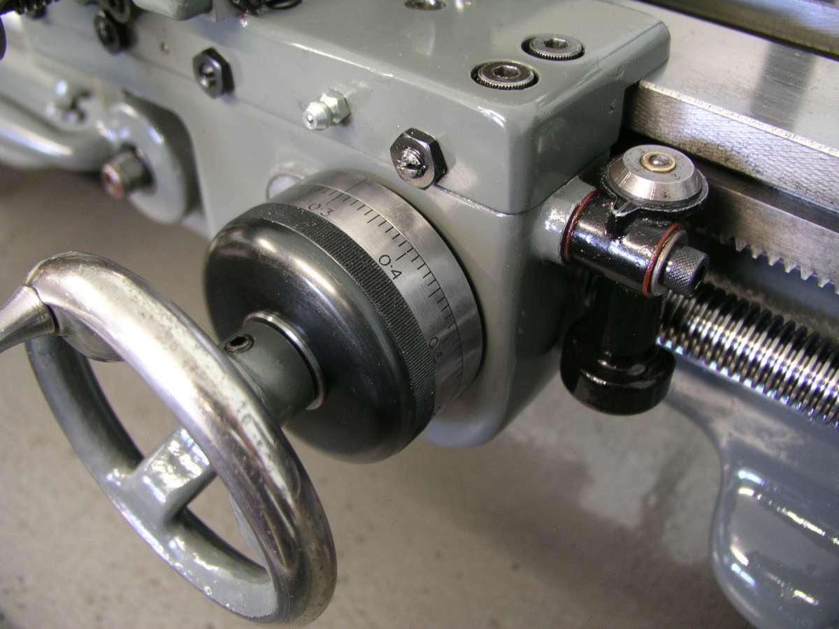

        Without knowing the nature of the items you want to mark, and the quantities involved, it’s difficult to suggest appropriate solutions.
        I have a small Taylor-Hobson  pantographic engraver and the associated copy fonts which I use for engraving various dials and shop-made tools, and which gives excellent results. Whether such a machine would suit your need is impossible to say, and you might find the investment too great – mine cost £200.
        The photo below show an example of a dial which I engraved.
        Mike
