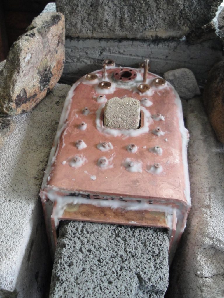

      Hi all some help please.
      In preparing for silver soldering has anyone fluxed joints before riveting and allowed the flux to dry out in the right place between the joint, say overnight; before silver soldering. My boiler sections are currently fixed together with screws and I would like to be sure the flux has fully coated the surfaces before actually removing these and finally replacing them with Rivets. I presume the water in the flux mix is only there to allow the flux to flow or seep into the joints which it would not do if dry, or does it serve some deeper chemical purpose? my concern would be that the air pressure of the flame might blow the dry flux out from the joints if applied directly Hope this makes sense.
      Kind regards all

          i partly do what you propose in that for miniature loco boiler work i apply the flux then let it dry out a bit for an hour or so.
          as for flux between joints riveted together, there are perhaps 2 points worth considering. the joints should be cleaned beforehand and roughed up, then riveted. if you have less than 2 thou gap between the riveted joints you wont get silver solder penetration. there are tricks to overcome this – centre popping the joint all along leaving the raised bit created by the centre punch, or coarsely filing criss cross lines (something i do for foundation ring sections).
          if the joint is clean before riveting and the riveting is done shortly before silver soldering ie not left on the bench for a few months, then it is only necessary to apply the flux either side of the joint and not between.
          remember that all rivet heats must have silver solder applied, and ideally the rivets should not be tight.
          just my own personal approach of course.

            My thinking was to pickle the individual boiler parts, and then flux and rivet up with a few bits of thin 2/3 thou shim adjacent to rivets between joints which is then pulled out. Leave overnight and solder up the following day, using a normal fluid flux mix to supplement the joints. I understand the need to coat the rivet heads. This isnt my first boiler but on the last one I did seem to get problems with what appeared to be lack of flux penetration.

                  I do it a little different, I make the joint then apply a weak (i.e. watery) load of flux to one edge so that it is drawn in by capiliary action, then apply a thick paste to either edge. The weak solution will find its way into the rivets and every where else. I often allow it to dry, seems to make no difference.

                    The job of the flux is to prevent oxidation of the joint when heat is applied. Oxidation will prevent the solder from flowing. Many propriety fluxes can do a limited amount of cleaning, but you shouldn't rely on that – its best to get the joint as clean as you can before applying the flux.. The water is simply to make it easy to apply the flux to the joint – it has no magic properties. When the joint gets close to the solder melting temperature, the flux will fuse into a clear liquid; as long as as it coats the joint then no oxygen can can intrude. There's a "gotcher" though, if you heat flux for to long, or at too higher temperature, you burn it and it loses its ability to exclude oxygen.

                            It depends on the flux: Easyflow is quite sensitive – if it goes brown then its burnt. This can occur as quickly as a minute or two. High temperature fluxes, such as Tenacity, can withstand higher temperature for longer, but there's a catch: when the joint has cooled down, the flux forms a hard, glass-like, covering. Very hot water removes the Easyflow, but has no effect on Tenacity which often has to be chipped off.
                            Never heat the solder directly, it will ball up and refuse to flow; the normal reaction is then to keep blasting the area which simply ends up burning the flux. Heat the joint; sneak up on it from various directions, but avoid directly heating the solder. When the joint is hot enough it will melt the solder which will then run into the joint.

                              re gary's 'gotcha' i use Thessco F or J&M Tenacity 4A for copper silver soldered loco boiler work where prolonged heating is involved. under no circumstances use ordinary easyflo flux. if the job doesnt get up to heat within say 10 minutes with propane and the joints being silver soldered not done within a few minutes then you will have flux exhaustion problems. (i have never found adding extra flux part way though satisfactory).
                              this is an idea of the quantity of flux i use – quite a lot. mixed to a stiff paste with as bob says a drop of washing up liquid, and then left to dry a bit before lighting up.
                              your 2 thou shim is a very good idea when riveting. i try and use as few rivets as possible.

                                  Gary and Julian thank you. What a great example of " a picture speaks a thousand words" I would never have considered the block in the firebox to conserve heat and protect other areas, and the view of the flux gives me a really good idea of the amount and consistency.

                                    Thanks for your photo – very informative. Especially how you use Thermalite blocks. What size of burner would you use for this job when you do light up? I'm looking to have a go at a Minnie TE sized boiler. I suspect that the boiler in your photo is a little larger.

                                      i have a sievert set and 13kg propane bottle. for boiler work i use the 2943 burner.
                                      all bushes PB102/hard drawn phos bronze, and only partly tapped with a taper tap before silver soldering.
                                      glad you like the pic -there are more of this boiler in 2 of my albums. doing the backhead is the final stage and always a bit nerve wracking. i also check beforehand that my propane bottle is still heavy!
