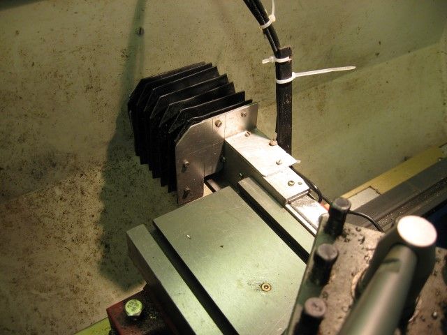

            I think a DRO on a lathe is very worthwhile. I have fitted one to my Chester DB10G (Which I think is based on the Seig C6). I think this is about the same size as your lathe. The scale on the cross slide is a modified 150mm caliper and I do not find that it gets in the way. I did fit a scale (100 mm caliper) on the compound slide which I have now removed as this did get in the way. Here are some pictures of how it is mounted.
            Note. The reading from this scale is displayed on a Shumatech DRO350.
            Les.
