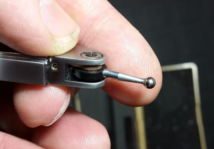

      I want to make another measuring probe like the ones in the picture below.
      My first attempt to simply turn one up was ok but highlighted the need for the tip to be very spherical. So for Mk2 I want to put a hole bearing ball (1/8~1/4&quot and glue in on to the turned body. The hardness and smoothness of the ball will be advantageous also.
      Just looking for some guidance or comments on the following:-
      1. I assume I'll need a carbide drill. With my speed limited to 3000RPM approximately how long should I expect this to take ? 5 mins or 50 mins ?
      2. I will probably need to grind a small flat on it before drilling, but rather than do this off-hand then have the challenge of then re-holding the ball with flat in the right place and at right-angles to the drill, would it be better to attempt mill a flat with a carbide mill ?. I just cant see this going well …… actually I have just realised, I have a diamond wheel I can mount in the mill so forget this one !
      3. … or should I forget carbide and just go for a small diamond encrusted drill?
      I have seen torroidal shaped rubies for sale for this purpose but perhaps that can wait for Mk3, in the event that Mk2 is still lacking in some way.

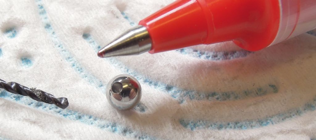

            #548554
              Yes I usually do them in a collet or top hat bush
              Small hard one being annealed
              After drilling 1.0mm

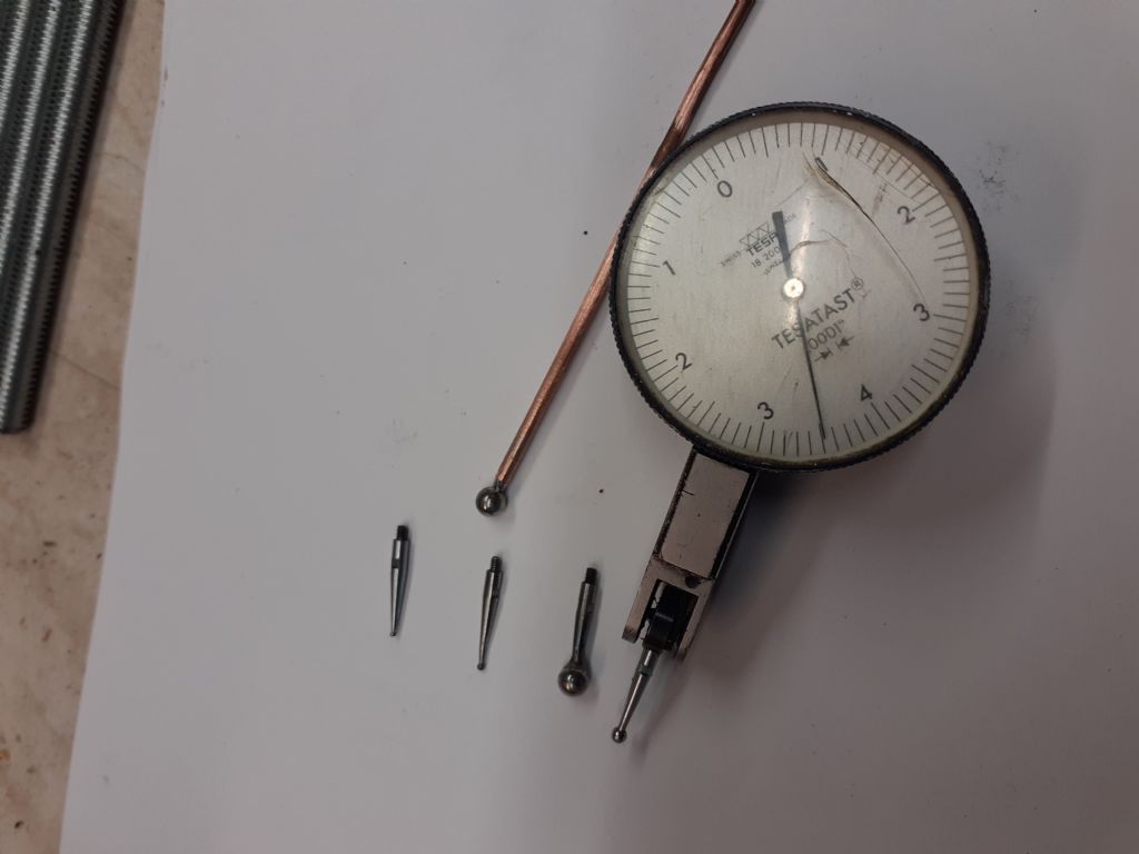

                      I had to replace a lost probe point a few years back. Normal inner ball from a std bearing was annealed similar to how Jason suggested; the only difference, it was heated on some dry sand (with a little dishwashing liq) and pushed in with a wooden dowel. Was drilled and tapped using HSS. Any concentricity issues are inherently solved by the small centre drill breaking, but even with a wobbler type probe if you centre it with your finger on the ball all will be good…

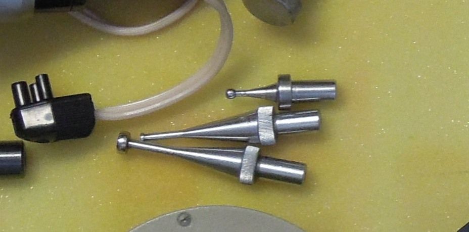

                                I have seen some ruby tipped indicator probe ends on ebay, made in China, similar to the one in Luker's photo. I cannot say how accurately spherical the rubies are. The ruby tipped type for CNN machines also come up for sale regularly, I don't know how expensive they are.

                                  These are a few I still have that were soft soldered in place.
                                  It is easy and well worth trying as the ball dosn't soften and and it would only take me half an hour to solder into place after dimpleing the stem. The one on the left has two flats ground on after soldering to get close to a step on a 0.015 " shoulder with my dial indicator.
                                  David

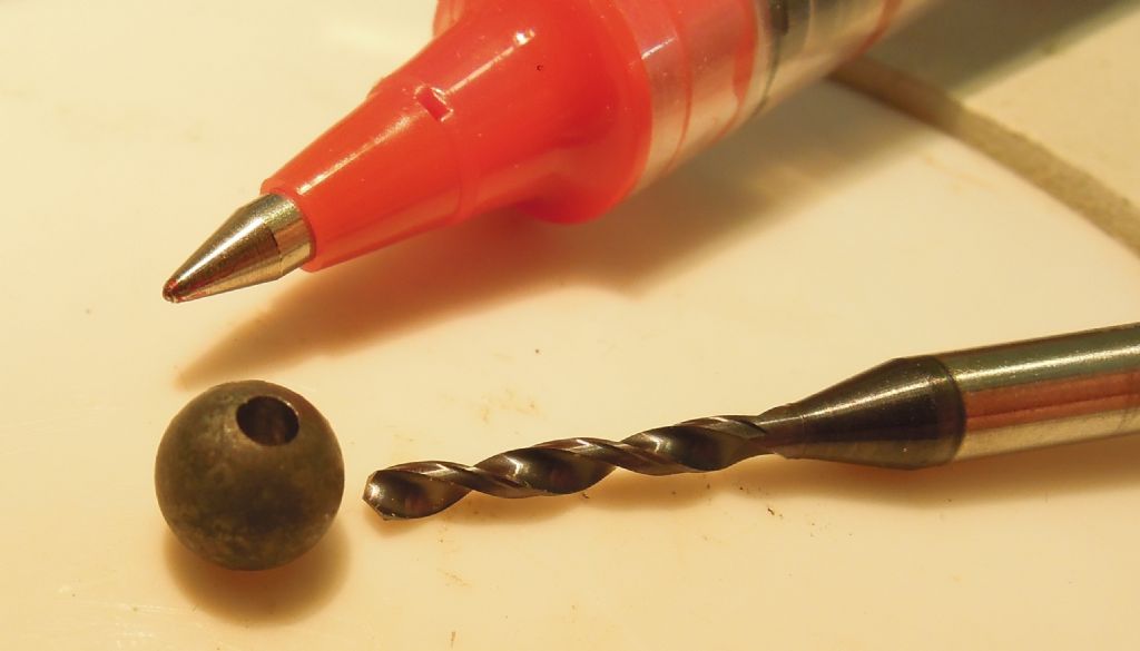

                                                  gerry madden
                                                    @gerrymadden53711
                                                    A metallurgist colleague advised me that for 'perfect' annealing of 100Cr6 ball steel, the cooling-down process should theoretically take 25 mins. Since this long time period would only result in more scale formation (which I would then have to remove and mess up the diameter in the process) I decided to experiment with the carbide drill today.
                                                    First I used a 4mm carbide spotting drill. Strangely this really didn't seem to make an impression. Well in truth it made a pin-prick of a mark but it didn't seem to want to go any further. I checked the point of the drill under the microscope and didn't see any obvious damage.
                                                    Expecting to get another poor result I then popped my new 1.5mm carbide drill in a collet and tried again. Immediately I could tell it was cutting. I ran the mill at 3000RPM and just maintained a light finger force on the quill lever. After about 10 minutes it was through.
                                                    Perhaps I could have done it quicker by applying more force but these drills are easily broken so I was happy to take my time. The hole quality was superb too. I didn't need this but its always nice to have.
                                                    So that was the trial. As was suggested I held the ball in a collet. My centre was found by eye but I have to admit now that it wasn't perfect. What I plan to do for the next time around is drill a 'vee' socket in a bit of aluminium and then glue a ball into this. If I keep the X and Y controls locked that should keep me on the perfect centre for drilling the ball.
                                                    Thanks to all ideas contributors.
                                                    Gerry.

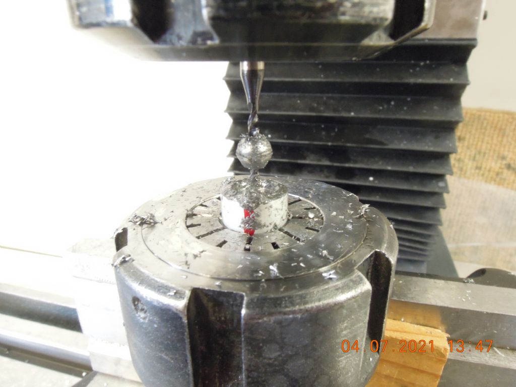

                                                    #554066
                                                    gerry madden
                                                      @gerrymadden53711
                                                      Thanks all for your thoughts and guidance on how to drill holes in balls. After some trial and error I think I have perfected the art a little further and just to help the next one along that wants to do something similar here is the technique that seemed to work well for me.
                                                      1) Hold a small piece of a relatively soft material like aluminium in the mill vice. Check the vice is secure and the X and Y slides are locked solidly.
                                                      2) Using a conventional centre-drill make a hole in the material. Select a size of centre drill that will ensure that the ball doesn't rest on the entrance to the cylindrical portion of the hole. The ball will be much more stable when it sits in the 'V' portion.
                                                      3) Put the ball in the hole then, protecting it with a piece of soft metal to prevent surface damage, give the ball a bit a bit of a thump with a hammer. This will plastically deform the soft seating material and increase the area of contact of the ball in its 'socket'.
                                                      4) Remove the ball and put a little super-glue on the seating. Replace the ball and press it into its socket for about 30m seconds.
                                                      5) If you still haven't moved those X and Y slides the quill will still be completely concentric with the ball that you want to drill. Its now just a case of drilling with your carbide drill. But one needs to be a little bit 'sensitive' to ensure that the drill doesn't wander off the centre due to other 2nd order excentricities such as chuck runout etc. To help, what I did was remove the strong return spring in my Wabeco mill's quill. Once this was out the quill will drop slowly with only viscous drag under its own weight. The quill clamp should of course be adjusted to remove as much clearance as possible but too much that is stops the quill from moving.
                                                      6) Let the drill run for about 1 minute with only 'quill weight' on the drill. Once it's made a small indent you can safely begin to apply finger pressure on the quill arm and begin to cut at a much faster rate. (This is enough to get through a 3mm ball in about 45 seconds running at 3000RPM. )
                                                      7) I couldn't tell if there was much heat being developed in the cut but I dont think so. Quite honestly though with such small parts its difficult to tell what's going on anywhere ! What one does find though is debris builds up and obscures the workpiece so I stopped every so often and cleaned things up with a squirt of WD40.
                                                      8) When the drill is through the ball it very kindly pulls the ball out of the socket for you. All you need to do then is slide the ball off the drill and drop it in some acetone to dissolve the remaining hardened glue.
                                                      9) If you haven't loaded up the quill too much you will have no chipping on the surface of the ball at break out. You will also have a very high quality hole. For some strange reason the hole is always very slightly tighter on one end. I haven't worked out whether this occurs at the entrance or exit end but its a very small amount and not something that should worry most people.
                                                      With this technique I feel I could drill holes in bearing balls all day long, completely concentrically and without any surprises or broken drills, and probably on an even smaller scale too. I hope others find this useful.
                                                      Gerry
