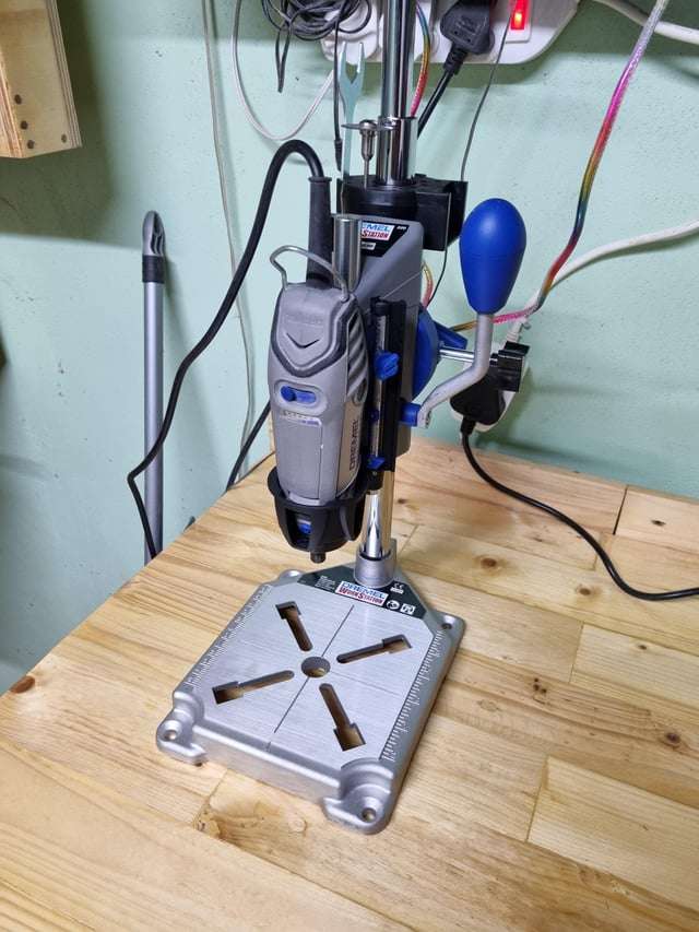

        Dremel make a drill press stand to hold their standard Dremel rotary tool, which has variable speed up to 20,000 rpm or more.
        1. ntd-i-got-this-dremel-workstation-three-years-ago-for-v0-qvkku27m7me81

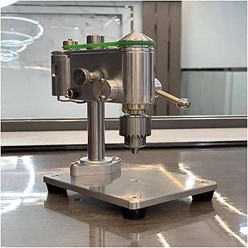

            These are supposed to be very good but never used one.IMG_4882

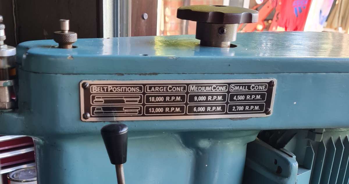

                            I’ve had a Pollard high speed drill for a number of years, can’t recommend it highly enough, proper English quality.
                            Looking at Tony’s site, it’s the model 9FX. Built until the 1950’s it’s older than me !
                            As standard, the speed range is 2700 to 18000 rpm.     Mine is now fitted with an inverter so I never feel the need to change the belt positions.
                            If you consider getting one, do be aware they are very heavy for a small machine, I would estimate at least 50kg.

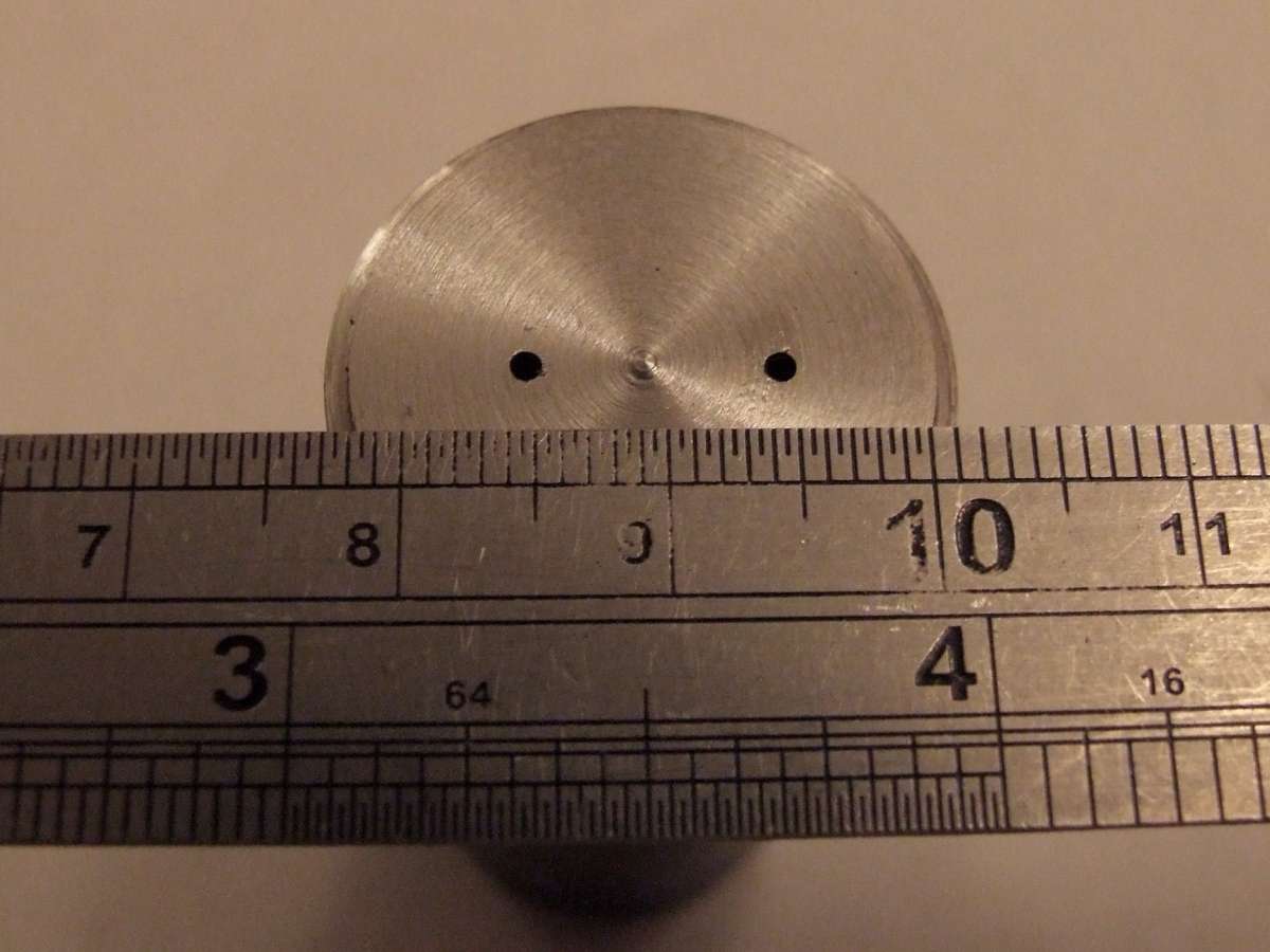

                                  While speed when using small drills helps it is not essential. Here is a photo of 1.2mm holes drilled 8mm deep in tungsten alloy:
                                  2017_09020001
                                  These holes were drilled on a Bridgeport mill at 2500rpm with no issues.
                                  When drilling tougher, or work hardening, materials with small drills (<2mm) I prefer to use carbide drills. These are not usually four facet ground so need a starter dimple. I mostly use a 2mm carbide spot drill.
                                  If the OP is having trouble I suspect the issue is with the drill bit itself or the mill, not the speed per se.
                                  I have an old PCB drilling machine which goes up to 10000 rpm but have never used it thus far. Of course such machines are now pretty much obsolete in industry. Commercial PCB fabrication uses drilling speeds in the hundreds of thousands of rpm.
