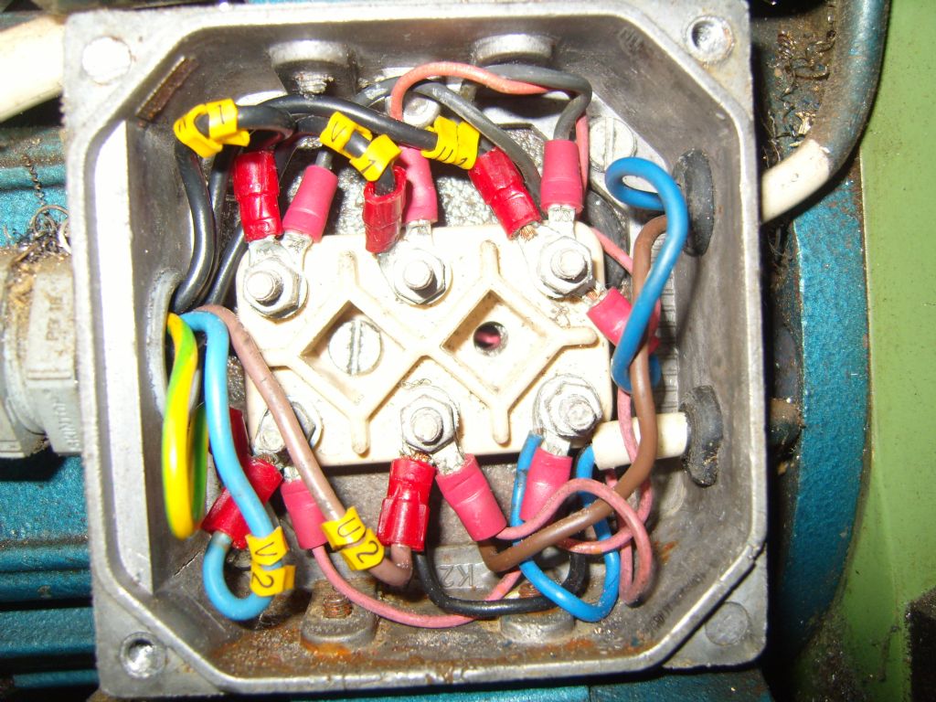

          ive removed the switch
          #185931
          kevin large
            @kevinlarge76611

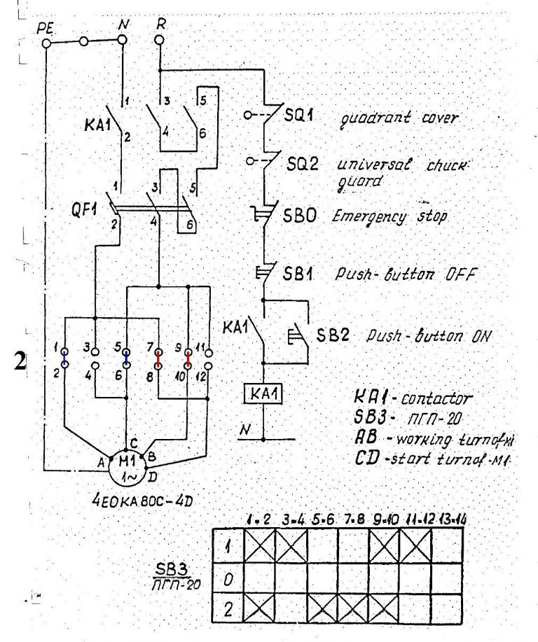

            the above is how its wired now in the top pics the white lead goes straight to plug hope these pics help if more pics will help just let me know

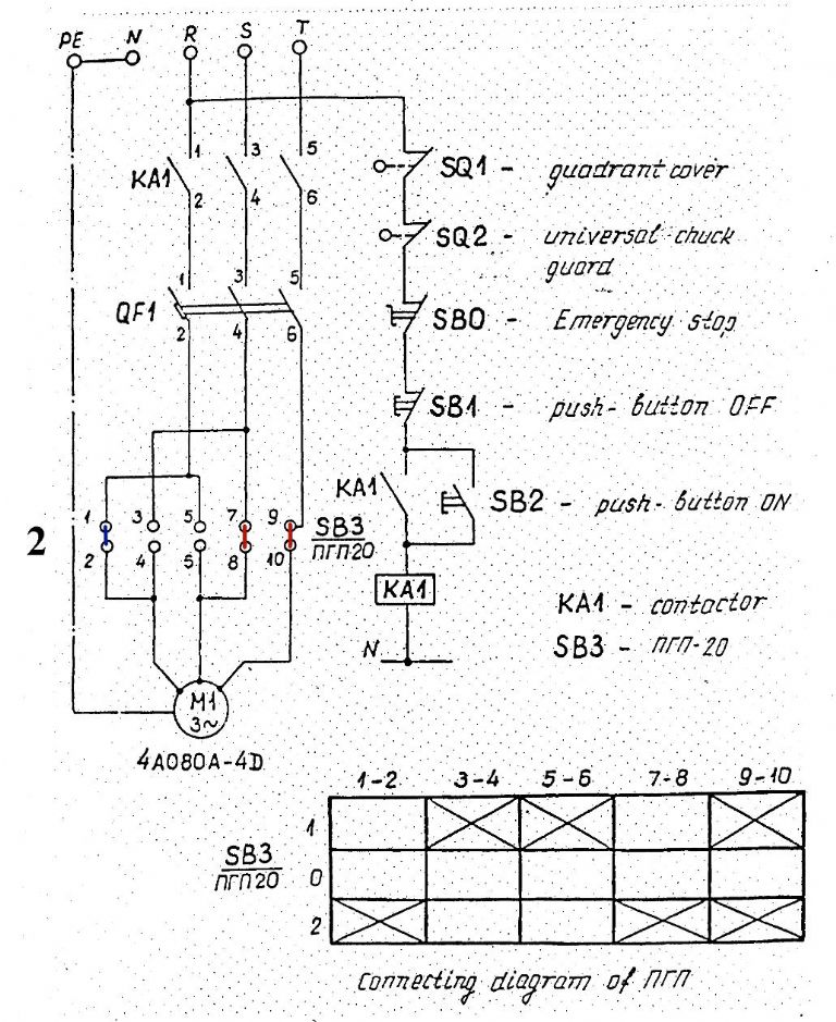

            #185945
            Nicholas Farr
              @nicholasfarr14254
              Hi Kevin, looks like it has been bodged up a bit and it isn't as safe as it should be as the NVR contactor is missing. Below are scans of the circuit diagram. The first two show how the forward/reverse lever makes the connection ditto on SB3/nrn-20 on a single phase motor and the second two shows the same on a three phase motor.
              I'm guessing that QF1 may also be missing which is an overcurrent protection.
              Regards Nick.

                  Thanks nick all looks like rocket science to me does that single phase diagram relate to what I have
                  #185961
                  Nicholas Farr
                    @nicholasfarr14254
                    Hi Kevin, the forward/reverse switch appears to be ok, as the same switch is used for either single or three phase, but overall I don't think what you've got relates to either diagram. I think you need to get a competent electrician to look at your options showing the diagrams.
                    Regards Nick.

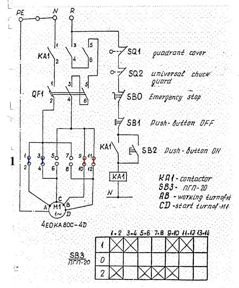

                      Hi Kevin,
                      The motor is definitly a single phase motor. IF NO CONNECTIONIONS AT THE REVERSING SWITCH HAVE BEEN CHANGED FROM THE ORIGINAL WIRING then removing the two straps in the motor connection box leaving the existing wires connected to U1 and U2 and connecting the two black wires that have been cut off to terminals V1 and Z2 (Middle top and bottom right) should work. Before trying this can you confirm that the motor runs forward with the reversing switch in both forward and reverse positions and that in the middle of position the motor is stopped. (Assuming there is a middle off position.) I have just read your comment about the mains being connected directly to the reversing switch. In view of this I agree with Nick that you need a competent person to re wire it as in the diagram so you have the NVR function and the interlocks working.
                      PS I've Just realised why there are two diagrams for single phase operation. One shows the path through the reversing switch for forward. The other shows the paths for reverse.
                      Les.
                      Edited By Les Jones 1 on 09/04/2015 23:06:37

                        Hi les
                        at the moment the motor only runs forward in the reverse position nothing in the off nothing in the forward

                          Hi Kevin,
                          Either the wiring on the reversing switch has been changed or the motor has been connected to one of the pair that should go to the main winding (2 and 10 on the reversing switch if it is wired as in the diagram) and one of the pair that would go to the auiliary winding (4 & 6 for one of the wires and 8 &12 for the other wire on the reversing switch if it is wired as in the diagram) Does your lathe have an electrical box containing the contactor (KA1 on the diagram) and the thermal overload unit (QF1 on the diageam) ? Also does it have the start and stop buttons and the interlock switches ? I think you need to get someone on site with electrical knowledge.
                          Les.

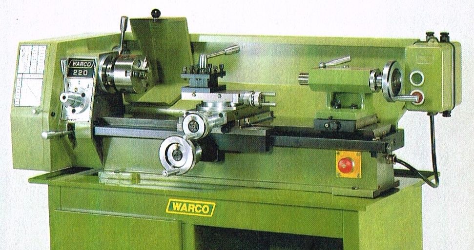

                            Hi les it does not have start and stop button box it does have red panic button nothing else that I can see I’ve try ed 2 electrician so far but they didn’t seem to have much idea
                            kevin

                                  Hi Kevin and Les, as far as I'm aware all Warco 220 lathes came with the contactor box wired in. The photo below shows this box situated at the right hand end of the splash back.
                                  Warco 220
                                  The Warco 220 is the same as the Mashstroy 210T and the emergency stop is wired integral within the lathe itself and can be seen at the right hand end of the bed. I think at some time in its past, the contactor box had developed a fault and someone has just removed it and put a plug on the end of the flex that went into the box. Peter G. Shaw did a write up in MEX 192 of how he repaired a fault on his own Warco 220 lathe contactor box.
                                  Regards Nick.

                                    Hi Nick,
                                    I agree with your theory about the original contactor box being removed. I think Kevin should at least have an NVR even if he does not have thermal trips.I suspect the reversing switch is wired as in your diagram as the links between terminals on the reversing switch that are visible in Kevin's photos tie up with the diagram. I suspect that one connection on the motor is connected to one of the main winding wires and the other connection connected to one of the auxiliary winding wires. This would explain why the motor only runs in one position of the reversing switch. In the other position the two motor connections will be connected to the same leg of the mains. I think it would be too difficult to talk Kevin through identifying the 4 wires from the reversing switch to the motor using a multimeter. (Even if he has a multimeter.)
                                    Les.

                                        If you want to try to identify the the wires to the motor nere is how to go about it.
                                        FIRST UNPLUG THE LATHE FROM THE MAINS.
                                        Set the reversing switch to the middle off position.
                                        Disconnect one of the wires that is connected to the motor in the motor connection box. (This is to avoid the winding resistance from confusing your readings as it will only be about 5 ohms.)
                                        Confirm that there is only one wire connected to terminal 2 on the reversing switch. Use your meter to identify which wire this is in the motor connection box and label this "A"
                                        Confirm that there is only one wire connected to terminal 10 on the reversing switch. Use your meter to identify which wire this is in the motor connection box and label this "B"
                                        Confirm that terminals 4 and 6 are linked together on the reversing switch and there is only one other wire connected to this point.. Use your meter to identify which wire this is in the motor connection box and label this "C"
                                        Confirm that terminals 8 and 12 are linked together on the reversing switch and there is only one other wire connected to this point.. Use your meter to identify which wire this is in the motor connection box and label this "D"
                                        Confirm that terminals 1, 3 and 7 are linked together on the reversing switch and there is only one other wire connected to this point.. I expect this to be live or neutral of the wire from the mains plug. Make a note of which one it is.
                                        Confirm that terminals 5, 9 and 11 are linked together on the reversing switch and there is only one other wire connected to this point.. I expect this to be live or neutral of the wire from the mains plug. Make a note of which one it is.
                                        When you have done this report the results particularly any difference to what I expected.

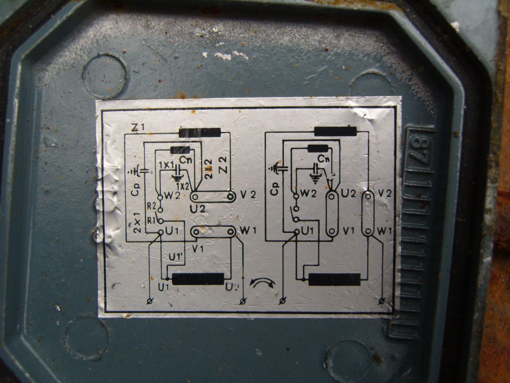

                                          Hi Kevin, if you can check all the connections as Les has suggested, I think you will find they are all correct as I've studied your photos again and they look to be right, but you do need to make sure.
                                          In the meanwhile and this may help Les more than yourself, I have been able to lift the cover on mine and your connection block is not all that different. The links shown in my diagram, have not be used in the wiring.
                                          In the photo below the block is designated as follows, from top left to bottom right and reading left to right. W1 V1 U1 # V2 U2 W2
                                          Mine also has two capacitors, but I don't know their values, but one is physically slightly smaller. The larger one comes in though the top grommet on the right hand side and the smaller one comes through the bottom grommet on the right hand side. The wiring coming in from the left hand side is from the forward/reverse.
                                          I'm sure yours can be corrected from all this info, but I do agree with Les that you really do need an NVR for safety reasons as much as anything else.
                                          Regards Nick.

                                              Hi Kevin,
                                              Have you identified and labeled the 4 wires in the motor connection box ? If so here is the next task to confirm that the reversing switch is working as it should be. You need to create a table for each of the three positions of the reversing switch to indicate which of the mains plug pins that each of the 4 wires ( A, B, C, D) connect to.
                                              Somthing like this
                                              Forward
                                              A ?
                                              B ?
                                              C ?
                                              D ?
                                              Middle (off)
                                              A ?
                                              B ?
                                              C ?
                                              D ?
                                              Reverse
                                              A ?
                                              B ?
                                              C ?
                                              D ?
                                              You will replace the question mark with either L (Live), N (Neutral) or NC (No connection)
                                              When I have confirmed that the results of these tests are as expected I will tell you how to connect the 4 wires to the motor terminals.
                                              The tests that you have done so far confirm it is wired as in the diagram Nick posted. (Apart from the strarter being removed)
                                              Les.
                                              Nick,
                                              The diagram in Kevin's motor makes it very clear how to wire it up.
                                              Les.

                                                Hi Kevin and Les, I traced my wiring out on my forward/reverse switch today and found that it differs slightly from the diagram. The numbers on mine are in different positions to Kevin's, but the switched contacts still match up to the same numbers in the box diagram. I've put a couple of photos of the wires to the switch and a F and R circuit diagram plus a diagram of the links attached to the switch in my Warco album **LINK** I haven't included the contactor or the circuit breakers with them, as they are the same as the manuals diagrams, just hope you can read my pen drawings OK.
                                                Regards Nick.
