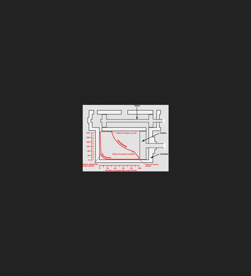

          As the maths is beyond me, I’d develop a compressed air engine by:
          • Making an ordinary steam engine.
          • Taking an Indicator Diagram.
          • Observing how far off the Rankine loop it is. Then, iteratively taking many Indicator Diagrams:
            • Increase the input port and valve until the indicator loop looks more Rankine-like
            • Adjust the valve events to further improve loop shape
            • Increase the output valve to improve loop shape
            • Repeat until ‘good enough’
          The Indicator is one of James Watt’s smarter inventions – the man was a genius.  Watt, and successors, used the tool understand how steam engines worked, so as to improve efficiency. The diagrams highlight design errors like too small inlets and poor expansions (cylinder piston and stroke too small or big, wet steam, suboptimal piston/cylinder proportions etc).  Indicators much used by practical engineers too – they reveal faults whilst the engine is running.
          Screenshot 2025-11-21 at 21-07-13 Indicator_diagram_steam_admission.svg.png (PNG Image 300 × 232 pixels)
          An engineer able to do the maths would get close to a reasonable design without having to experiment.  Much faster than guessing.  Still necessary to test and debug a prototype though.

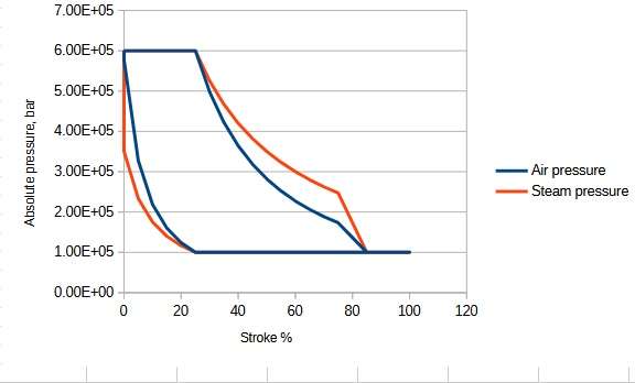

                  The power output per stroke of a reciprocating energy is the area of the indicator diagram, less mechanical losses. Making the assumption of no wire drawing at inlet, adiabatic expansion and compression, blowdown from exhaust opening to atmospheric pressure taking 10 % of stroke the following indicator diagrams can be constructed by calculation, based on P*V^gamma being a constant (one of the gas laws). The old engine builders use 1 as the expansion index (gamma) of saturated steam. Nothing to do with initial temperature or specific heat (apart from gamma being the ratio of specific heats at constant pressure and volume). If anyone wants a copy of the calc let me know. I do know that steam is not an ideal gas, but it’s not far wrong.
                  Clearance volume set at 10%, which is typical of full size locos. Cutoff set at 25% of stroke, using single slide/piston valve with zero exhaust lap, the exhaust will open at 75% stroke and close again 25% before centre. You might expect 4:1 volumetric expansion with 25% but due to a combination of clearance volume and early exhaust opening you only get 85%/35% = 2.43:1. Note the area of the air diagram (blue) is smaller than the steam diagram (red), but not ‘massively’. I could go on to work it out if anyone was really interested
                  SOD pressure chart

                    thank you for your calculations! As you mentioned the difference is not so big, but I think subjectivly noticeable.
                    My experience showed me by my first measurement trials with my indication setup, made with a small loco converted from 3,5 inch parts to a 5 inch locomotive with walchaerts gear, that with air pressure I was able to reduce the gear to the middle position some amount. Driving in full gear there was no difference with steam or air pressure, but with steam I was able to reduce the gear much more as with air pressure. As a side effect caused by the lower steam consumptions the boiler pressure go up and the engine increased in speed by the same throttle setting. I think this is one of the reasons that the observation came up “with steam it runs better”.
