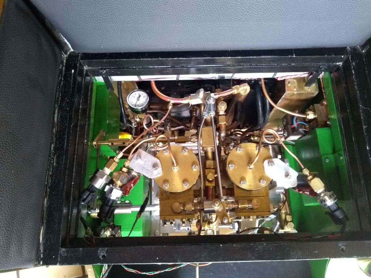

                      Werner Schleidt
                        @wernerschleidt45161
                        Thank you for your replies!
                        The video is very interesting and nice to see what people do with their possibillities.
                        Dave , this is a lot of information and I have to study this, many thanks for your work.
                        From the thread theme this is different this represents only the steam part.
                        Unfortunatly the winter is coming and so I have to make a pause till next year with my measurements to compare my continous optimizing of my steam car.
                        After making the measurements next year I will give an update of it. To have an idea a few informations from last year the measurement setup under the seat of the steam car
                        IMG_20240705_112122862
                        On the left side receiver pressure sensor, cylinder pressure sensor and the attachment to hold the piston travel sensor. On the right a cylinder pressure sensor and an attachment for the piston travel sensor.

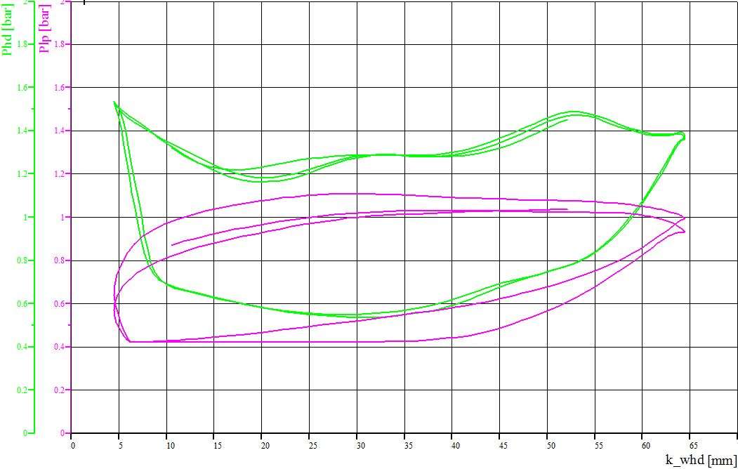

                        This was the outcome of the measurement.
                        Jaxon 5 Normal 3bar 3.5 kmh
                        In green the high pressure cylinder and in violet the low pressure cylinder with high pressure over the valve who combines both valve boxes for two cylinder driving. The green curve had some oszillations, later found by a loose stuffbox and a not good guiding of the valve rod. Caused by the valve there are some throtteling losses so the green and violet curves are not identical. The next exhaust pressure is not identical, because of different routing of the steam exhaust, one is direct the violet and the green have to go through a valve  for changing to two cylinder or to compound action. Combining the valve boxes in that way is a compromise for easy use and my space here is very limited, but in the beginning I never planned to do such a conversion to compound action.

                                          Looking at the interesting indicator diagrams, the first things I would observe are the pointy bits at the right, and the sloping first half of the exhaust line. These suggest that the exhaust is opening too late on both cylinders, and that the exhaust port or passage area is too small.

                                              Charles, thank you for your hint I keep in mind your finding and I make a check to the raw data. The shown data  have some smoothing that looks good, but is not always the truth. Next years measurement session I will see how the measurement looks like then. In between there is some run in now, I drove in two years 470 Km with steam. I made some refinements more subjective and I have no indicator measurements for that work. Therefore the measurement session next year. I have only for comparison data of many runs with an overall charateristic. I can see there speed, water level and steam pressure with a low data rate of 10 sample per channel.
