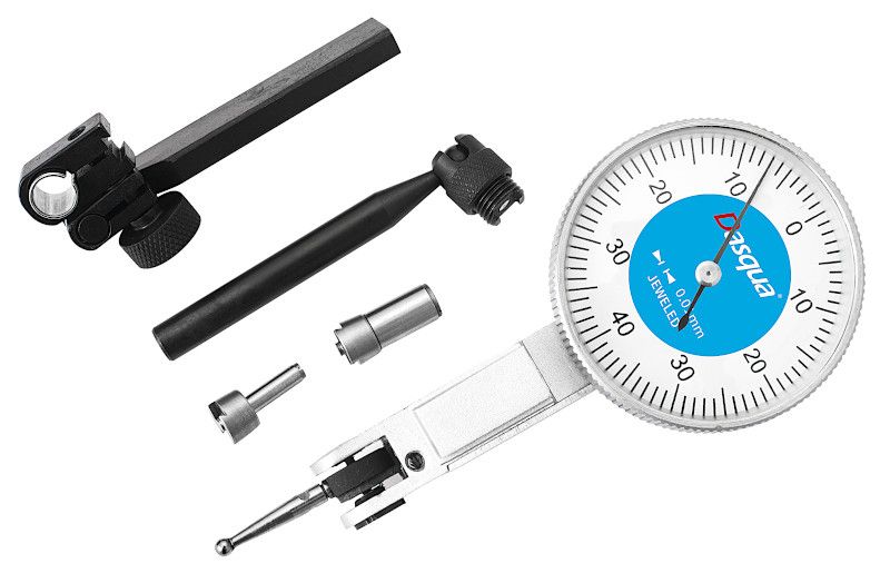

      Good morning,
      I have a Dasqua DTI which I assume would have a friction pivot/clutch. However, the lever stylus does not want to move (other than operational travel) and I don't want to force it. I've asked Chronos, but they don't know and can't get an answer from their supplier.
      Can any of you knowledgeable folk help please? It carries the number 5221-1001 if that helps.

          Is it this one?
          The image might help someone give a definitive answer but those (various other makes) that I have used all allow repositioning the probe.

              Yes John, that looks like the same one, except mine has a plain white face.

                Block that the probe is screwed into looks to be separate from the thin plate beside it.

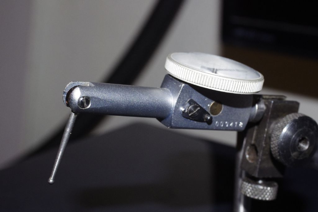

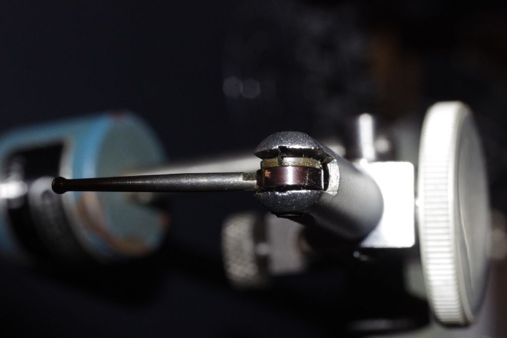

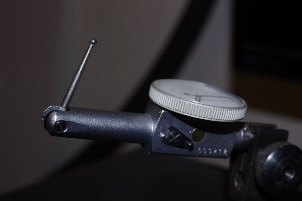

                        This type of dti can have its lever moved to any point depending how it is set up. Breakages occur when the lever is forced sideways. Some of my Miyutoyo lever types have a groove in the stylus close to the threaded end to ensure it will fracture before the pivot bearings are damaged. So far, I haven't put this feature to the test.
                        The picture of the Dasqua doesn't seem to show the usual friction pivot, some close up photo's would help.

                            I have a Dasqa DTI similar to the one in Journeymans picture and yes the lever does move but is is extremely stiff. It took a long time to pluck up enough courage to push it hard enough to get it to move.

                                      _igp2720.jpg_igp2719.jpgThats a good result. I have some pics of a Mitutoyo showing what they are capable of. (when I get them in the album, that is)
