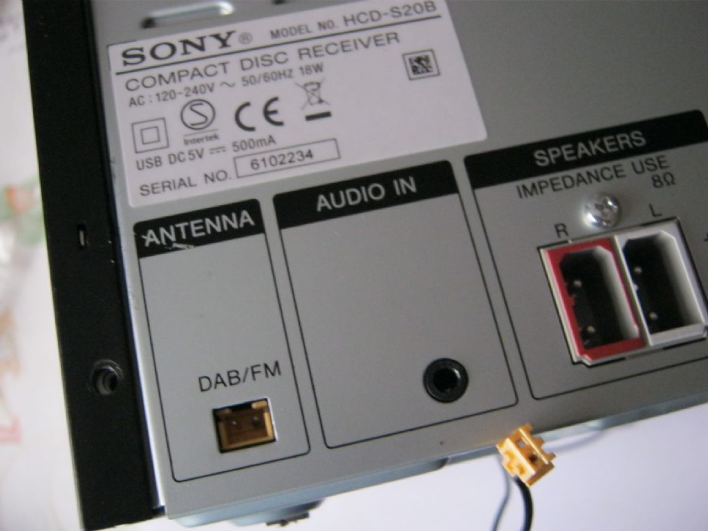

      Where I live, Boston, Lincolnshire, I find that in general TV and radio reception is not good which to my simple mind I consider strange given the flatness of the countryside. More particularly, I gave up on an FM radio I had in my workshop and bought a DAB outfit ( good make) after being persuaded of the virtues of DAB. Again generally not particularly good reception. I like to listen to LBC but this is about the worst channel for reception. The aerial for the radio is a piece of wire about 24 inches long and by continually tweaking it I can get a spasmodic reception. The simple answer is "don't listen to LBC" I suppose but I have wondered whether the workshop environment may be affecting the signal? Reception even varies depending on where I stand…..it's OK at the lathe but hopeless near the mill! Any ideas?

                Height generally helps. You might try a 12ft pole outside with a dipole on it that you can rotate to point towards your nearest transmitter. You'll need a coax cable down to your radio and a coax input.

                          I don't mind having a go at some of the suggestions made but the aerial input is such a weedy little thing that I don't think it will stand much messing about with. It is only about 1/4" wide. I seem to have managed to load a photo without traumatising myself and this shows the nature of the beast. I have taken the thing apart as far as I dare and found that the two small aerial terminals are attached to the circuit board. How would you fit a co-ax to this? 002.jpg

                                      I get reasonable reception on the workshop Roberts DAB radio. To do so though I have had to solder a six feet length of lighting flex to the tip of the telescopic ariel. Without the wire the reception just keeps breaking up. I only listen to Classic FM and this works for me. One exception to this though, at exactly 4.00 pm every afternoon the signal breaks down and I just get mushy burbles, clicks and such. The final click is me turning the thing off !

                                        oops. DIgi and FM Radio is vertical polarised unlike Tv so rotating the dipole doesn't help. A dipole will be a little better than a whip and would cost about £15, while a 3 element yagi might be £25. Now the yagi would be directional. The Transmitter is probably Belmont at grid ref TF985423 on 225.648 MHz block 12B (may be relevant to antenna choice).
                                        The antenna input is probably balanced but the black wire might be earthed so try not to earth any part of the coax/ antenna elsewhere. Also try both ways round to see if one is better. Then tentatively earth the outer and if it still is happy make it a good earth for lightning protection. If it is a LW radio too radio 4 will come in a lot better the wrong way round as the coax sheath acts as an antenna.
